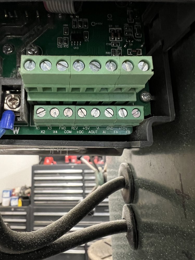

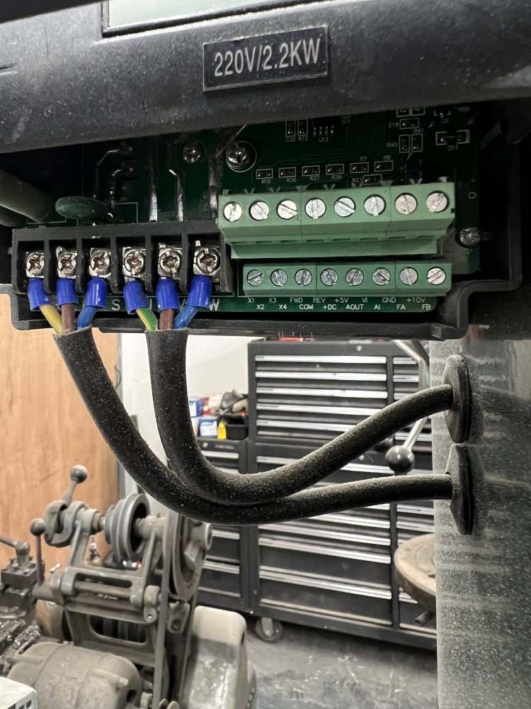

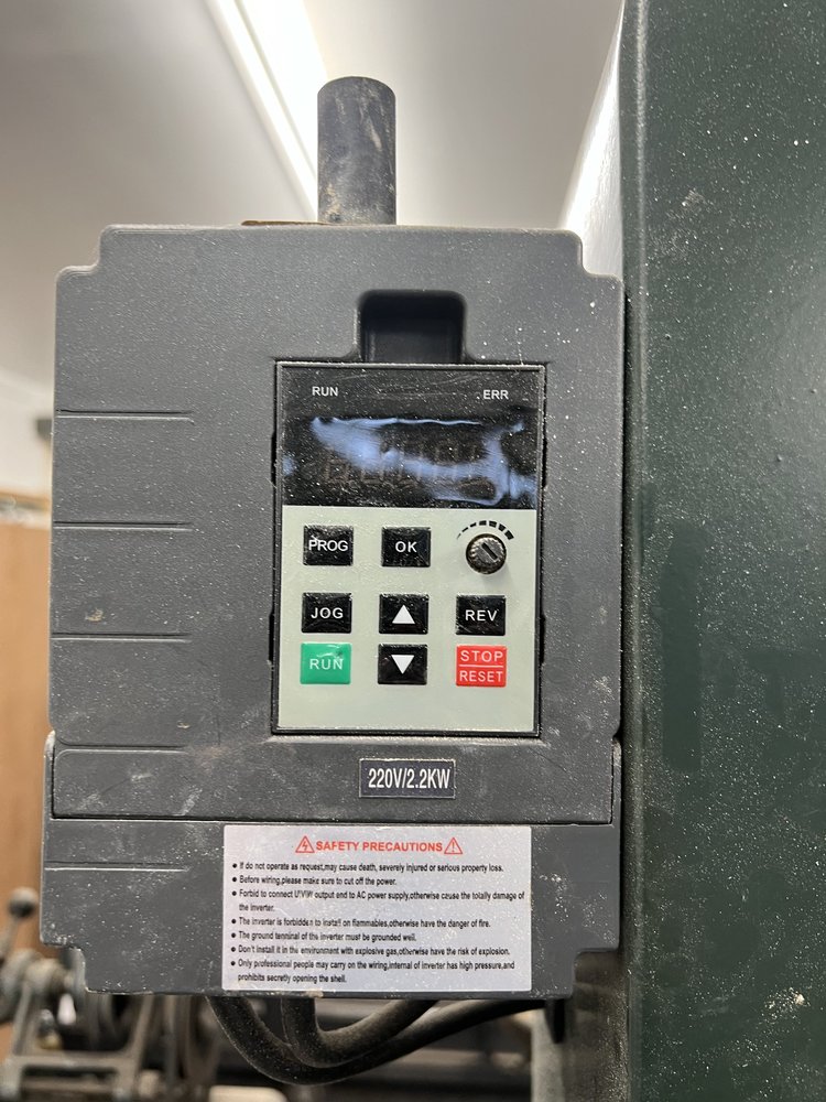

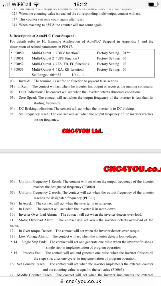

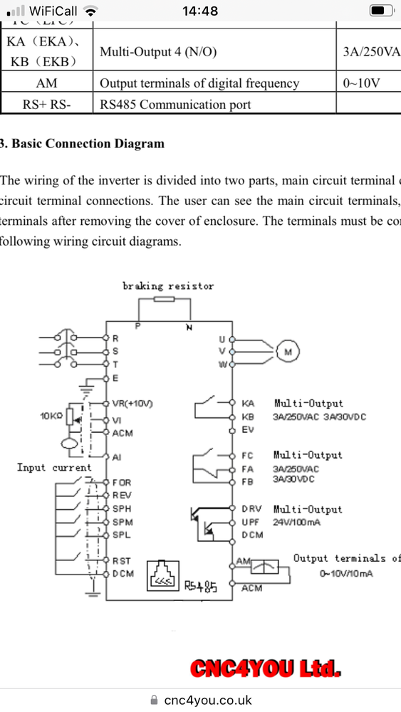

Got a 3 phase startrite bandsaw in the workshop for wood only cutting and use a VFD to i can run from single phase, wanting to run a vacuum so when i press start on the VFD to make the bandsaw run my vacuum will also come on at the same time. Is there a switched output on the VFD i can use to throw a contactor switch?
If this is not possible i will just go back to switching the vac on by hand.
Thanks for any info supplied.
