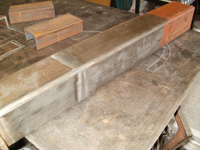

Had an hour to spare this morning, so thought I'd turn a few off cuts into something useful,

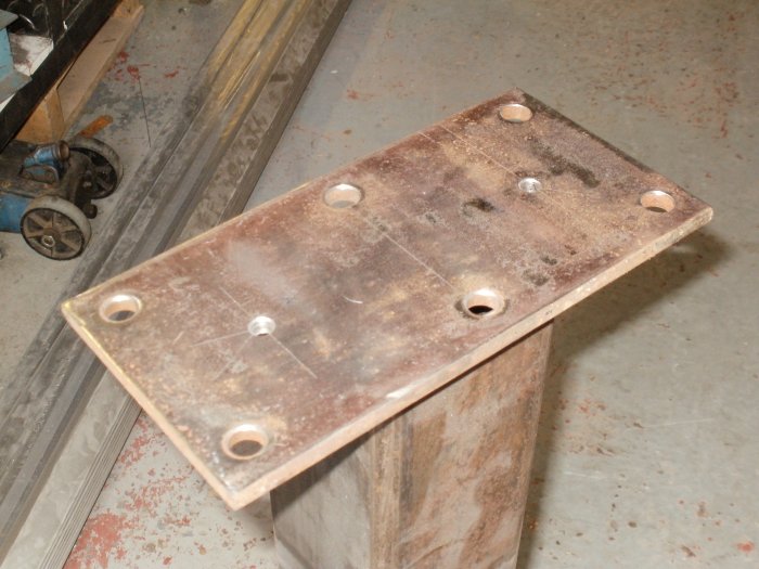

A bit of 8mm plate from something I dismantled,

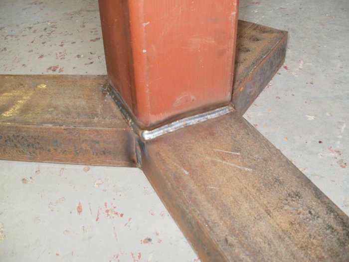

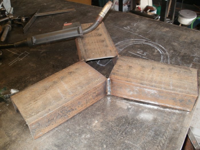

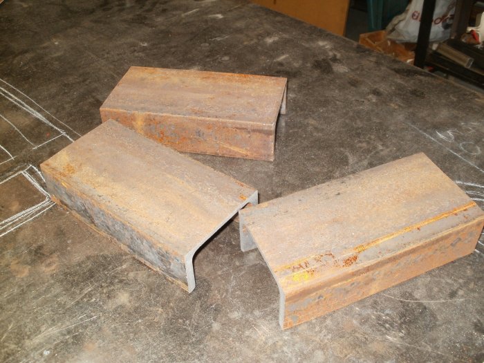

and some 4 x 2 channel
100 x 100 box section, this wasn't long enough so joined 2 pieces together and flushed off the weld
Use a few Mig sparks to knit it together.
guessed what it is yet?

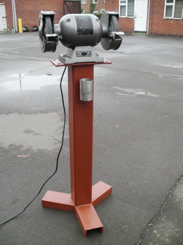

A splash of red oxide and Voila! a grinder pedestal. the quench pot is a bit of stainless tube with the end capped off.
Not exactly the most complicated thing to make but may give someone an idea for a simple project.
