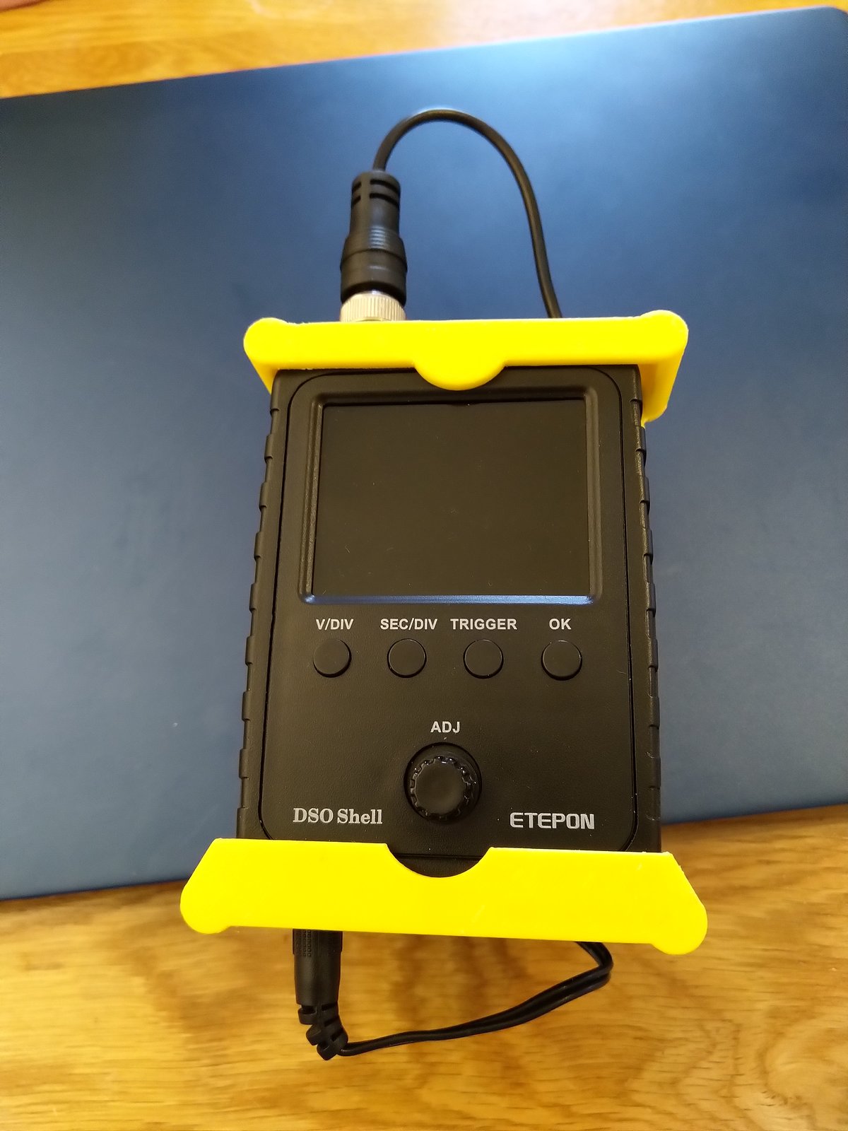

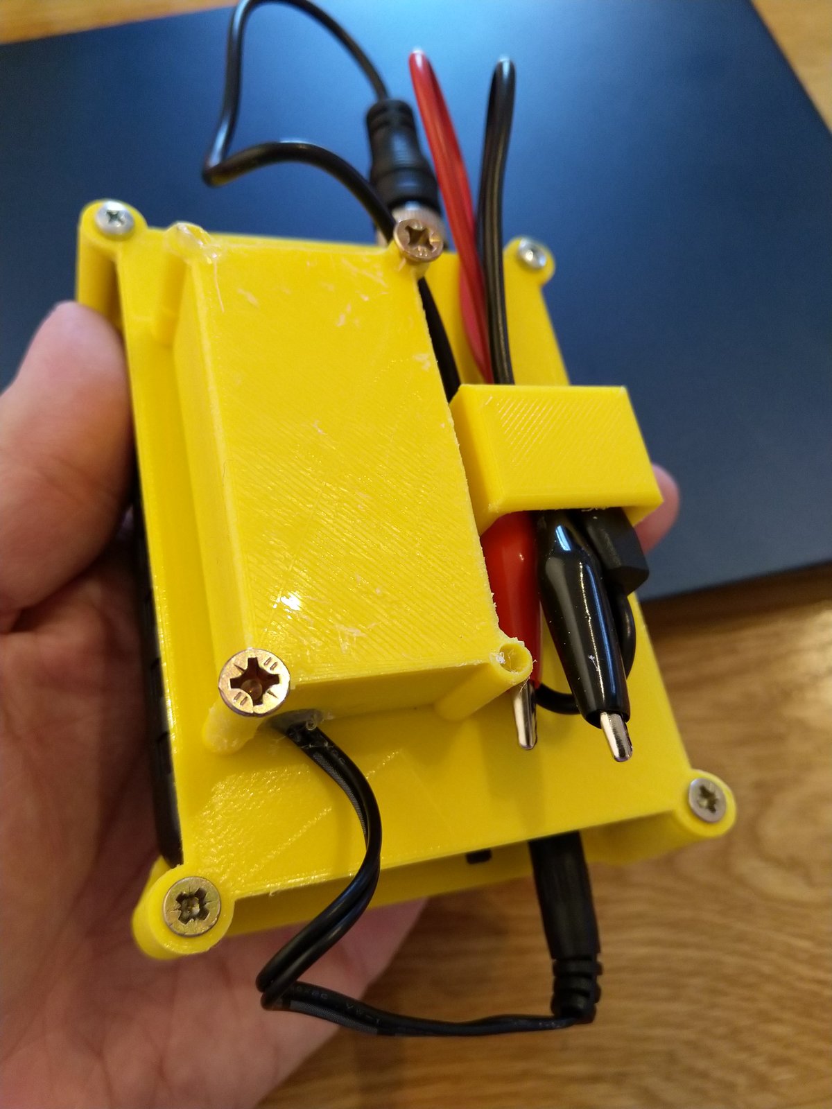

    The usb one I have is:H 6022BL PC USB Digital Storage Oscilloscope 2(Digital)+16(Logic) Channel https://www.amazon.co.uk/dp/B01M74UKKC/ref=cm_sw_r_cp_apap_lADAphBrBQMwR
    The hand held one is a dirt cheap jobbie: Digital Oscilloscope Kit, ETEPON Oscilloscope Kit + Case/Open Source 2.4 inch TFT LCD+ Shell + DIY Parts + Probe 15001K https://www.amazon.co.uk/dp/B07FPDY3DK/ref=cm_sw_r_cp_apap_bKYh7tJEmcoXg
    The hand held one does NOT come with power adapter, so I've modified mine to run off a rechargeable (over usb) 9v battery enclosed in a 3d printer case.
    123hotchef likes this.
  13. Henrik Member
    The cheapo one does not have massive sampling capacity, but for simple stuff it works brilliantly.

  15. Henrik Member
    Wightsparks, mtt.tr and 123hotchef like this.
