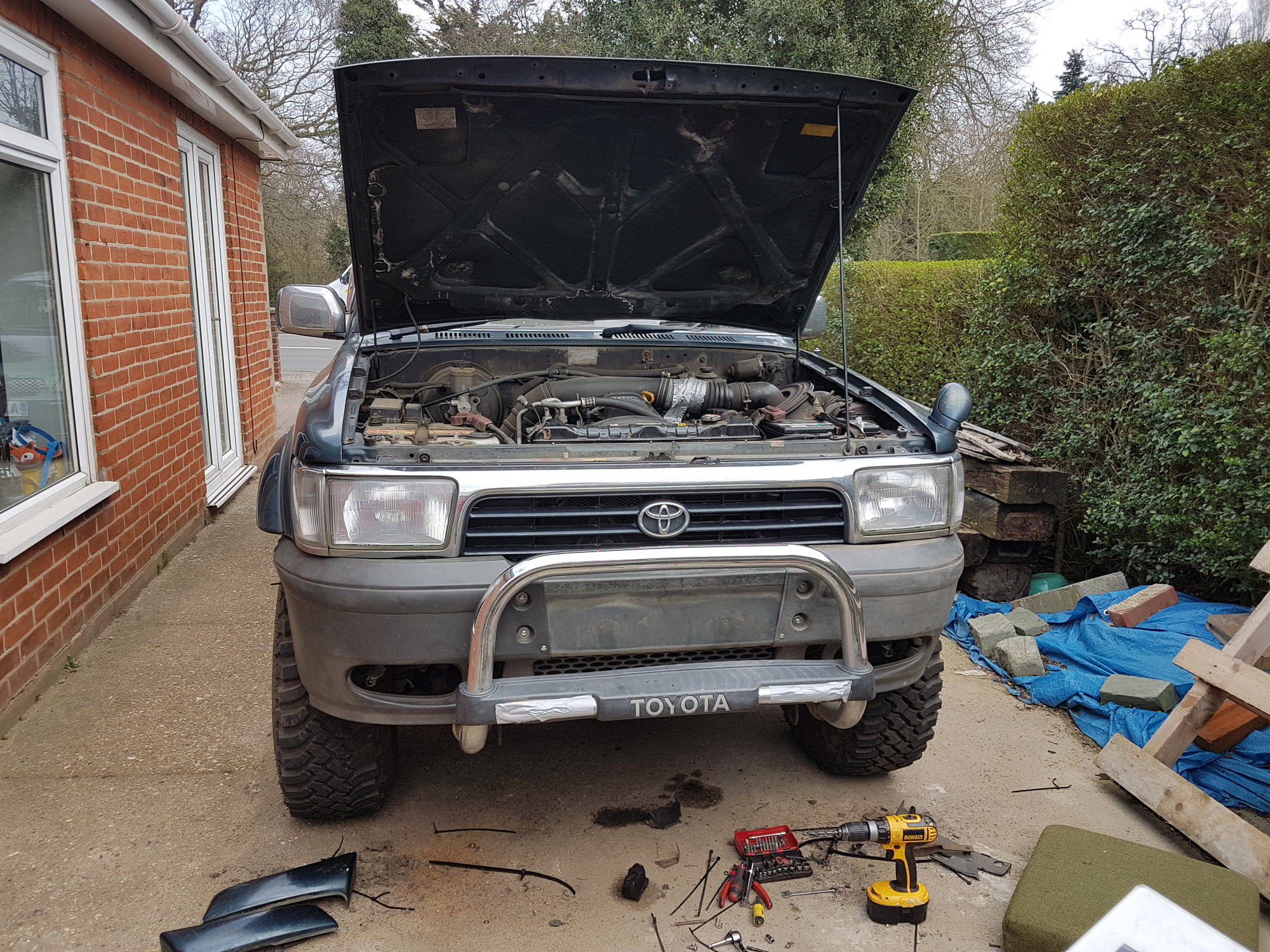

    Funny you should say that, there is a post on here from last month of me butchering a transit bumper to fit a Surf - total cost £5! 20190330_135403.jpg
