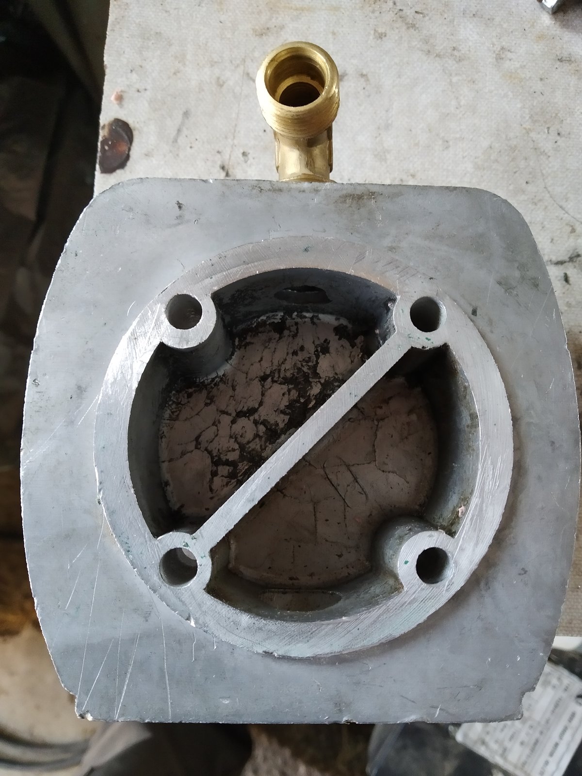

  14. Steve_G New Member
    Messages:
    8
    Location:
    ALsace, France
    Went to try the temp option which meant cleaning off the old gaskets.
    The reeds are held between 2 plates, and the gasket between them is metal. However between the top plate and the head is a fibre gasket (same shape). When I started to remove this, the part that separates the two chambers (thin) fell apart. Really just the jointing compound making it look good. So I think I have found the problem :thumbup:
    Thanks to all for the help in going through the options :clapping:
    I'll post back when I reassemble and hope fully fix it!

  15. Steve_G New Member
    Messages:
    8
    Location:
    ALsace, France
    Took a while to get the new bits under the current circumstances, but all assembled and I have a compressor again!
    The picture is of the underside of the cylinder head, and you can see the wall that separates the 2 chambers; not very wide so really a weak point waiting to fail.
    cheers
    Wallace likes this.
  16. 8ob
    8ob Forum Supporter
    Messages:
    4,891
    Location:
    moscow on thames
    Not really a weak point Steve, mine blew a gasket and when I took the head off I noticed the headbolts were loose. I replaced the gasket and checked the bolts after a few hours to find they needed retightening. We tend to ignore compressors until they stop, worth checking on occasion.
    Bob
    Hopefuldave and Wallace like this.

  18. Steve_G New Member
    Messages:
    8
    Location:
    ALsace, France
    Not arguing with the idea of checking the bolt torque, but a long straight wall with a high pressure difference needs care and is a more likely point to fail. Ok, this time it lasted quite a few years (under lightish use) but making it a bit wider, maybe the same as the outside joining surface, would seem more sensible. But it is like it is.
