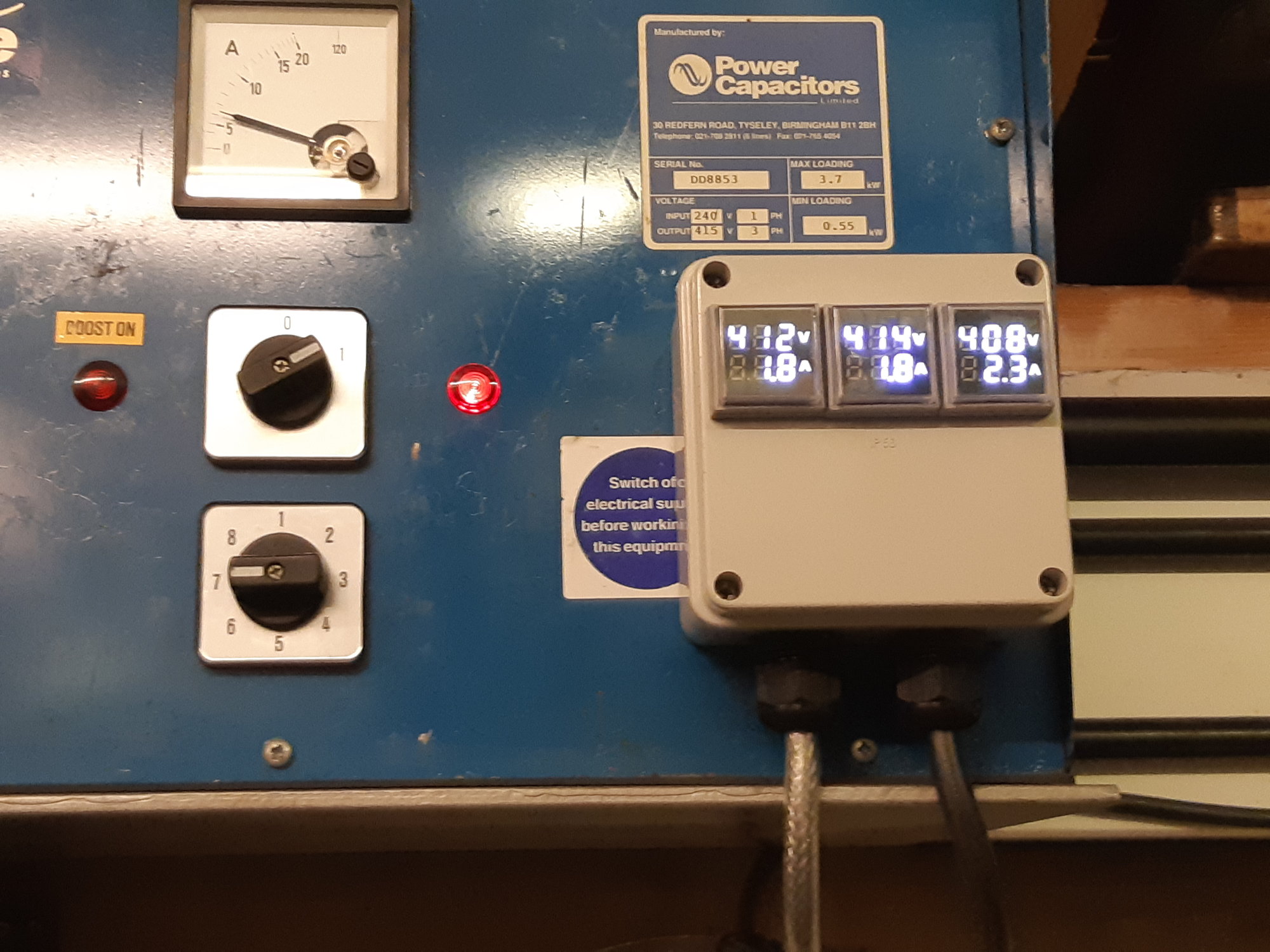

Hi folks,
I've a big 12.5hp static and a 7.5hp old 3phase motor I want to combine to make a rotary. Anyone help me to do this. I understand the basics, but seem to be able to find only US information on converters.

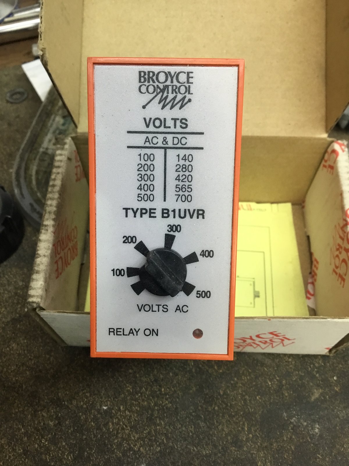

I think I need to add a start capacitor to save me starting the slave motor with the switches on the front, and a voltage sensing relay to kick this out when the motor is producing the 3rd phase. Do I need anything else?
