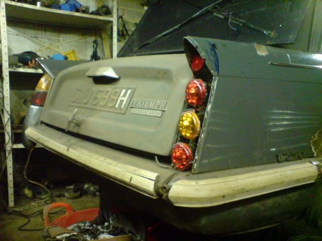

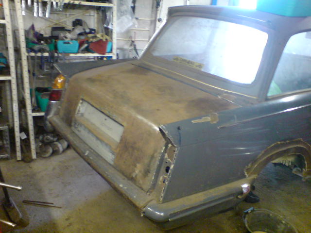

    I decided many years ago that I need to update the styling of the car, which other people may hate, but its my car and what I want to do, so here is my thinking.
    at the back end, Im going for a smoothed boot lid with a frenched numberplate recess, internal hinges and electric opening.
    which required making a new framework for the boot lid
    with some round lights recessed into the wings (which will need to be widened slightly)
    I'll be ditching the over riders, and making one-piece vitesse bumpers front and rear, which will be made from sections of vitesse bumpers, I had a play trying to do this using DC tig and MIG, bit it was a failure, but thanks to @doubleboost I bought an R-Tech AC/DC tig to do this one job.

    I'll be making a new bonnet, but Im thinking of having the wheel arches built into the engine bay valances like an austin healey sprite, as Im hoping it'll be possible to make a bonnet that way that is more rot resistant than a standard one.
    [​IMG]
    and here's mine while modifying a new front panel
    [​IMG]
    and the front panel ended up like this, with a recessed grill
    [​IMG]
    so thats my thinking of the styling.

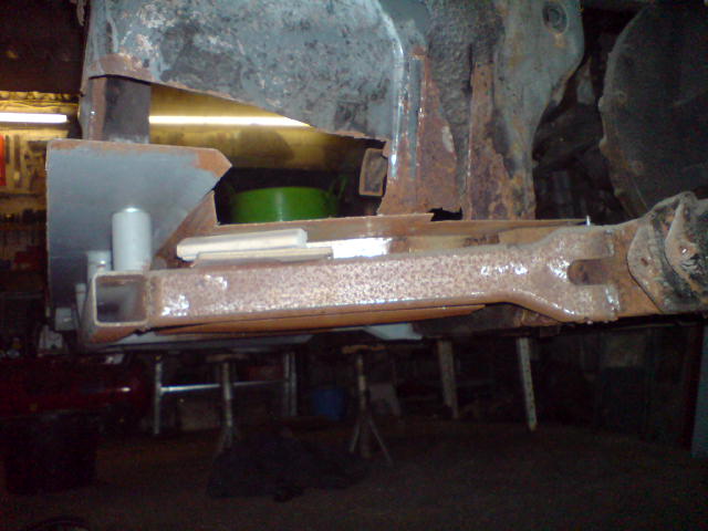

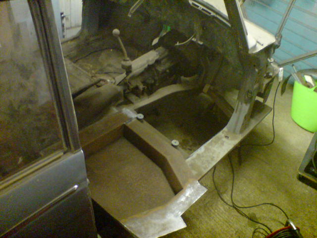

    I did replace the outriggers and side rail on one side of the car with 50mm box section, and I'll be doing that again, as there are a few details that I'm not happy with now, and heres how I did it, and think I'll do this again, as it'll be more rot resistant and stronger than the standard U channel made from thin metal, there is a small increase in weight but I think its worth it. ( a standard outrigger weights 1.15kg and one from box section weighs 1.55kg)
    the main bodyshell is made in 3 sections (excluding the bonnet) that bolt together, they are the rear tub and bulkead (they join under the drivers seat) and the roof. Im going to be making a one piece bodyshell as the three layers of metal that bolt together at the join between the rear tub, bulkead and middle outrigger ae designed to rot. I did replace the floor of one side of the car, but I'll be remaking that
    so my first job is to weld the floor up and fill the holes up that Ive made, I think MOT standard welding (plating rather tha butt welding) will be good enough for this, so this part of the floor panel is the first to go in
    once the shell is in one piece, I'll support it in chassis stands (set A), then unbolt the chassis and remove the set of chassis stands that hold the chassis up (set B), I then need to use set B chassis stands to support the shell on some 50mm square box section that is wider than the chassis. I'll then need to remove set A chassis stands from under the shell, and then pull the chassis from under the bodyshell.

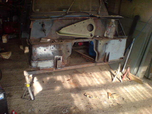

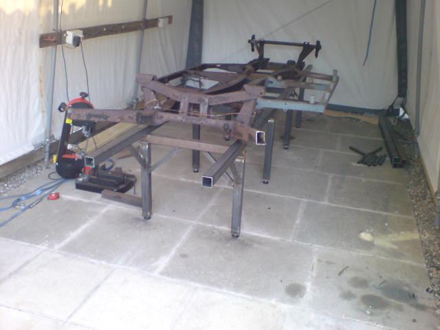

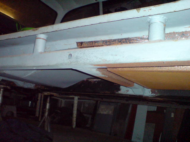

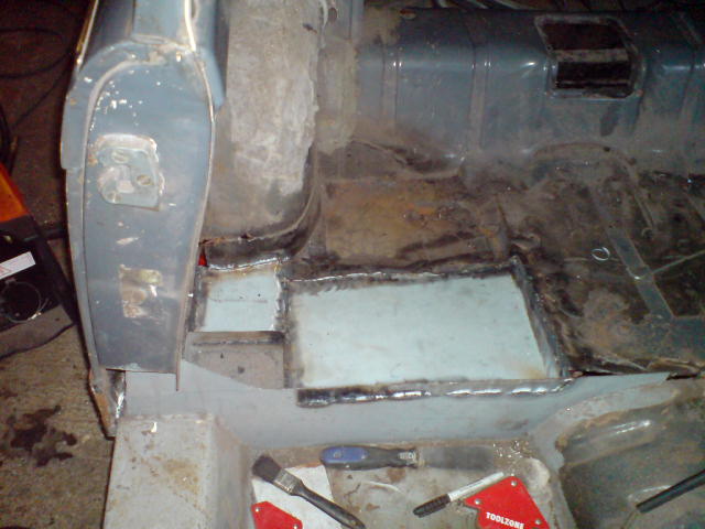

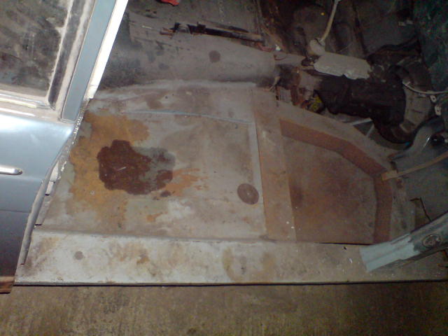

    the floor of the car has now had the big holes welded up so that the shell should have enough strength to support itself with out a chassis. the footwell in the photo has been welded in, together with the bulkhead and under the passenger seat.
    I've also made a frame for supporting the chassis on so that it can be rebuilt in this thread
    https://www.mig-welding.co.uk/forum/threads/chassis-support-frame.90766/

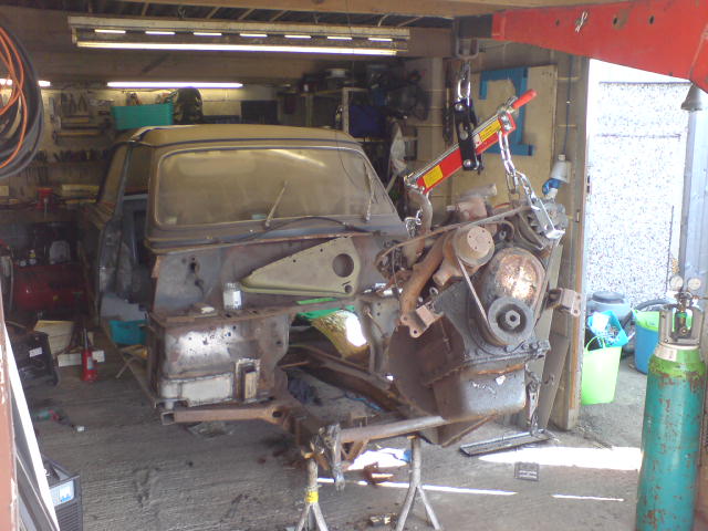

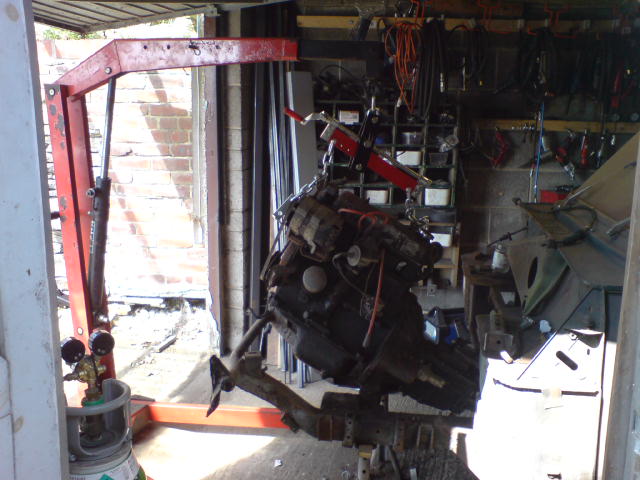

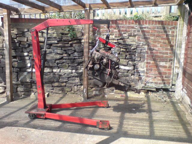

    and 20 years ago I decide that I needed to remove the engine from my car, and yesterday I've finally done it.......just goes to prove a bloke will get round to doing things by himself without a woman nagging him, just give us time to get things done and we will do them.......
    .....eventually :laughing::laughing:
    thats the real reason why I stopped working on the car all that time ago is because I couldnt do the bulkhead with the engine in place, and at the time didnt have an engine crane to remove it. I think the engine crane was one of my first ebay purchases and I've been a member on there since 2001. the engine wasn't even fastened in place it was just supported on a wooden block.
    hopefully my engine rebuild will go as smoothly as this one (when I get round to it)

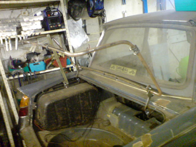

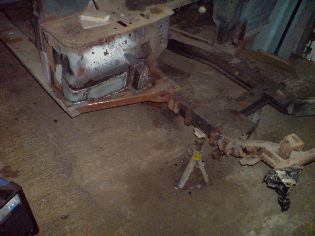

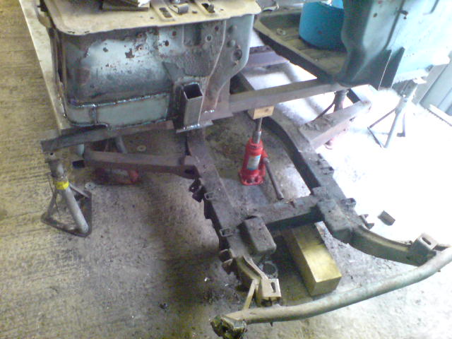

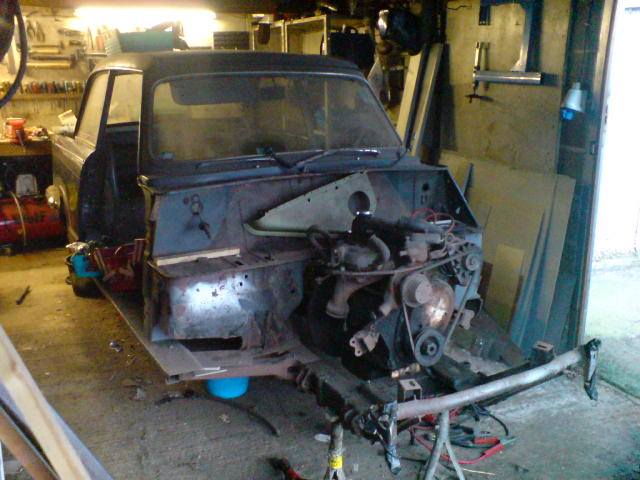

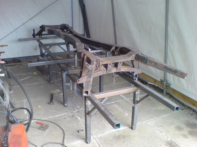

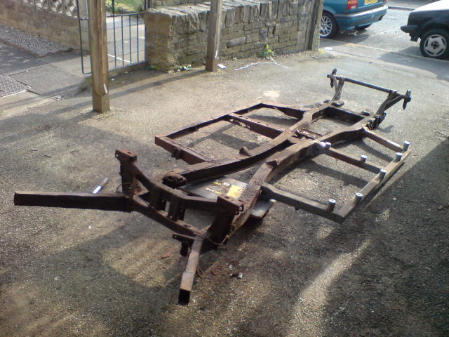

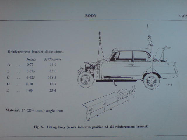

    time for another update, and today the chassis was removed from the shell. normally to remove a chassis the roof is removed first and then the bulkhead and rear body tub, but the works manual does show that the bodyshell can be removed assembled by bolting some reinforcing sections between the bulkhead and rear body tub. I just welded them together and it seemed to work.
    so first I made some wooden bases for my chassis stands and bottle jack (Im not a fan of trolley jacks as the arc of the arm tries to pull cars off chassis stands at higher lifts.
    the car has been on 4 chassis stands for the last 20 years between the crossmembers at the front and back of the car
    so then the foot wells near the A posts were also supported on chassis stands,and the chassis stands under the chassis were removed and the chassis lowered
    a 50mm box section was then jacked up under the floorpan and its slightly longer than the width of the car, and another set of chassis stands were put under this length of box section
    the original chassis stands under the floorpan were removed and the chassis was then rolled out.
    and the chassis was then put on the frame I built during last week

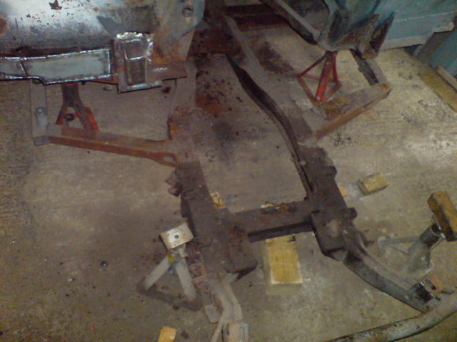

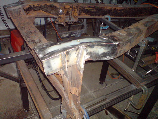

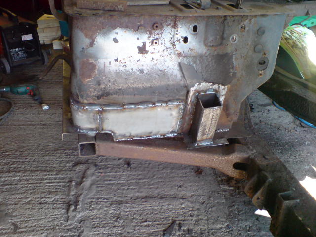

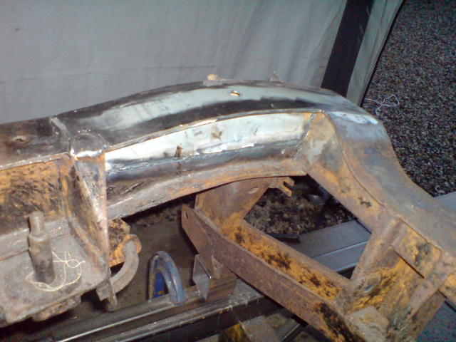

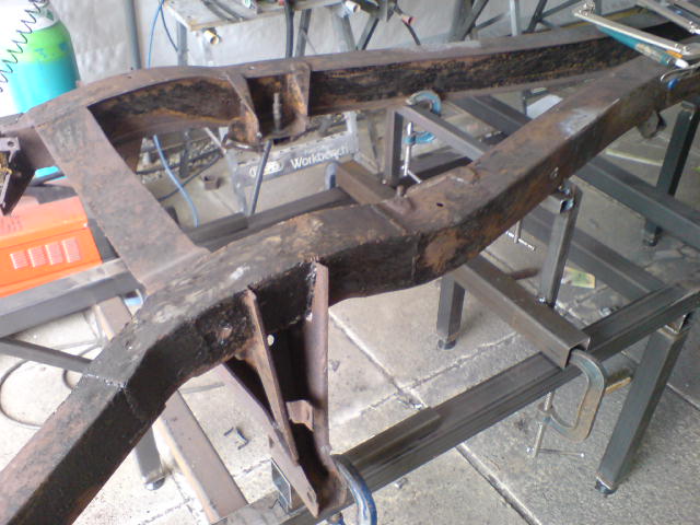

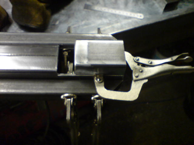

    well it doesnt reall look like much has happened but Im working on the chassis and first the outriggers were removed including the original ones on the passenger side and my original set made from 50mm box section on the drivers side.
    but first here is my old centre outrigger, a new centre outrigger and a one made from 50mm box section. its scary that the one with holes in it actually had an mot and the underseal was holding it together
    and the outriggers weer replaced without removing the ends of the old ones, they were just plated over
    so once the mounting areas on the chassis were cleaned up it was looking alot better.

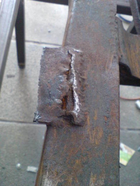

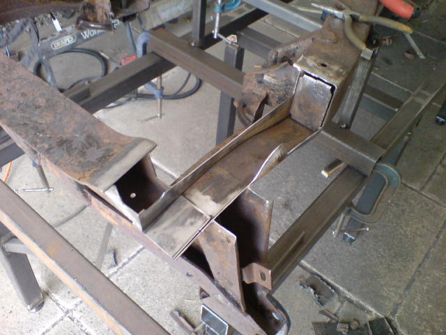

    the area arround the differential are known to rot on these cars and had been plated in several areas previously (and not very well) and there were holes in the main rail again

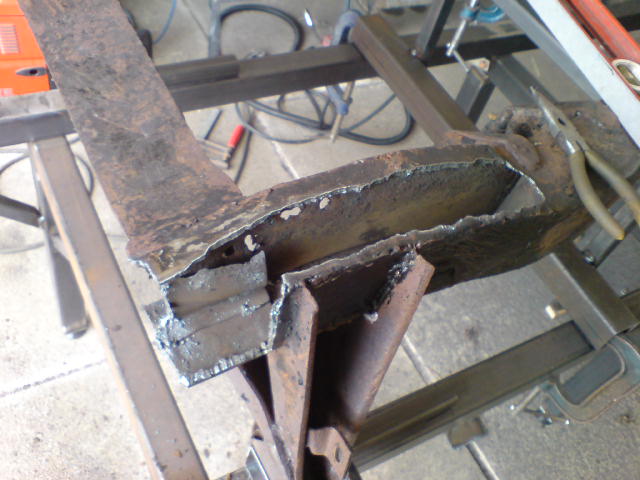

    and a brace was made to support the chassis while I cut out the rot (and plating)
    the using a plasma cutter I cut small sections at a time out to see what the construction inside the chassis rails was like. I've got to say I was impressed with the pilot arc cut50, even running from a 13a plug it had enough power to do the cutting.
    and tidied up ready for new metal to be let in
    lets see what fun its going to makiung and welding in some new sections

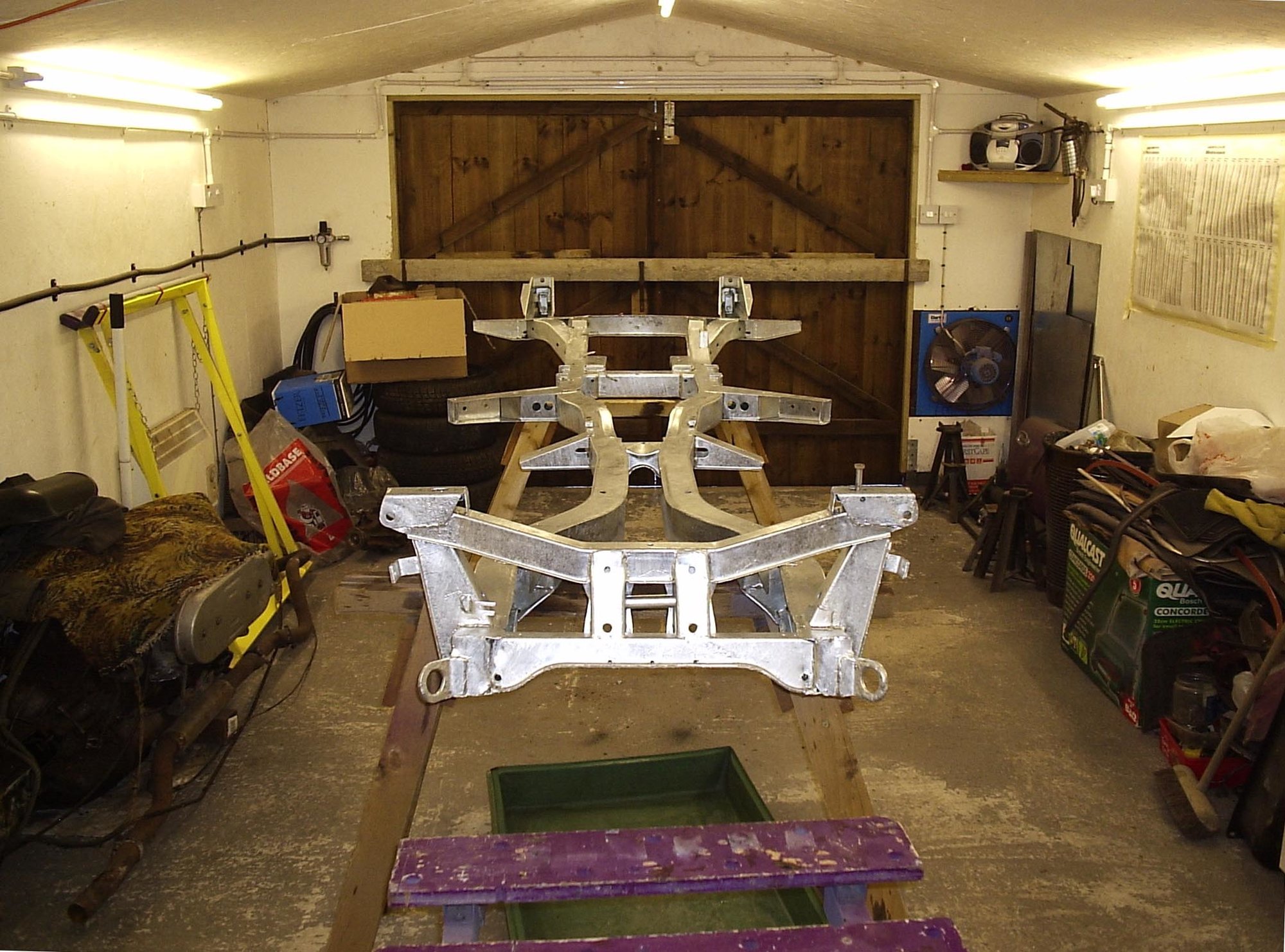

    I hope this isn't too far removed from what your doing, but this is a pic of my GT6 chassis after I got it back from being galvanised.
    I was quite fortunate that it only needed minor repairs and was otherwise in very good condition.
    I would recommend you do the same, galvanise that is.

    I think most of the metal on the car will be replaced, its designed to rot, and has. the main rails and bits that connect them are a little bit more complex in shape than just using a box folder, but the outriggers and side rails are just made by them.
    very nice, the galvanizing is a good idea, but Im thinking that I'll just go with epoxy primer on the outside and cavity wax on the inside.

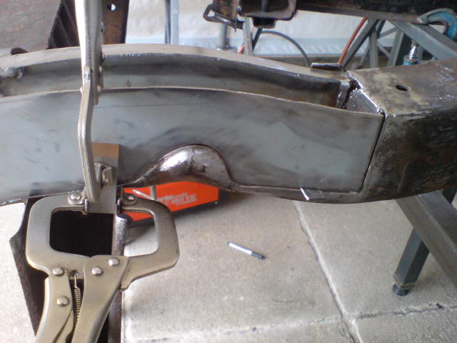

    I've finished repairing the back of the chassis, with making sections to let in, but leaving a decent gap to get some penetration of the welds
    and the finished repair
    and luckily the rear end of the other main rail was in much better condition.

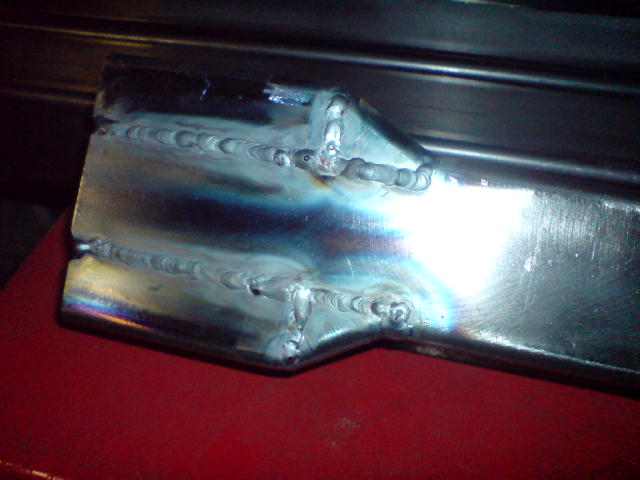

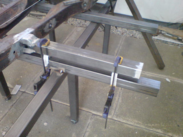

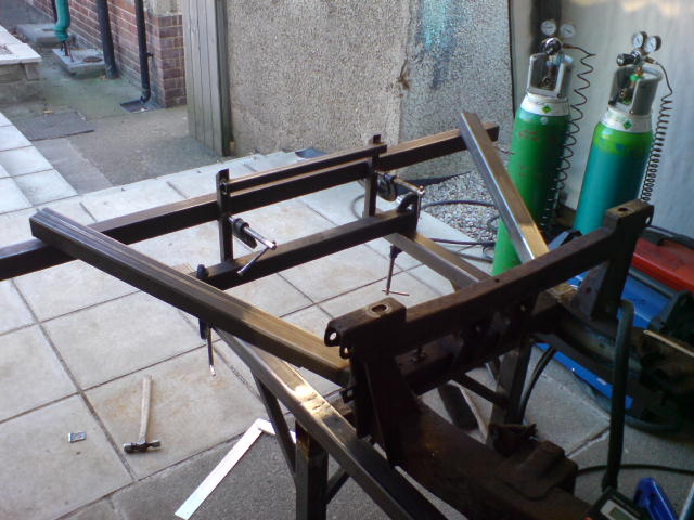

    time for another update, Ive been working on the outriggers, I want to run the side rails slightly lower than standard so that there is clearance between the middle outrigger and the floorpan, as the three layers of metal there are just designed to rot. the side rails and outriggers are made from 50mm box sections and the end of the outriggers next to the chassis needs to be increased to 80mm in height, so some offucts of boxe sections were welded to the ends. its amazing how much the sides of the box section bend when it is cut and the internal stresses are released, so a few clamps were required to hold it in place
    and tig welded up, sorry its not to the standard of some of you guys on here
    then the rear outriggers were welded in place, while being supported at the ends to be in the correct position. It seems to be taking me forever to check and adjust the postion of things until Im happy that they are where I think they should be.
    and the middle outriggers, as they are in line with one another I thought I'd do these before the other ones that connect to the side rail as their alignment is easy to work out, you can just clamp them to a peice of box section (tacked in place to the support frame) in the right place using large nuts and penny washers as spacers.

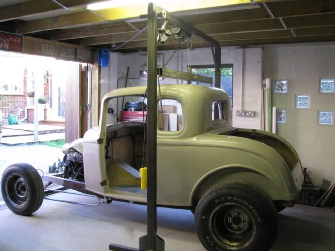

    Very interesting thread. Glad to see I’m not the only one with long term projects. :whistle: My T Bucket was going to be a quick finish build then on the road....18 months ago...
    One useful thing I built years ago was a body lift. First one was some used 2x3 box section that fitted inside the profile of the walls and roof of the little shed I was in at the time, with a chain block at the apex. It was so useful for taking the body off, as the body had to live in a lock up in the next street.
    When we moved house, and I built a bigger garage, I built a new lifting frame, movable, on castor wheels, with an electric inch. So useful when you are a Billy no mates and need to do numerous body fitments. :thumbup:
    I still have it, it’s been to thenPhilippines with use, earned its keep over there, then came back and is in my old garage once again.
