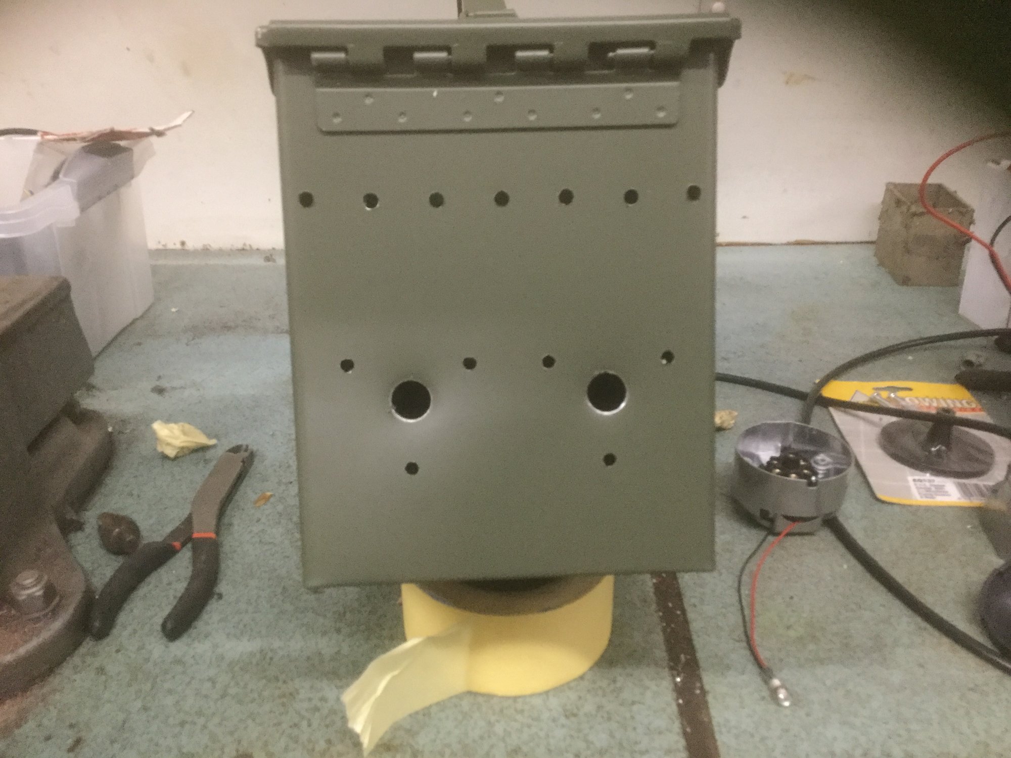

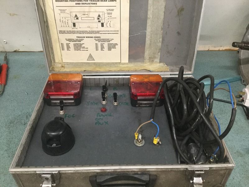

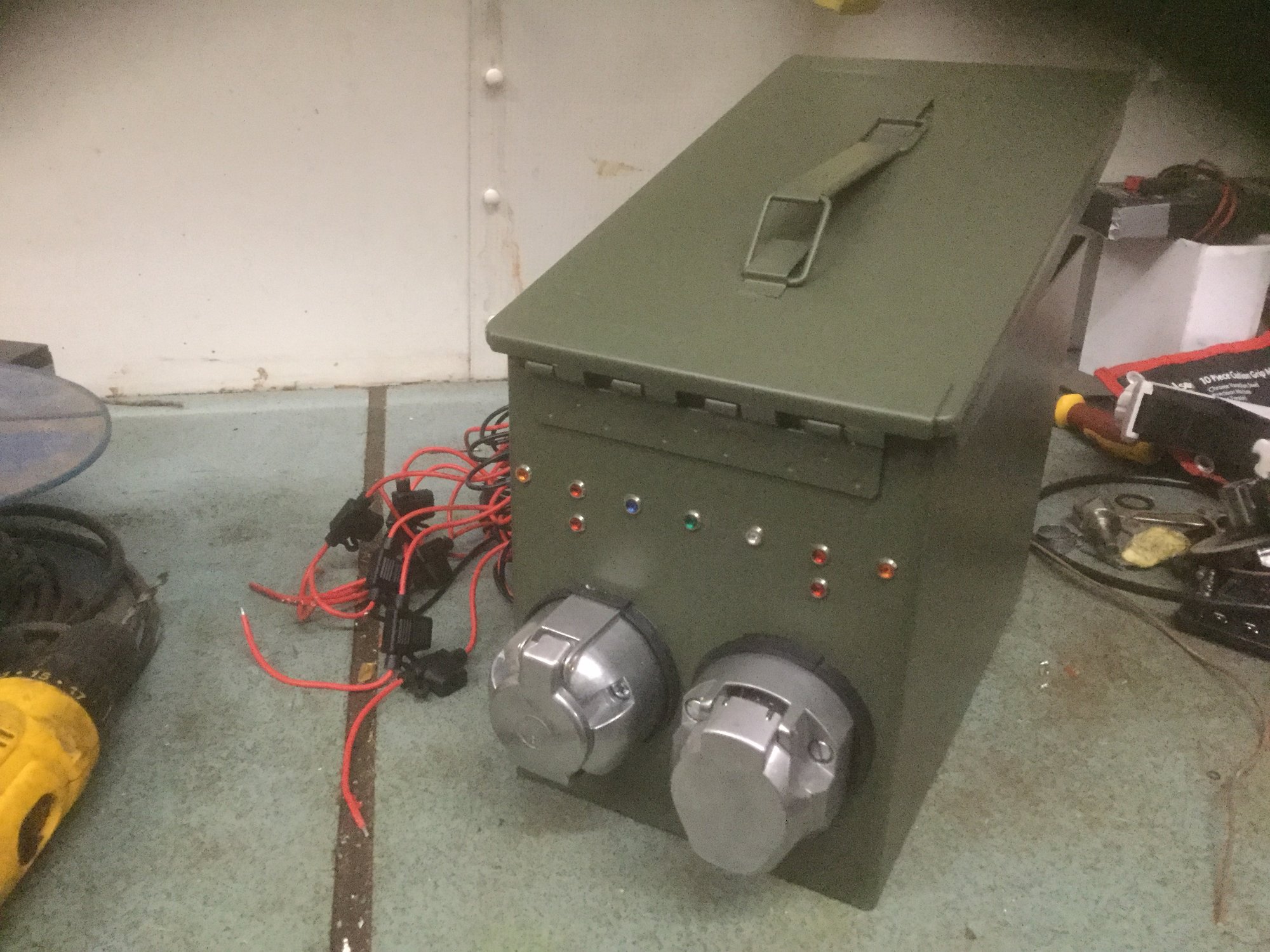

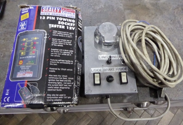

Mk1 is/was a box of tricks I knocked up many years ago to help in wiring/diagnosing trailer/trailer board electrics without the need for a vehicle to plug into.It could also be used to check the tow bar electrics. Downside is it needed a battery to plug into, it wasn’t water proof and the thirteen pin plug has since emerged.
The plan

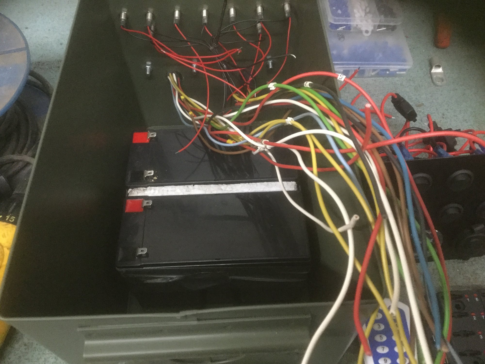

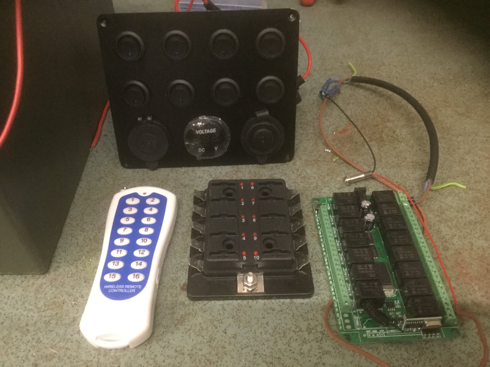

Condense the whole lot including a battery pack,charger, remote fob, override switches ,led check lamps, both 7//13 pin trailer sockets and include the aux feeds.

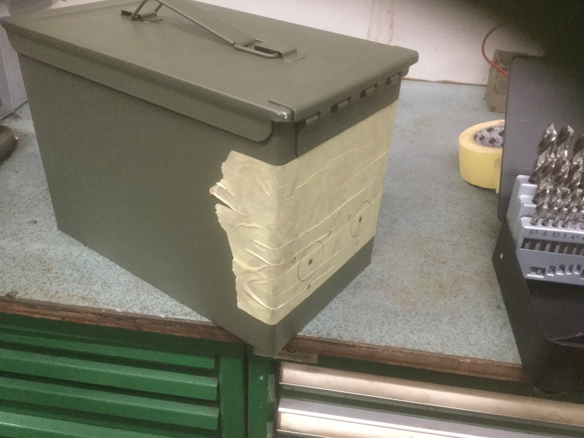

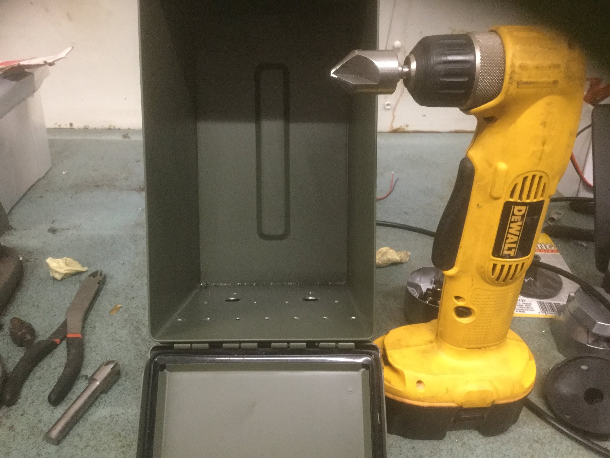

Tried a 50 cal ammo box but it was all a bit too tight so went for the fat cal ammo box with a rubber seal on the lid.
Work in progress, got the nine/thirteen pin plugs wired up and bolted in, fitted the check leds for the trailer lamps, need to find a place for the aux warning lamps.
