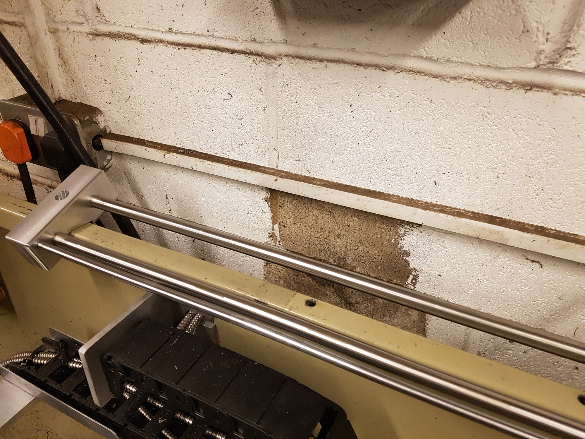

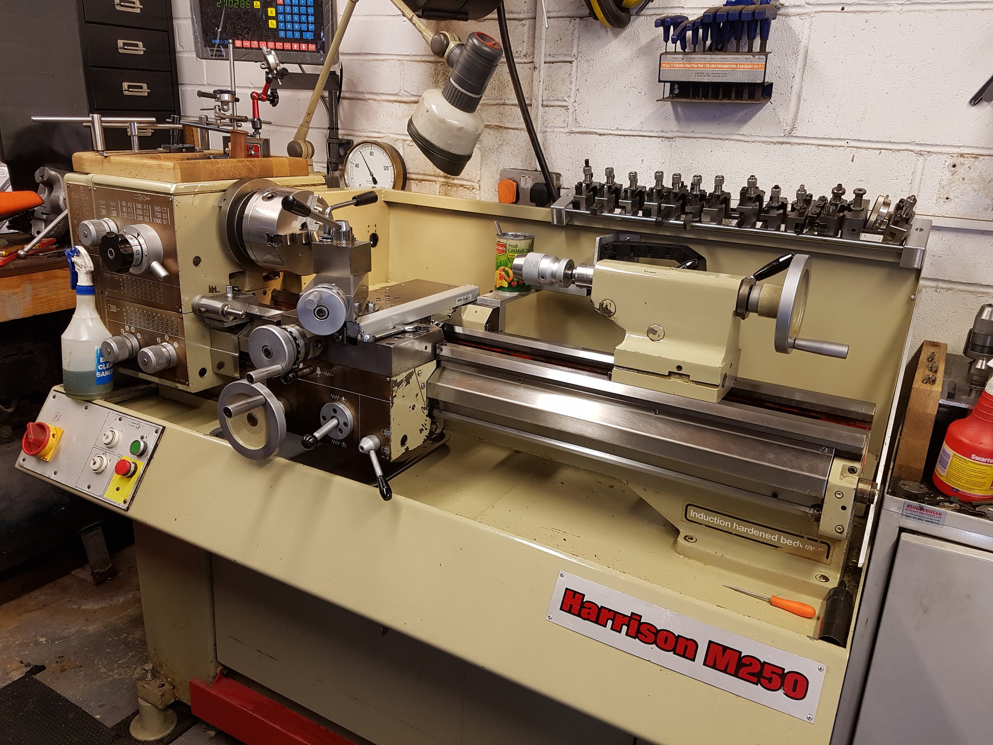

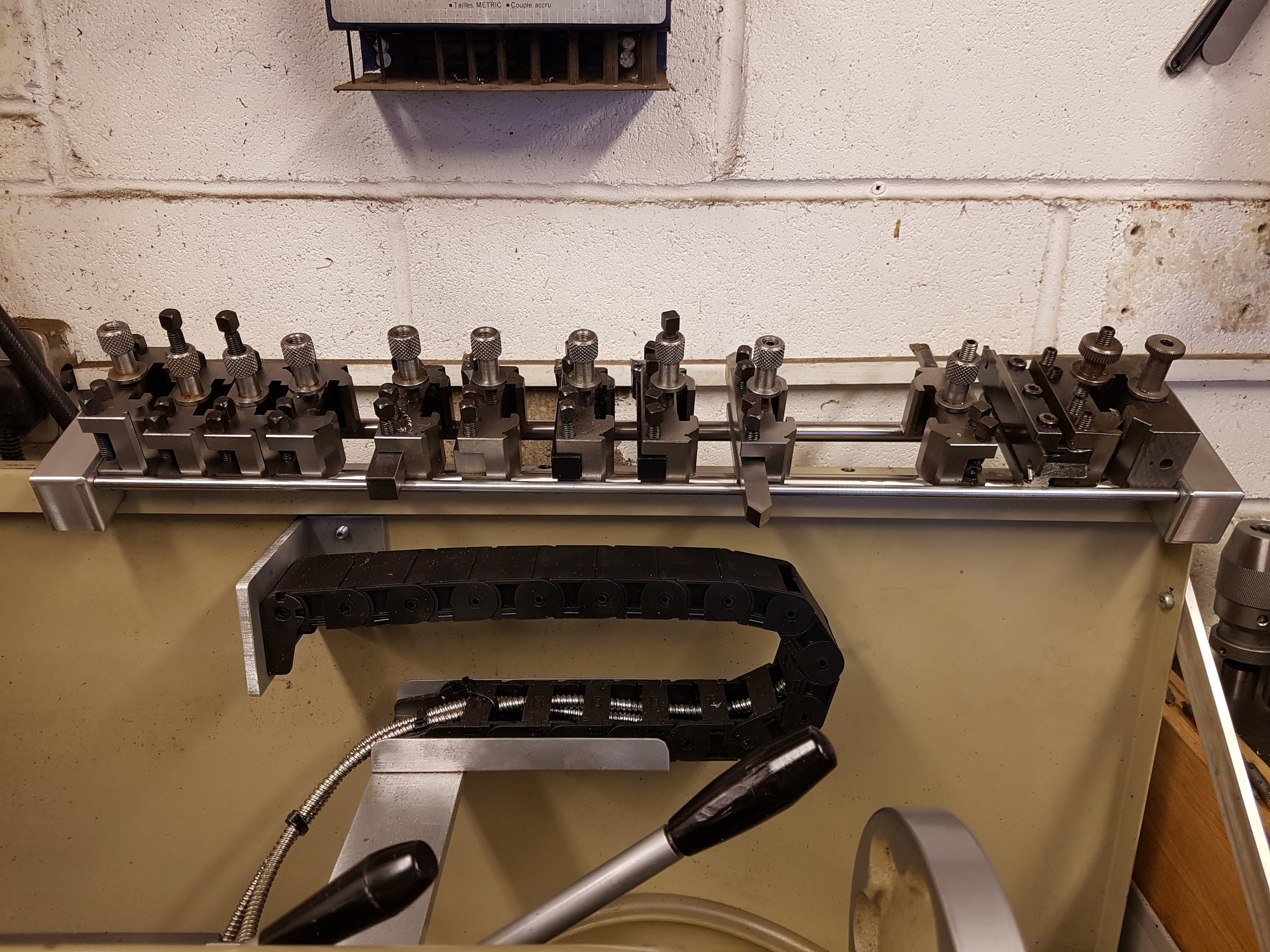

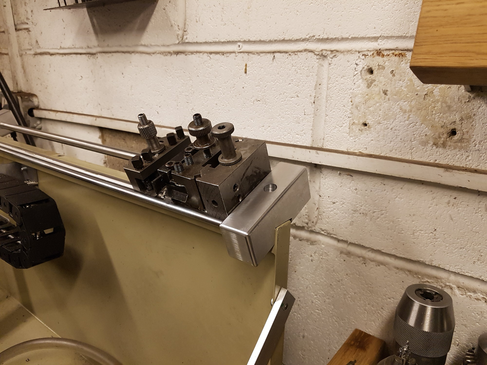

A while back i made a rack to that fixed to the splash guard at the back of the lathe but i've out grown it so i needed a longer one. The first one was just some folded ali plate and the problem with it was chips would settle on it and get under the tool holders and i was forever cleaning it. i needed a rack which is open at the bottom so this is what i came up with. basically its two aluminium blocks and three parallel stainless bars works quite well. i thought i'd share it as it may give someone a good idea
