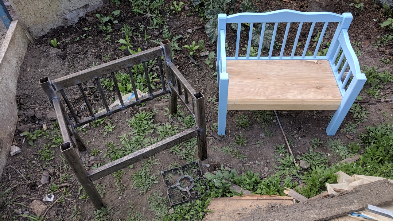

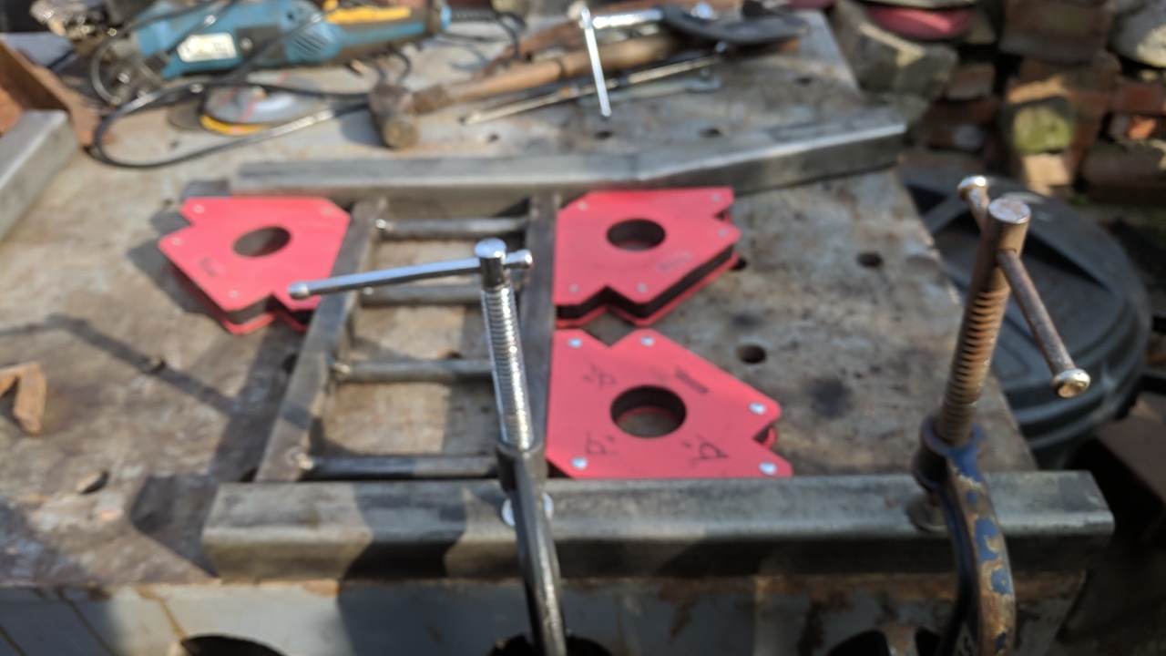

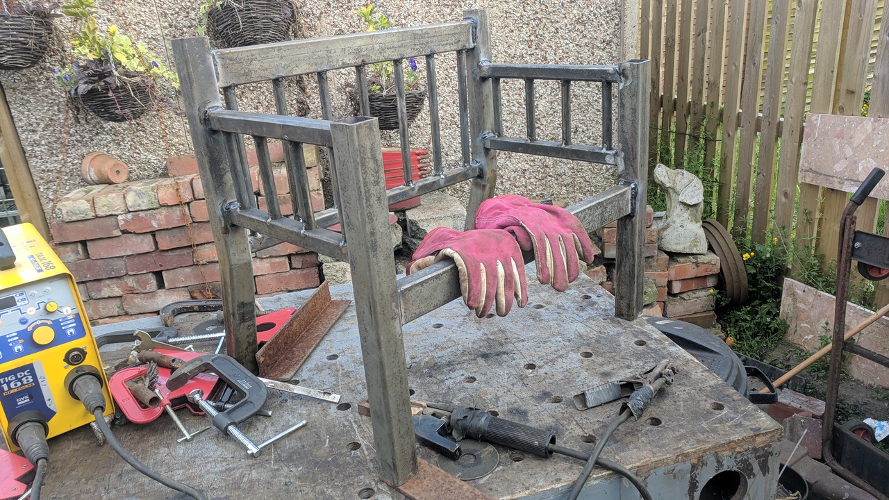

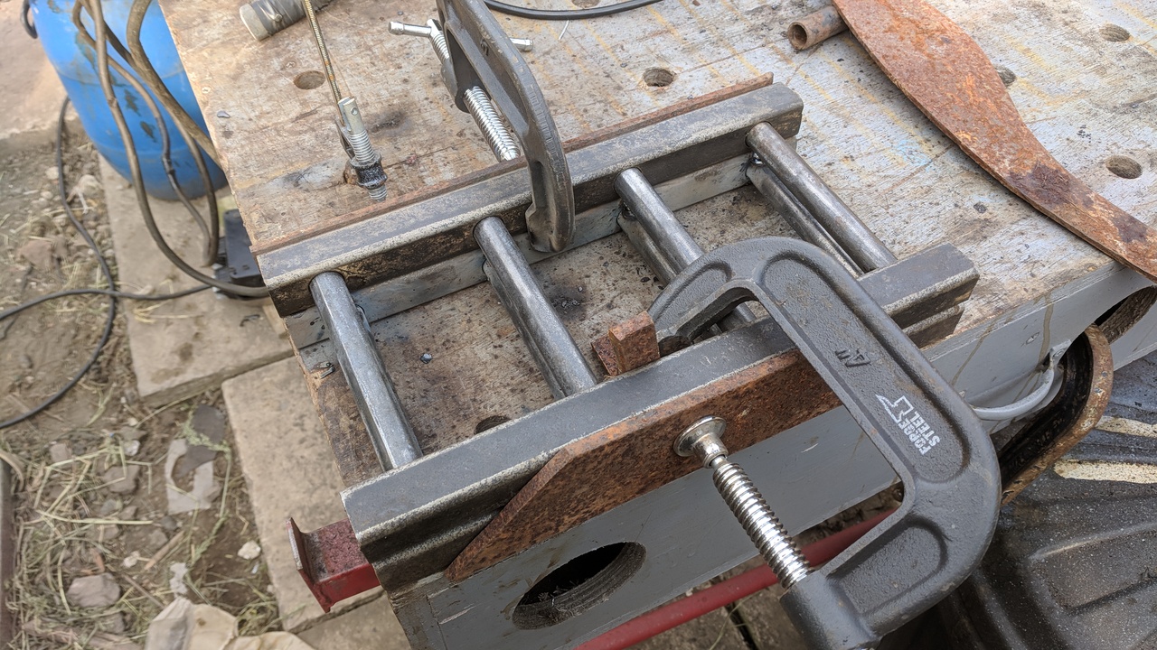

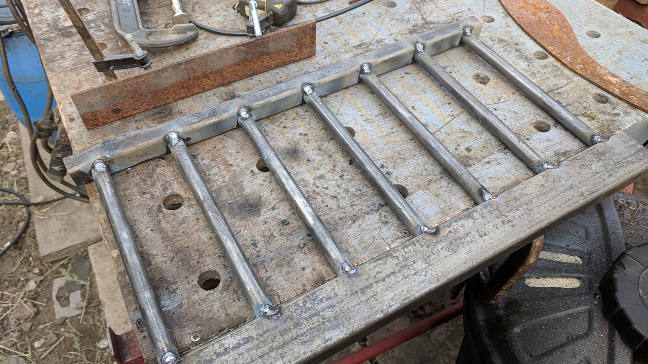

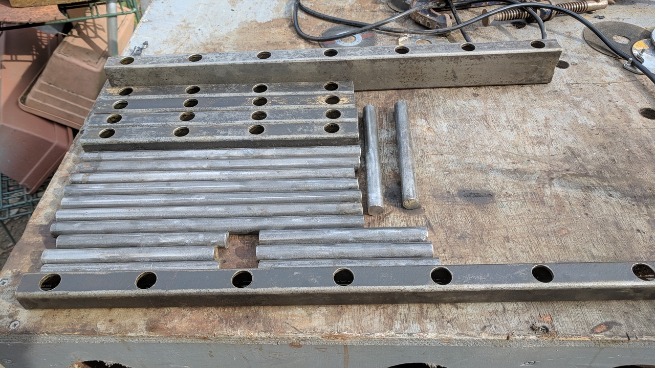

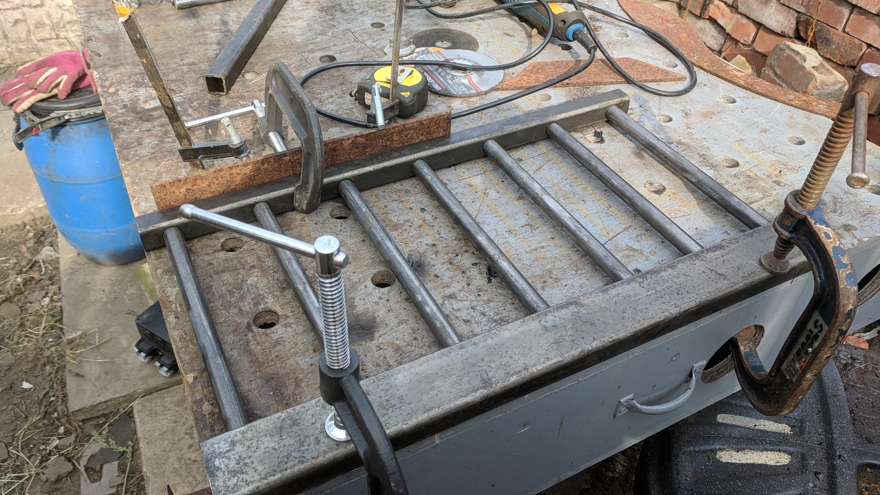

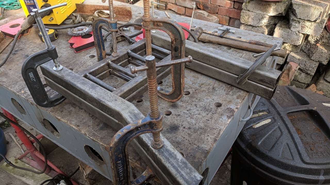

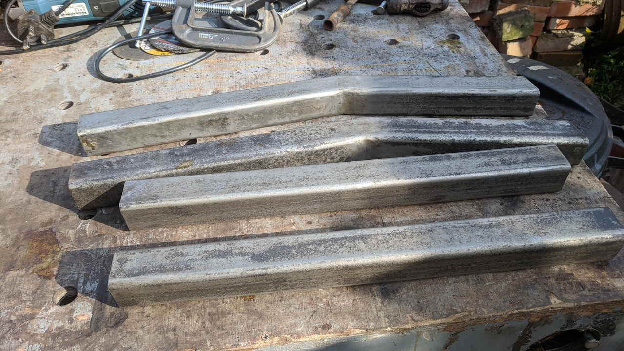

    A few years ago, I made a "teddy bear seat" for gf's little girl from her first (toddler) bed.
    Gf has asked me to "weatherproof" it so it can stay in the garden. Unfortunately, the wood isn't up to it, so I built this:
    IMG_20180531_172842.jpg IMG_20180531_173203.jpg IMG_20180531_173847.jpg IMG_20180531_175052.jpg IMG_20180531_180301.jpg IMG_20180531_180812.jpg IMG_20180531_182632.jpg IMG_20180531_184245.jpg

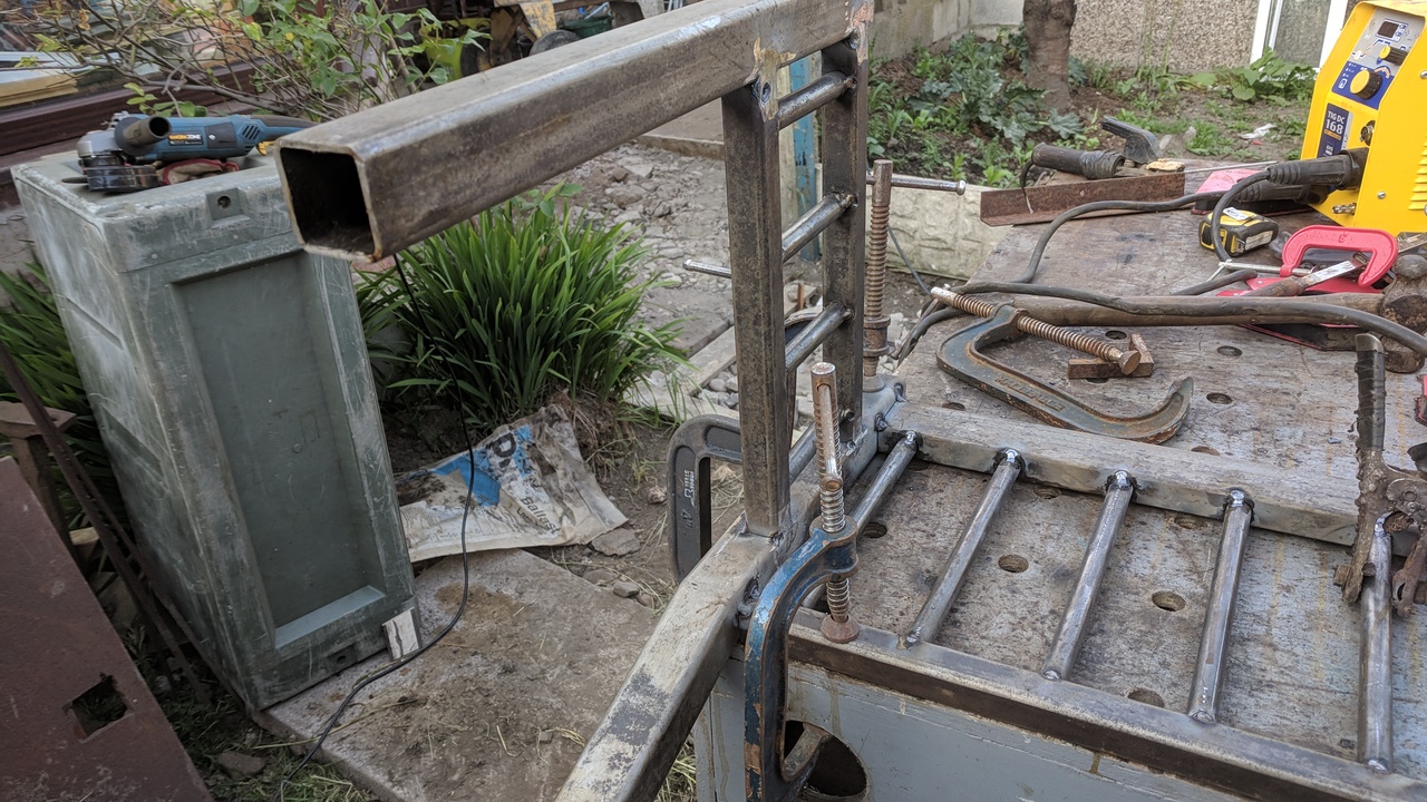

    Ready for end caps, and paint.
    And next to the original

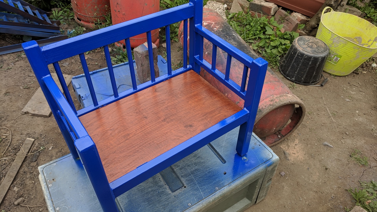

    Finished.
