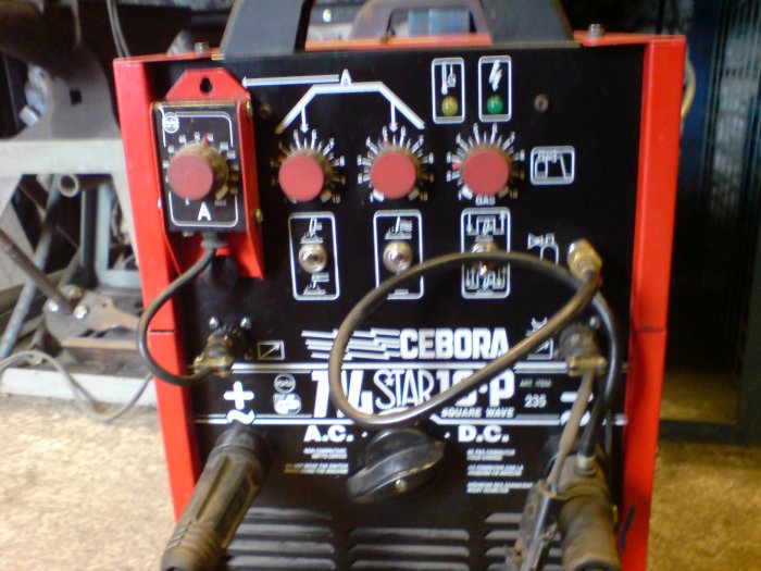

Does the control panel look anything like this 160 amp Tigstar below.

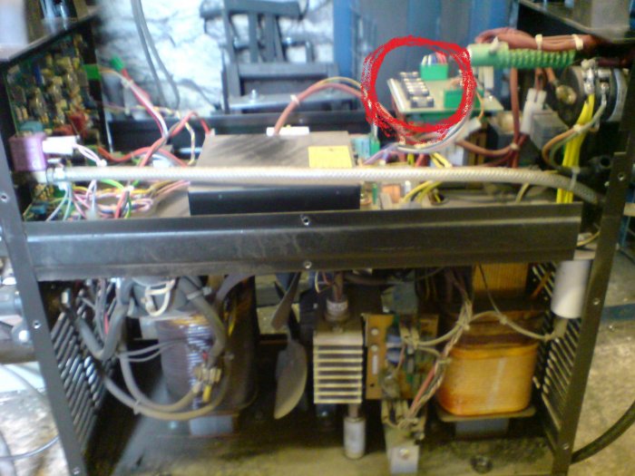

I'd see if it would stick weld on AC...if not maybe start looking at the AC/off/DC switch...could be something adrift there. Or maybe a fuse inside, the red circled bit in the bottom pic of the innards shows lots of fuses.
