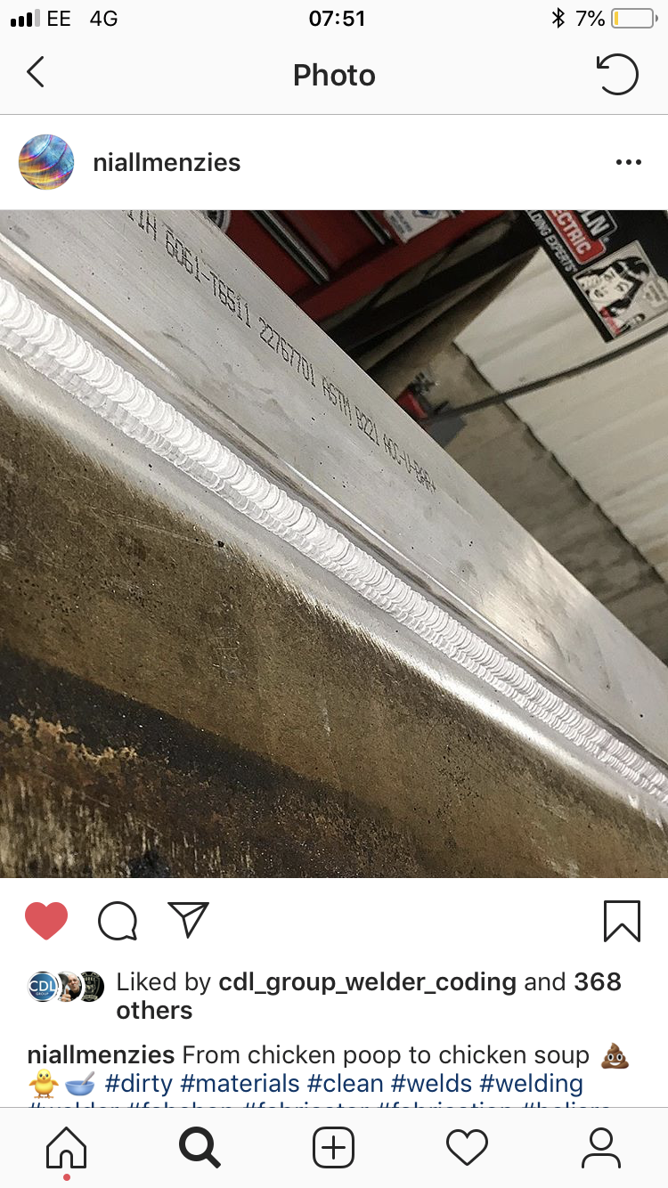

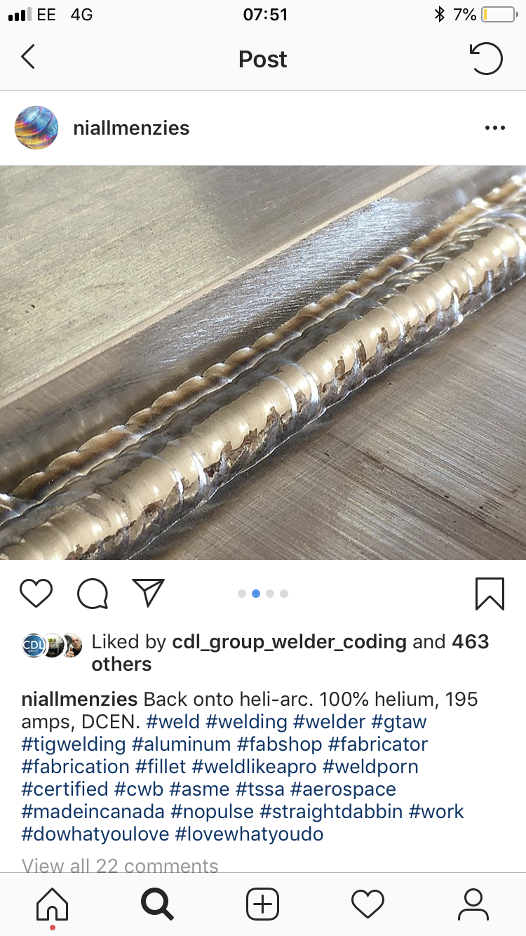

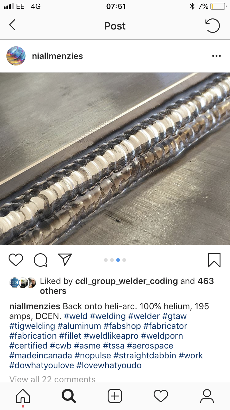

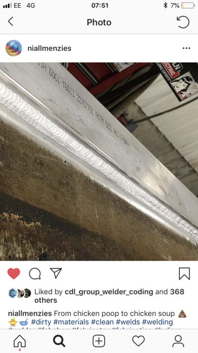

Sound like a bit of a faff around.usually strike the arc under argon then swap over to pure helium once the arc is established
The sets I've used it on automatically switched over from Ar to He, not sure if this is still the case with more up to date kit. Years ago a company I worked for sold a load of small DC inverters for use by RAF ground crew to do small ali repairs on aircraft whilst sat on the tarmac, they used pure helium and must have used scratch start arc initiationSound like a bit of a faff around.
Was meant to try it when I picked up a DC Tig set from @eSCHEn, although I’ve never got round to it, and the cylinder of Helium sits unloved in the corner still..
