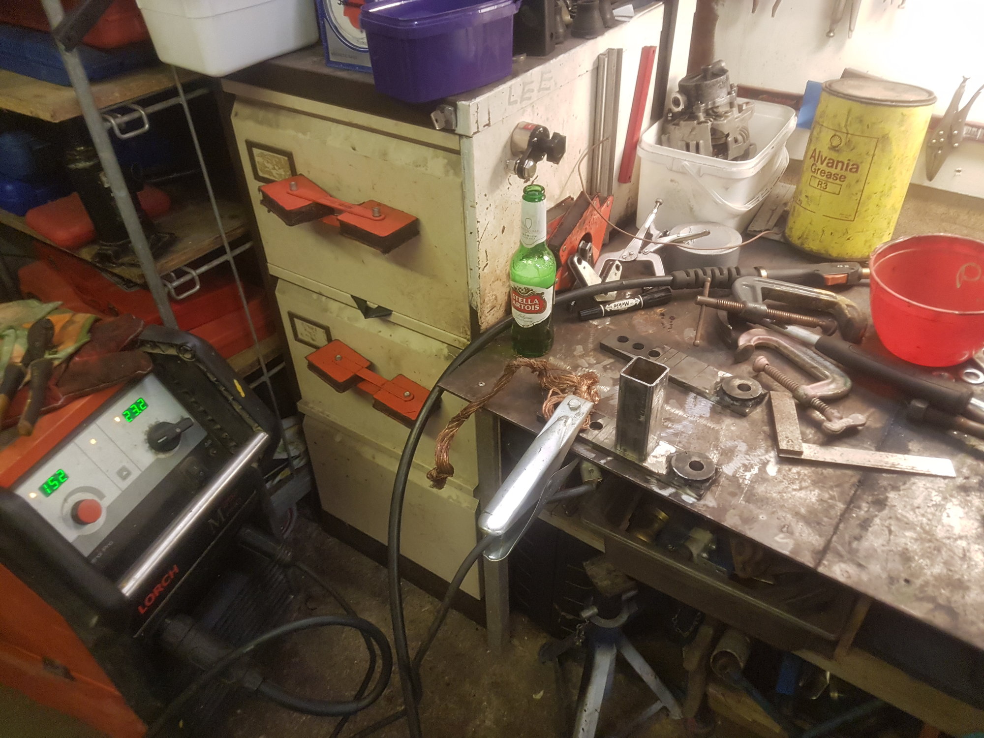

    Really. Yeah it’s a super set. Is yours the control pro panel

    Yep that’s the boy. Control pro. Very nice set.
    We got one in last year. Matt and I pushed it waaaaaaaaay beyond its max output just to see what we’d get and although it wasn’t a weldable condition we got nearly 400 amps out of it on a single phase supply.
