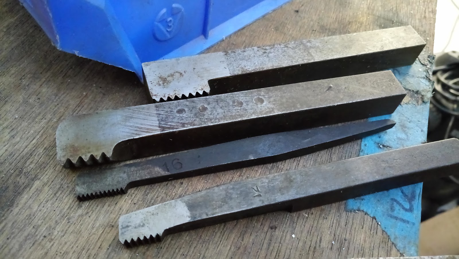

Chasers were usually used on brass, When I was serving my time, The guys in the steam loco repair shop used the chasers to create a thread from scratch on brass valve gear and sight glass fittings etc.
I thought that I should add that they used hand chasers and not the tool post type, Threads were done in no time flat.
