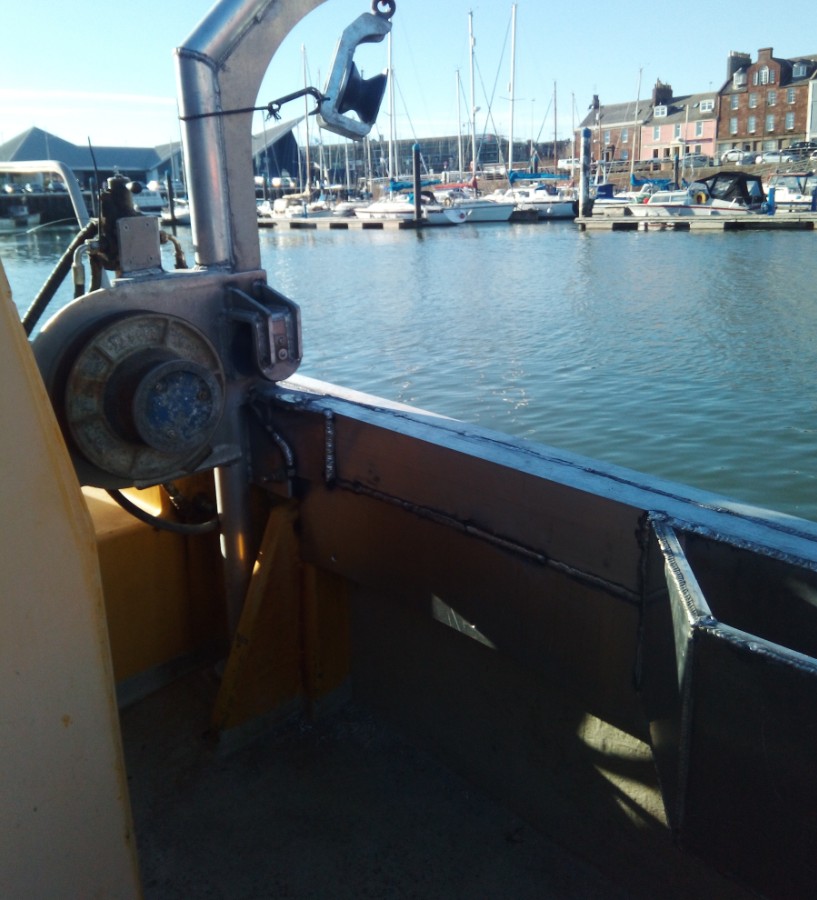

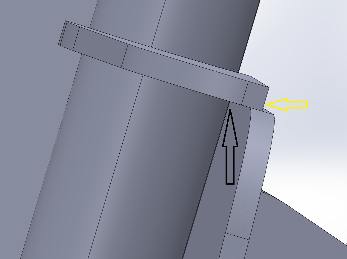

What are your thoughts on current for 12mm fillet welds in 5083, would 300Amp do it or would it struggle.
Could get heat into it before by doing the other side which would be an outside corner and 300Amps I would think plenty for that. The other welds would be 12mm to 1/4" wall tube so again I think 300Amps would suffice for that.
Edit to phrase it better. It will be a fillet weld on 12mm plate.
