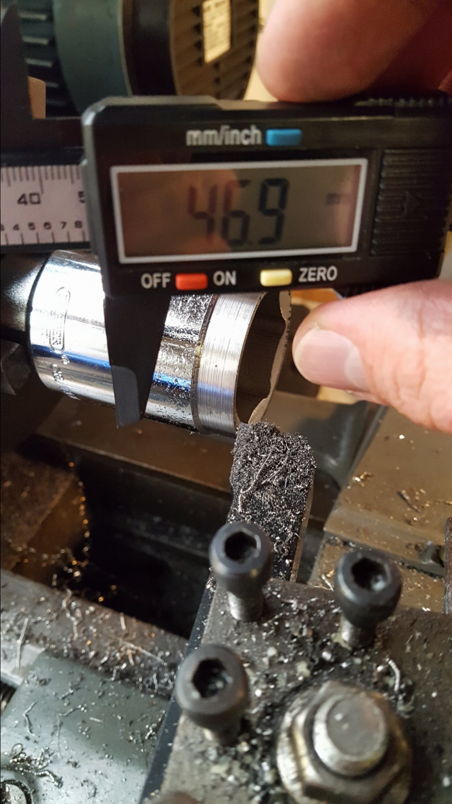

Basically, on the subaru 5mt, the rear synchro setup is held on with a 35mm nut, but it sits inside a ring that is only about 47mm wide, so most sockets won't fit unless they're expensive thin wall or even more expensive special subaru tools.

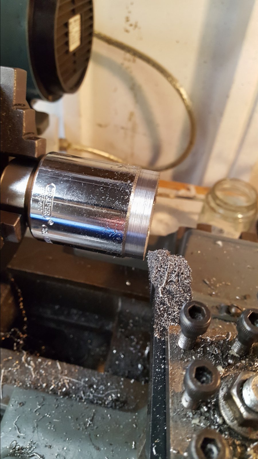

Anyway, I bought myself a draper socket for 11 quid off ebay for some PSA hub nut, and tried machining it on my old atlas 10" lathe.

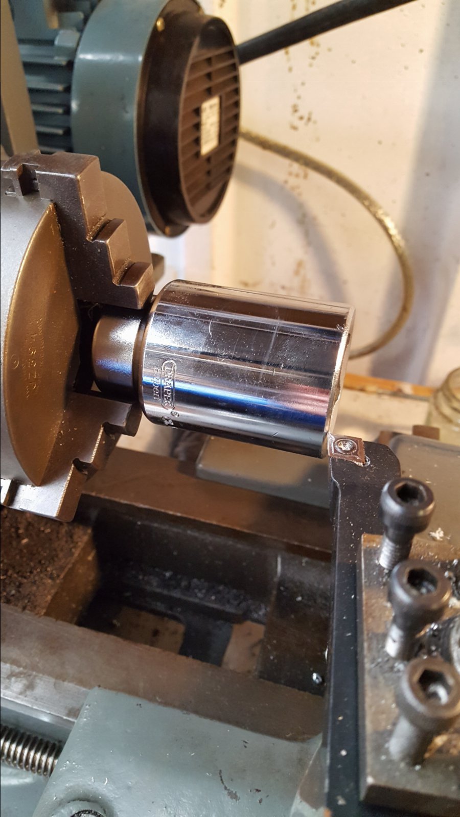

I think my indexable tip has just about had it, but it managed to eventually cut through the socket (about 8 thousands at a time off the rad). The fact that the socket didn't fit through the chuck so I had to hold it on the small section definitely did not help (it came loose once).

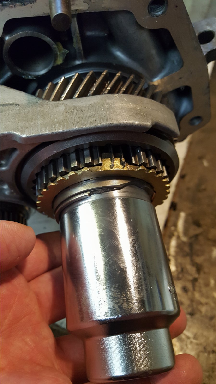

Moment of truth:
Boom
All in all quite a successful little mod
