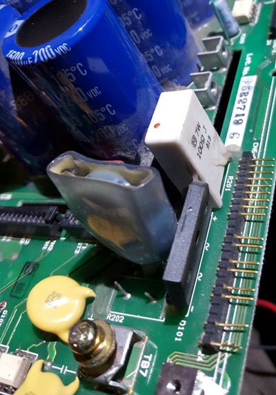

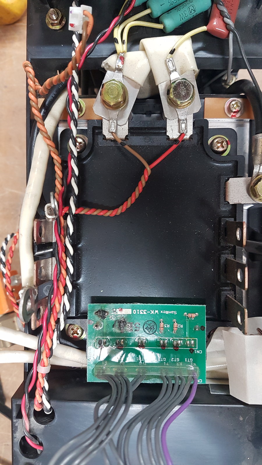

    Hi folks,
    New on here looking to learn a bit about tig welding.
    I've picked up a thermal arc 190 gts but it's in need of some love. Fan comes on nothing else and it's got some interesting wiring inside. I think it's taken a hit or been dropped and someone has messed up trying to repair.
    Is anyone here running one of these models?
    I've followed the service manual and everything tests good but I have found a resistor is missing. Would anyone be willing to take a photo of their pcb for me or even just the value of resistor?
    it's R202 I need just behind the main mcb when you take the cover off. Should similar maybe even identical to R201 (white tower block shaped thing) in the attached picture
    thanks Neil

    For reference R202 is the same as R201 100ohm 7W.
    Sanrex USA suggested that if PHC 101/102 were gone it was likely an indepth repair and a new PCB would be more cost effective.
    Unfortunately i have no way to verify if these are working.
  7. eddie49 Member
    Assuming these components are on the main power board of the inverter, it should be fairly easy to trace the layout of the circuit around the suspect components and the ones close to them. This can be done by identifying the components and visually tracing the PCB tracks, then making a sketch. Easier said than done, of course, but in this case the components are large, generic, high-power stuff. D101 is a bridge rectifier, R201 and R202 are wire-wound 100 Ohm resistors, the sleeved component is probably a metal-oxide Varistor, there's a bunch of 1500uF smoothing capacitors nearby. The wires that were originally connected to the screw-terminals, such as TB7, should be traceable to their source.
    Sanrex USA may be right, other parts of the machine could be at fault, but this localised area should be fixable.
