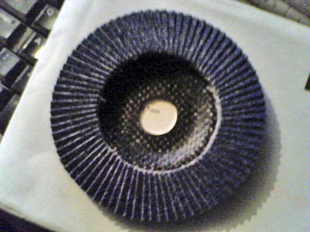

I would think for you guys that work on cars these would be cool
Basically bits of emery cloth stuck to a grinding disk, available in 40,60,80 and 120 grit, far less abusive than a grinding disk, redhot for polishing down a weld to a nice smooth finish. Great for pre-cleaning when welding dirty steel, I use them for splatter removal when i make railings, zap them all over the railing quick, knock of sharp edge and paint for a perfect finish. They normally cost about £2.00 ish depends on the quantity you buy, I get mine from my local welding distrubuter.
Pic isnt great but gives you an idea of what they are like
