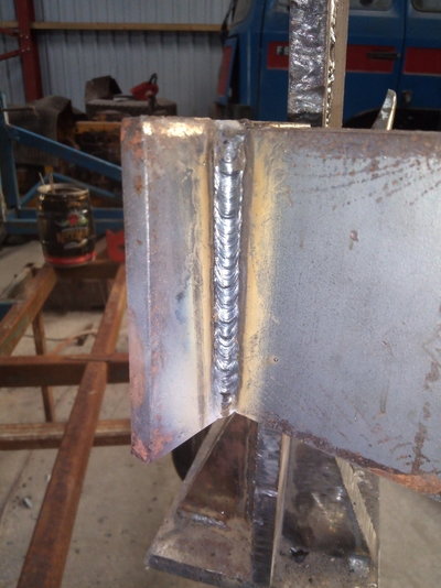

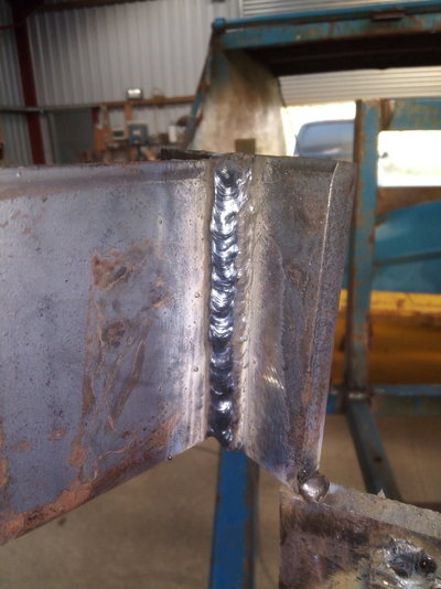

Evening lads and lasses been time since I practice stick welding so I was tacking up some stuff today thought I'd throw up a practice piece.
Welded on a thermal arc 175
3 bead pass using murex 6013 basic @ 80 amps with 1.5 on arc force
Single pass 3.2 125 amps with 4.5 arc force using a filarc p27 8018
What you all reckon I might become a good welder lol
