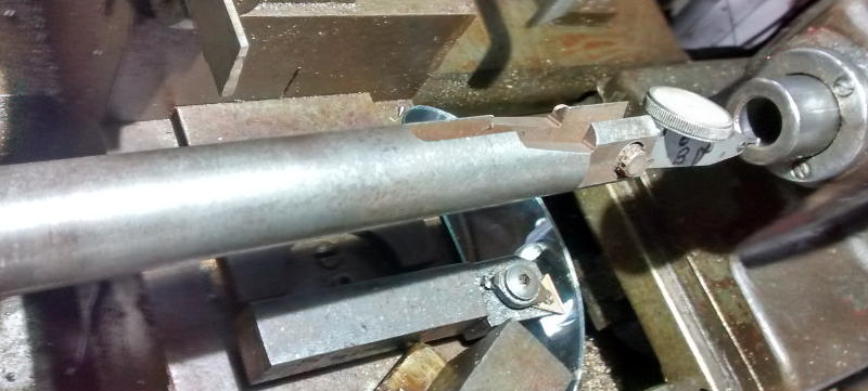

    If you want to know where the tailstock bore is in relation to the spindle,
    stick a dial gauge in the chuck and rotate it in the tailstock bore.

    You have to be very careful doing this. If you mount the dial gauge on a rod and rotate the chuck the rod will bend under the weight of the gauge (and itself) and mess up your readings,
    Put a mag base on a small surface plate, zero the gauge then turn the plate over, you'll see the gauge has moved 5-10 thou probably.
    fizzy, eLuSiVeMiTe and pressbrake1 like this.

    I use a dial indicator bolted to a bit of bar. It seems to work OK.
    fizzy likes this.

    It would do, but you'll never know how much the bar bends under it's own weight using that setup. Won't be much with a bar that chunky but it WILL be bending.
