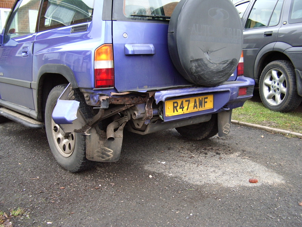

My trusty Vitara was starting to show some serious rust problems last year so I thought I'd strip off the bits, repaint them, and weld up any holes. But after starting the work it's turned into a full restoration.

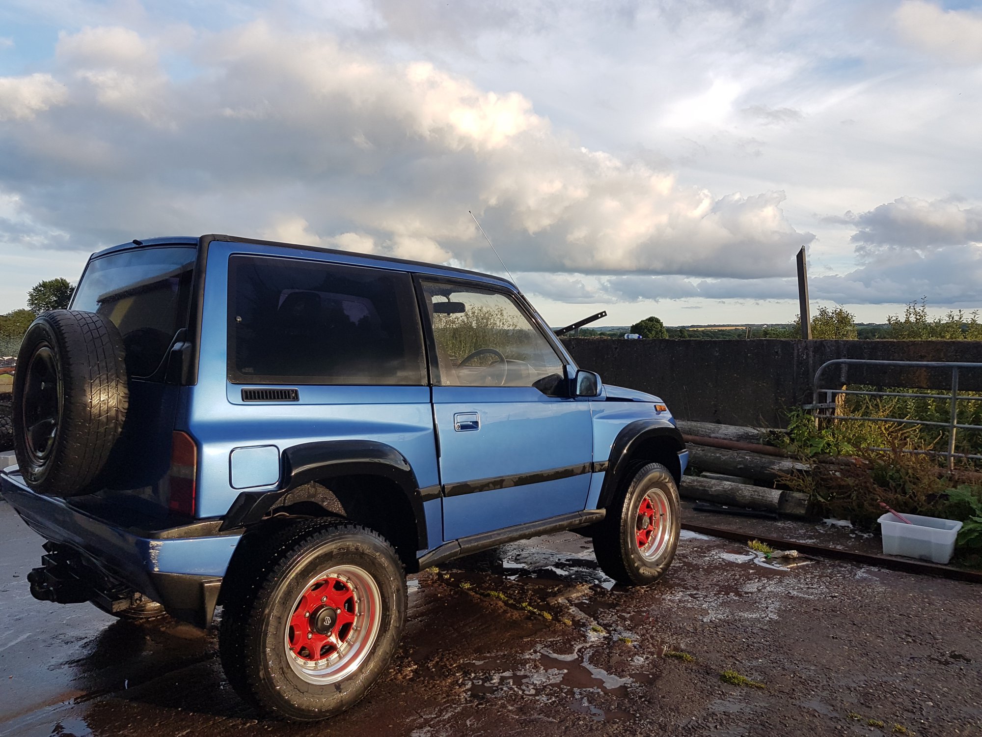

Over the years the car has had some serious modifications, from suspension lift to gearbox and drivetrain mods, so I also want to save my investment.

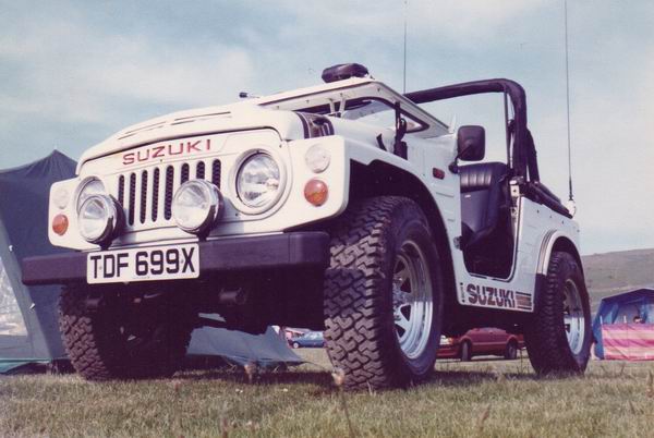

So this is the little bugg'er shortly after I got it. It already had an American suspension lift kit fitted and I can't even remember what those wheels were from:

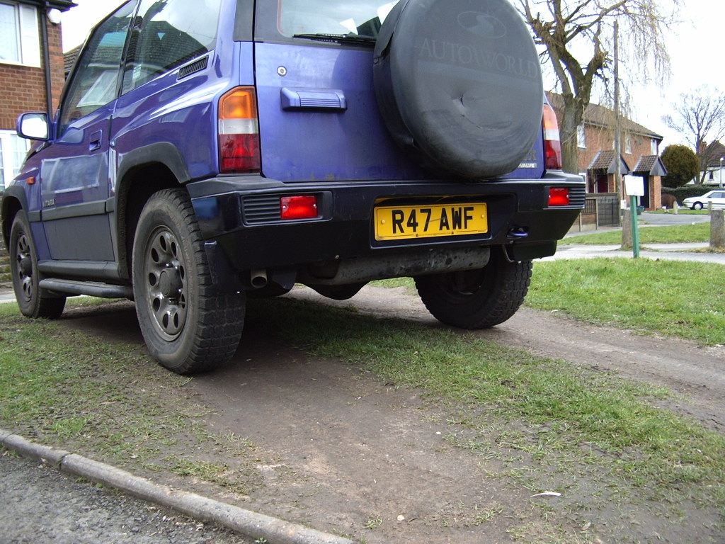

Over the years it got a lot of mods, some body work, full all round armour, drivetrain was strengthened, gear ratio mods, diff locks, and a whole bunch of small bits and bobs. This was it a few years ago:

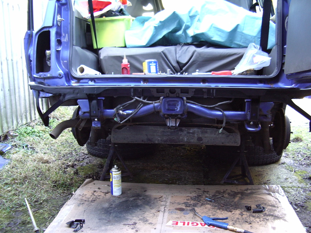

The restoration started a few months ago with a total strip down to the chassis.
