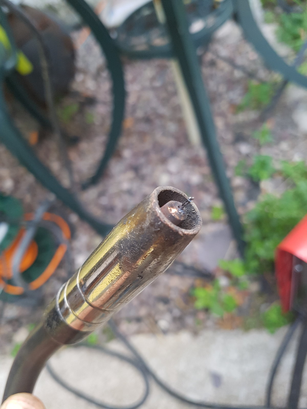

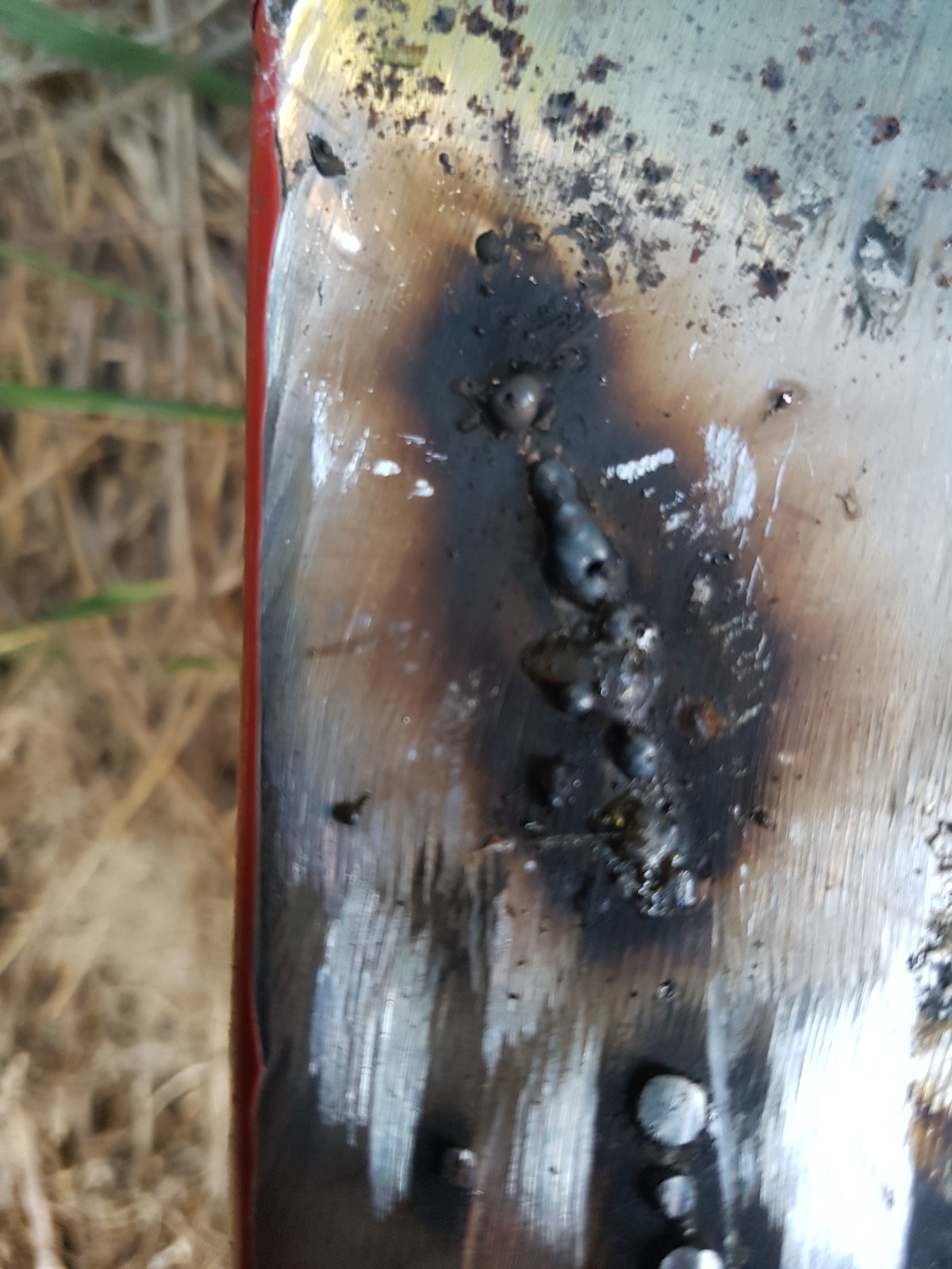

    I've just started out with a mig. I am struggling a bit and I am hoping for a bit of help.
    I find that the torch gets stuck to the metal.. and I can't make the classic weld shape?

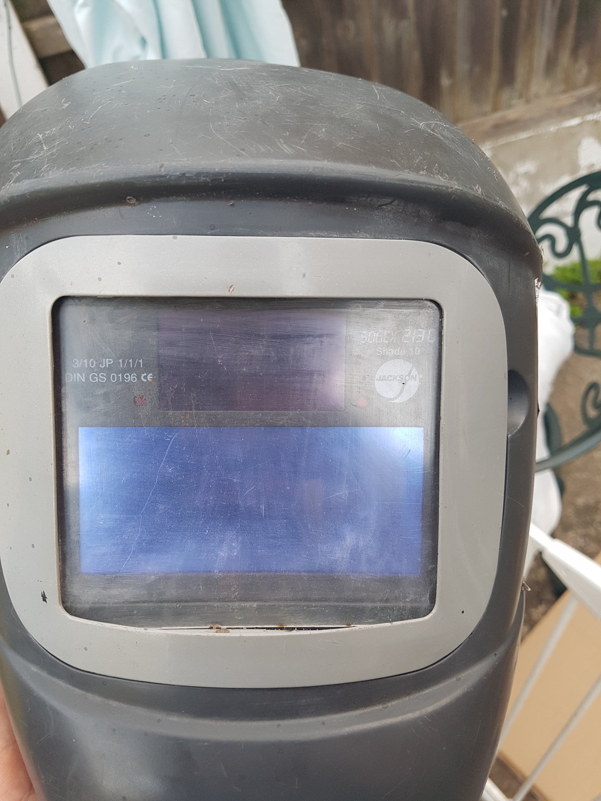

    I also can't see a thing once it starts sparking. My mask turns from yellow to dark.
    How do I hold the torch should I be moving it in little circles? I've attached a photo!
    Thanks everyone!

    The key is to hold the torch and steady with the other hand. If the torch is sticking to the parent your holding it a bit too close.
    Is your mask adjustable shade? If it is you want about 9 to 11 depending how much power you are using. If you need glasses for the distance from your weld to your eyes, wear them under the mask
    Your weld also looks to black around the melted metal is it with gas or gasless. If with gas and you are outside is the gas been blown away, as that looks like grass behind the weld.

    Have a read of this before going any further, then let us know what machine/wire/gas/mask you are using.
    http://www.mig-welding.co.uk/mig.htm
    The weld shown is about as bad as it gets and has several issues going on, once we know more we can start to eliminate.

    Thanks for the replies and links I will have a read. I was outside but I tried to stay out of the wind. I am using a cheap mightymig 100 without gas but with the apparently gas coated wire. I know it's not the best setup but I wanted to get used to it and not flinch every time it sparks!
    The guy I bought it from got a good weld which was straight with sort of circular ridges with it on some steel plate so I know it can be done I just need to put some time in.
    I found it didn't stick as much when the wire protruded by about 15mm from the nozzle.

    “Gas coated wire” :clapping:
    Not sure that’s been invented yet. :laughing:
    Gasless wire is flux-cored and is essentially a hollow tube with stuff inside it which, when “burned”, forms a protective shield over the weld to keep oxygen in the air away from it.
    15mm stick out is a tad too long, 8-10mm is the recommended length.

    To start with, reduce the wire length, and try a different wire feed setting. Also, does your helmet have a darkness setting, or is it one of those hand held fixed jobbies. If so, invest in a cheap auto adjustable one, as seeing what your doing is half the battle.

    Thanks guys not sure about my helmet will have a look tonight (it does get darker). Thanks for the clarification on wire type. I will try varying the speed :laughing:

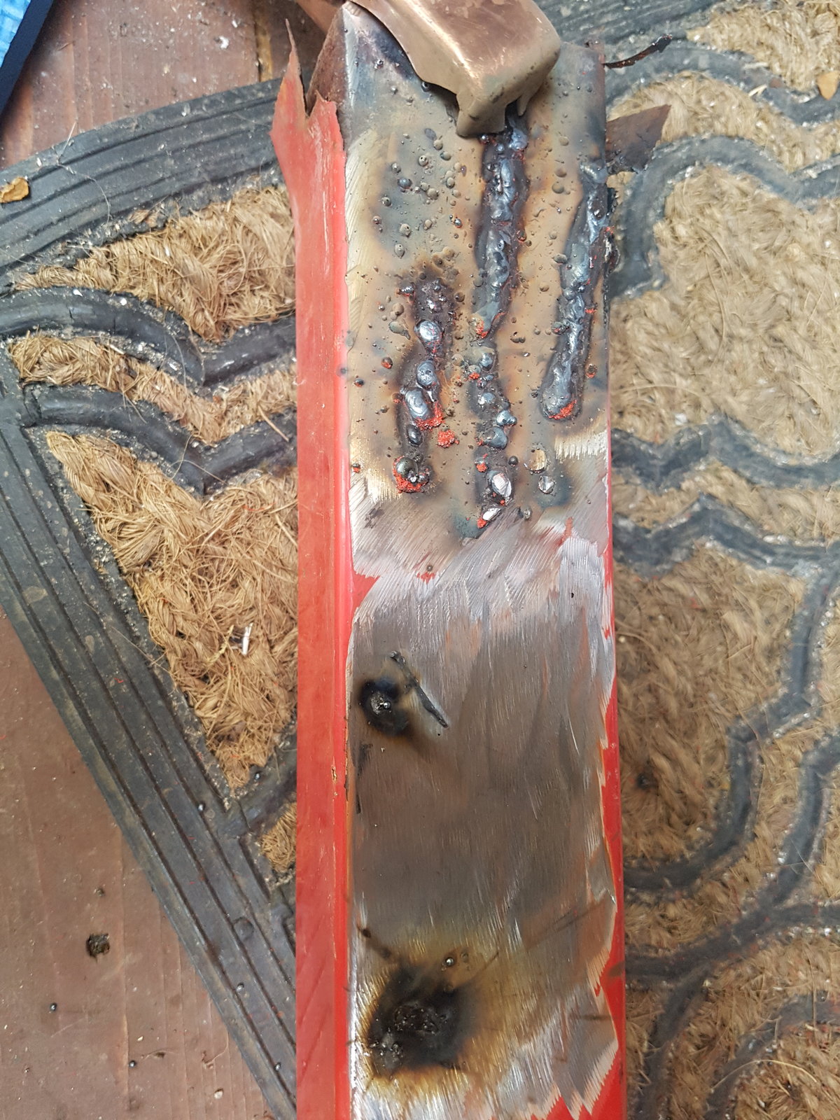

    Had another bash tonight. The wire always seems to weld itself to the tip and then stop feeding... is that because I'm not moving fast enough?

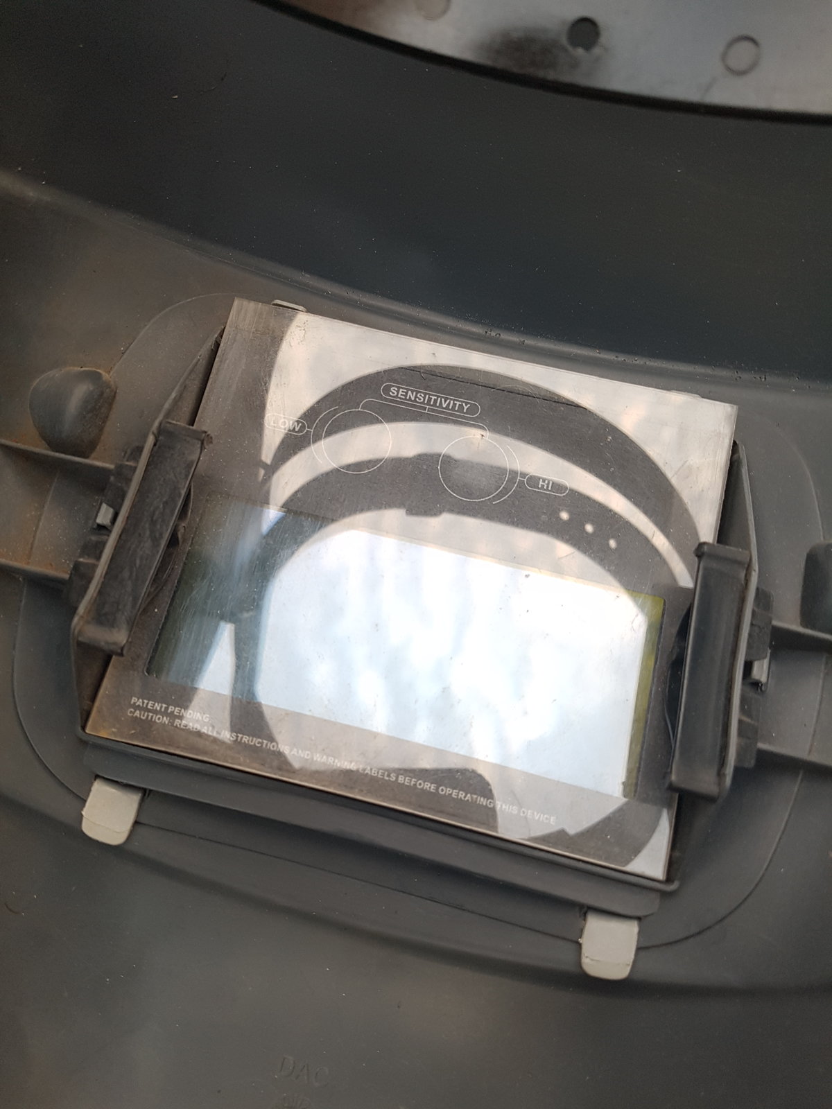

    I don't think the mask is adjustable or I can't figure out how to adjust it.

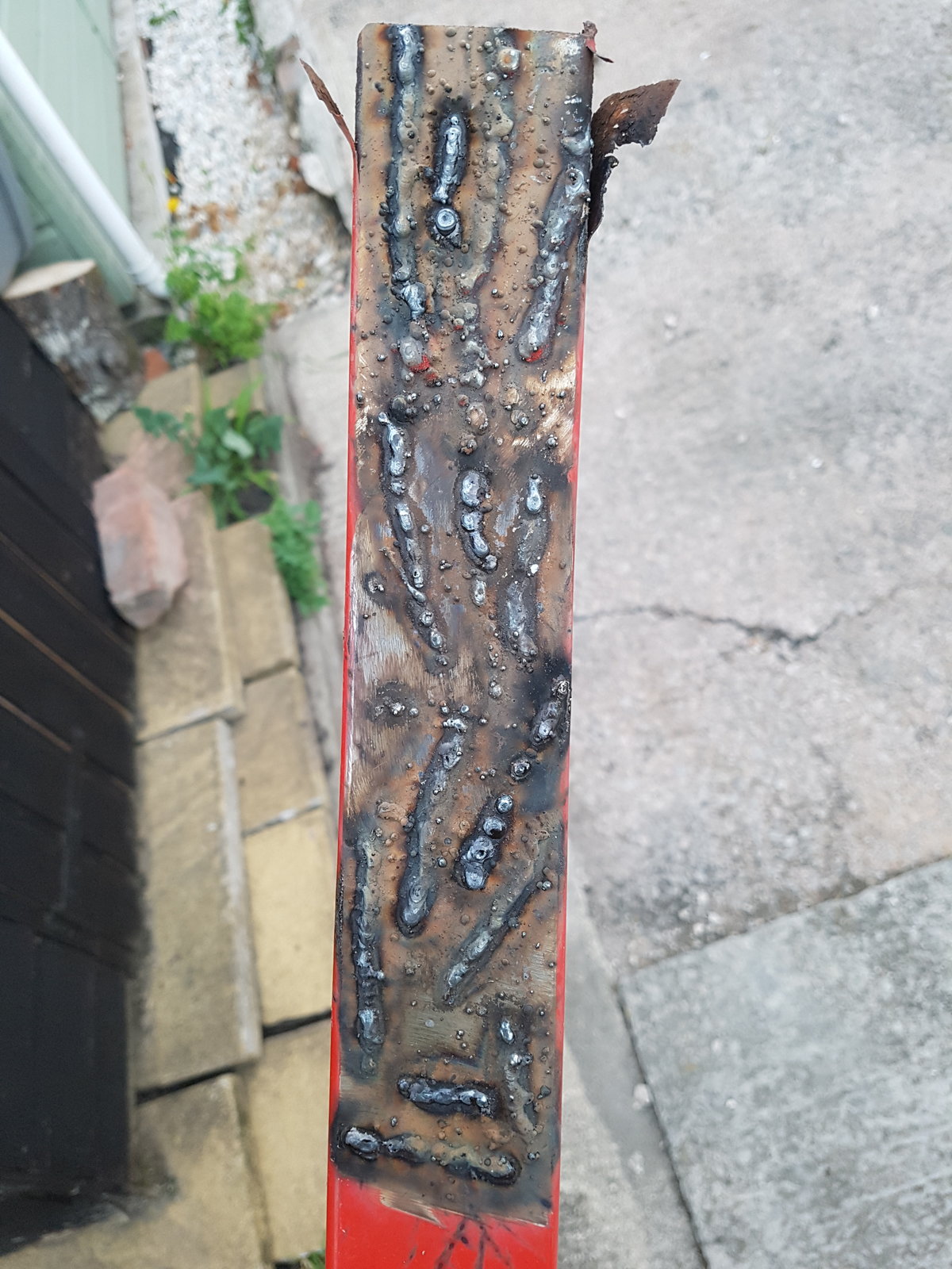

    Did a few more runs. I think I have the angle ok. The wire doesn't stick as much but I think I am moving too quickly. Gonna try and move the nozzle a bit slower to get a wider more consistent weld.

    Have you checked that you have removed the protective film from both the outside AND the inside of the mask glass and plastic shield - guess how I know about that !:whistle:.

    have you got a spare outer plastic shield on the inside of your helmet? looks like there are adjusters behind it?

    The black soot looks like a lack of gas when using regular wire and too cold ( not enough amps)
    The gas less wire or flux cored wire will be 0.9mm diameter, it's the only one with this size, regulars will be 0.6-0.8-0.1 etc all even numbers

    If your using gasless you need to drag it not push it like gas shielded wires. And if your nozzle is sticking try going a size up in the contact tip it will help not recommend but it will help also gasless wire needs a longer stick out then you would think.

    If you wire is sticking to your tip, Turn up the wire speed
