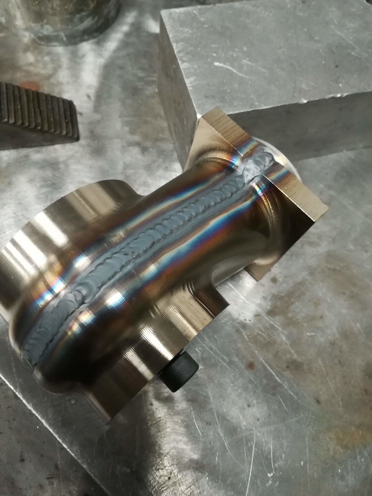

Had this Stainless part to weld yesterday. I was hoping for a better aesthetic finish. Any ideas as to how to achieve it. The part is 303 stainless and varies in thickness but is vee'd out. I only had 315 filler, around 130 base amps, 2.5 tungsten. The part was pre heated to 120 deg c.
