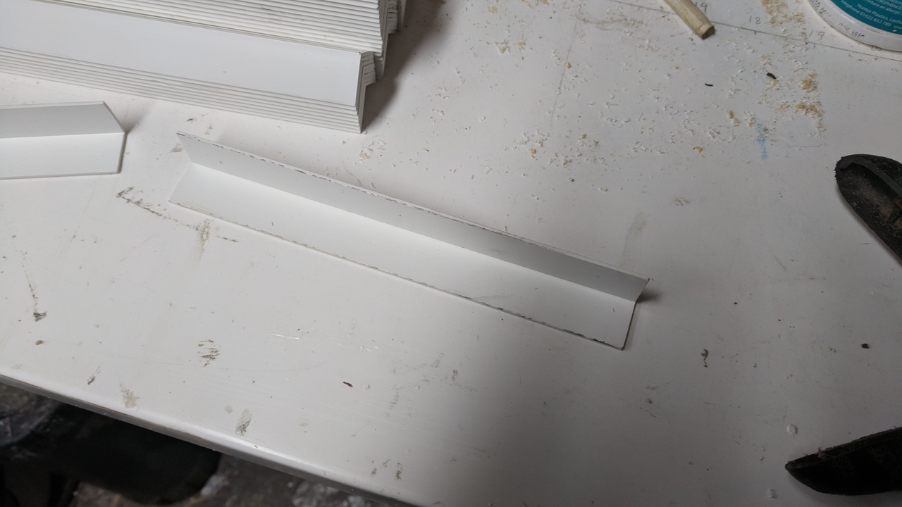

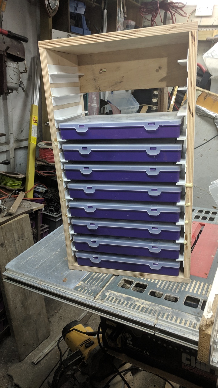

10mm x 10mm x2m pvc edge trim - £1.67 a length
https://www.selcobw.com/white-pvc-plastic-angle-10-x-10mm-x-2m
cut to 150mm

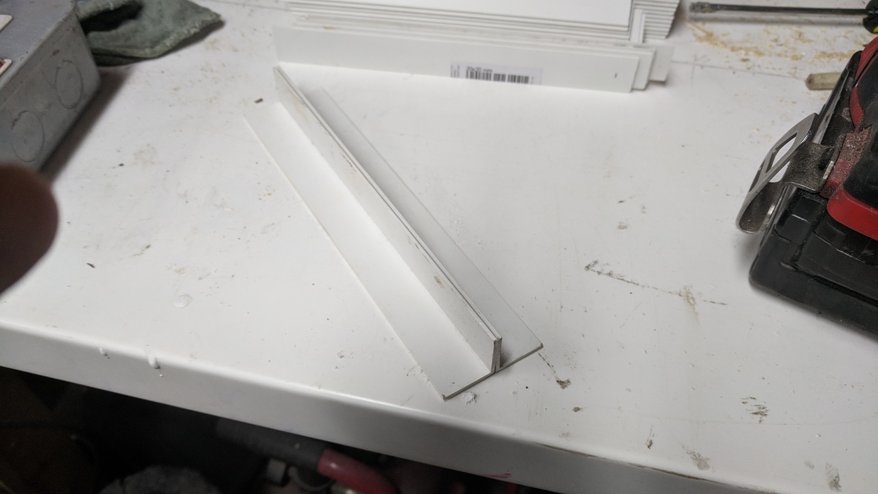

then (obweldingref) solvent weld two pieces back to back to make a "T" profile

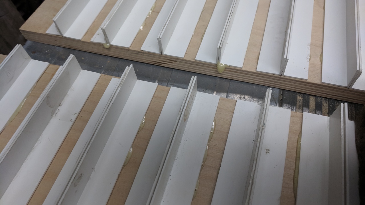

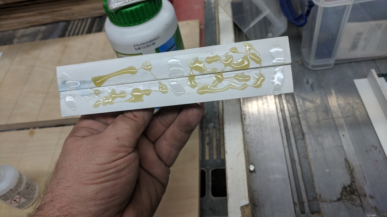

then use superglue + PU glue. superglue for instant "clamping", PU for strength.

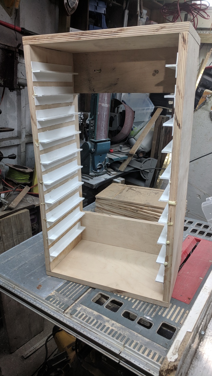

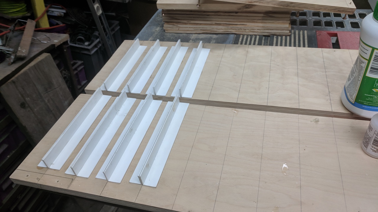

glue to cabinet sides
reassemble cabinet
fill with cheapo storage boxes...
