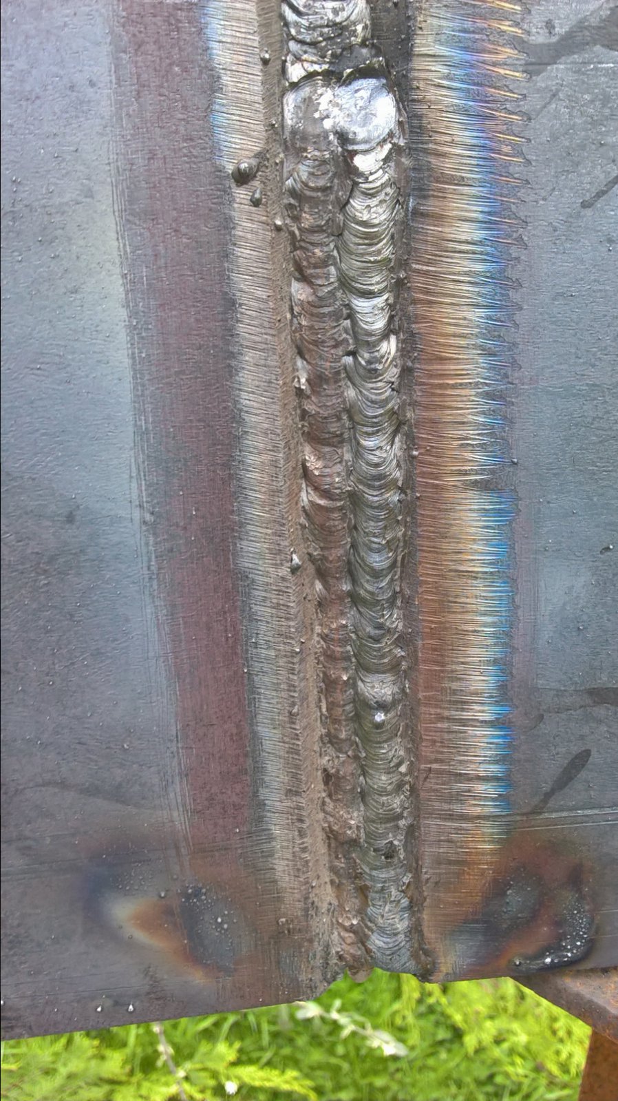

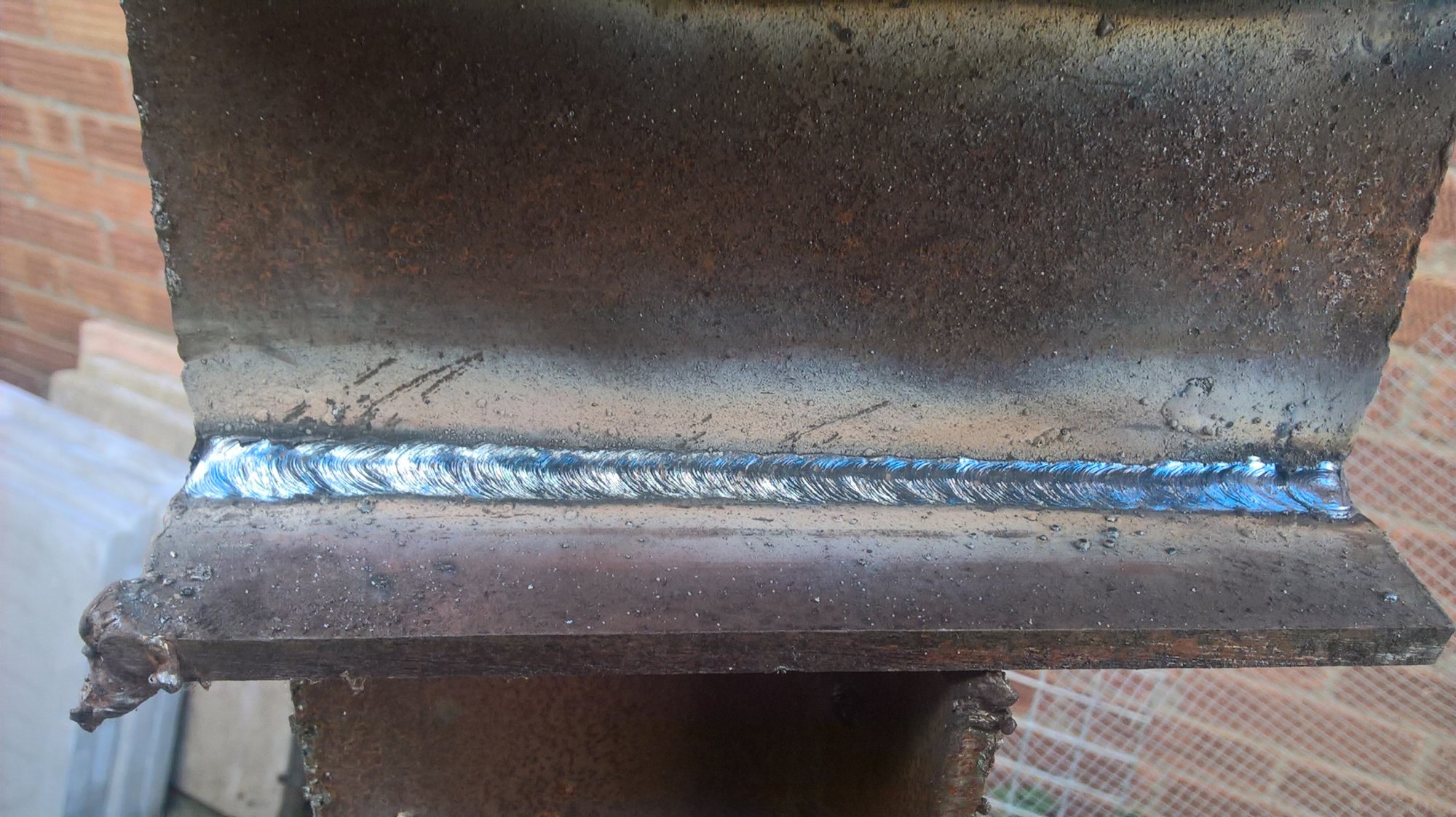

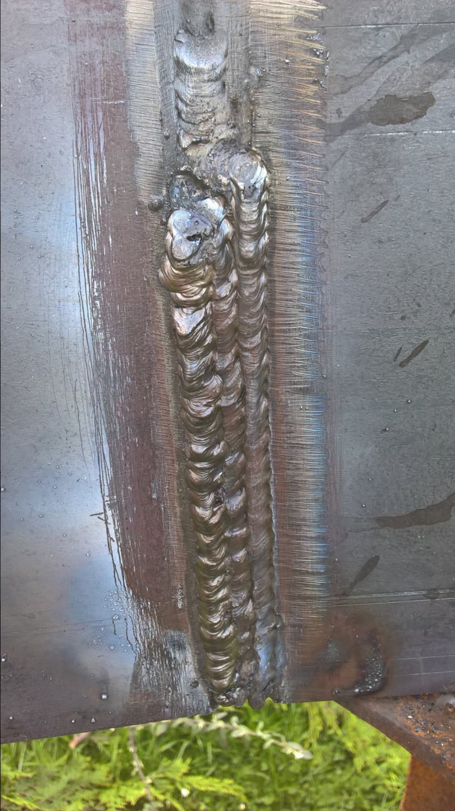

first pic

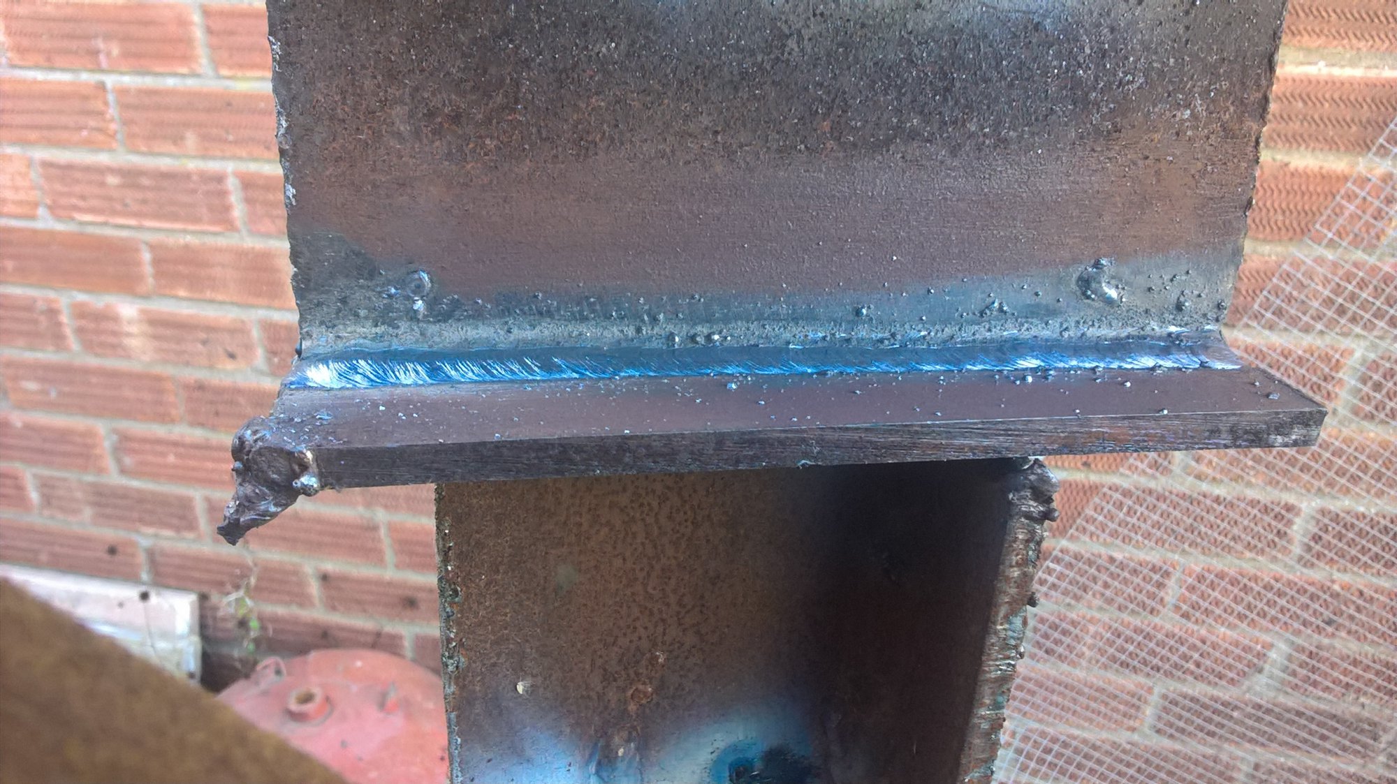

135 amps 3.2 super cito orlerkin single pass

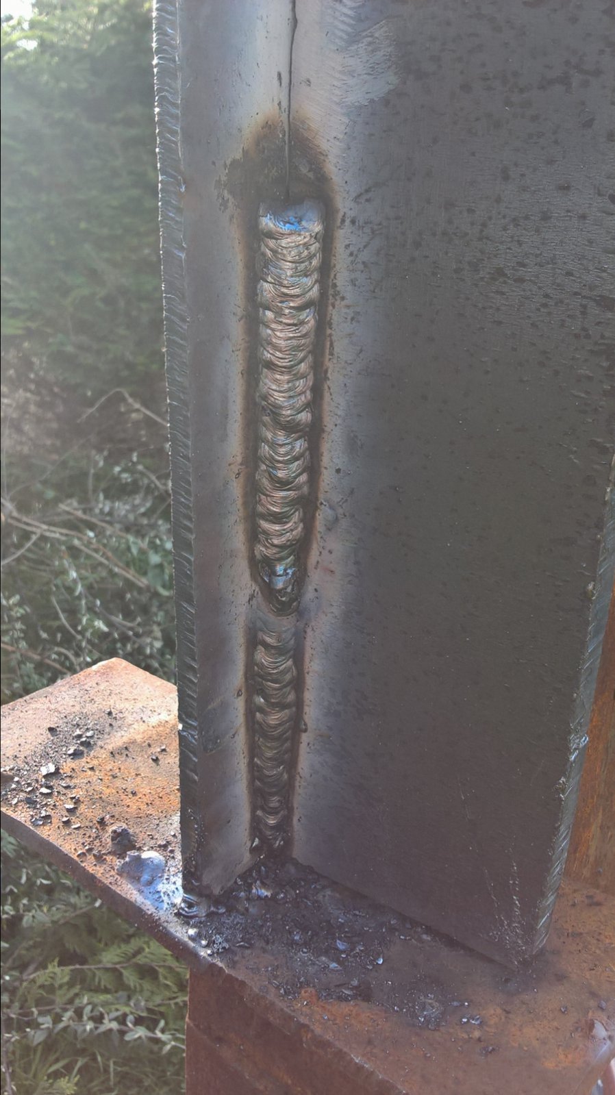

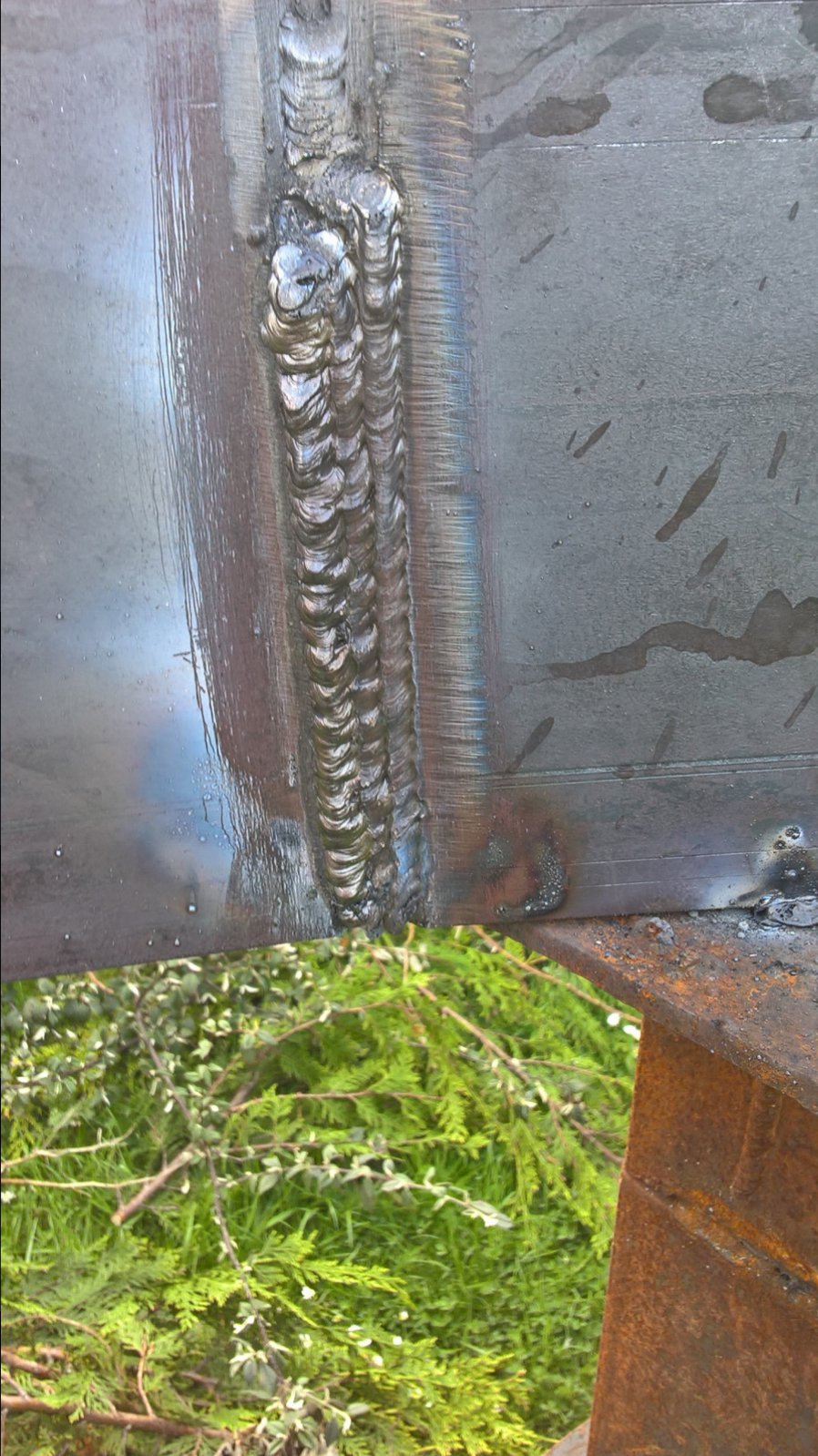

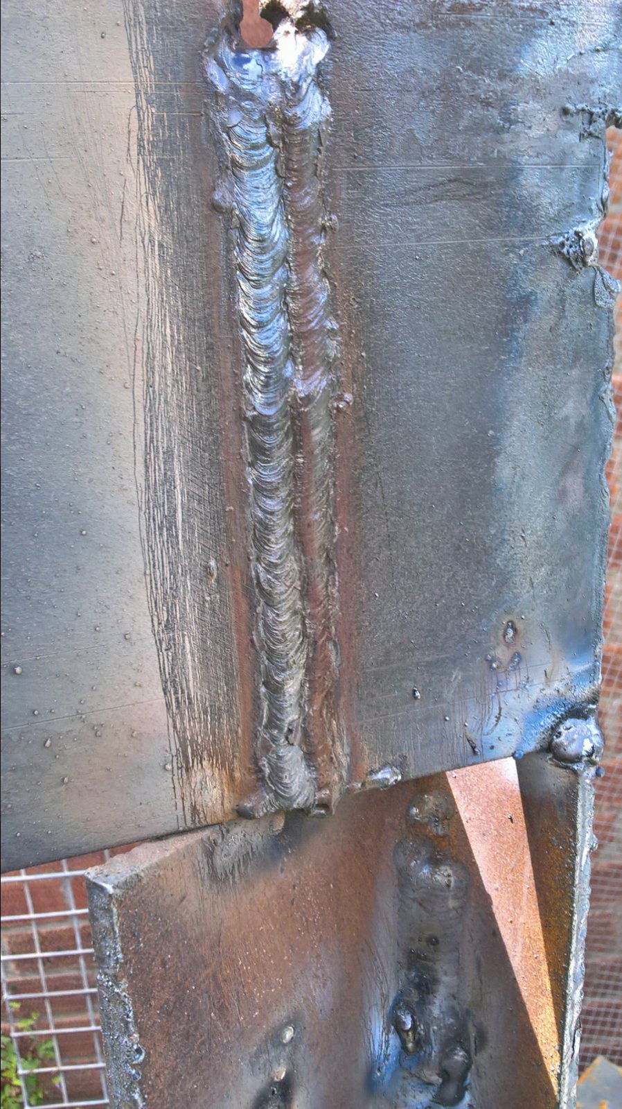

second

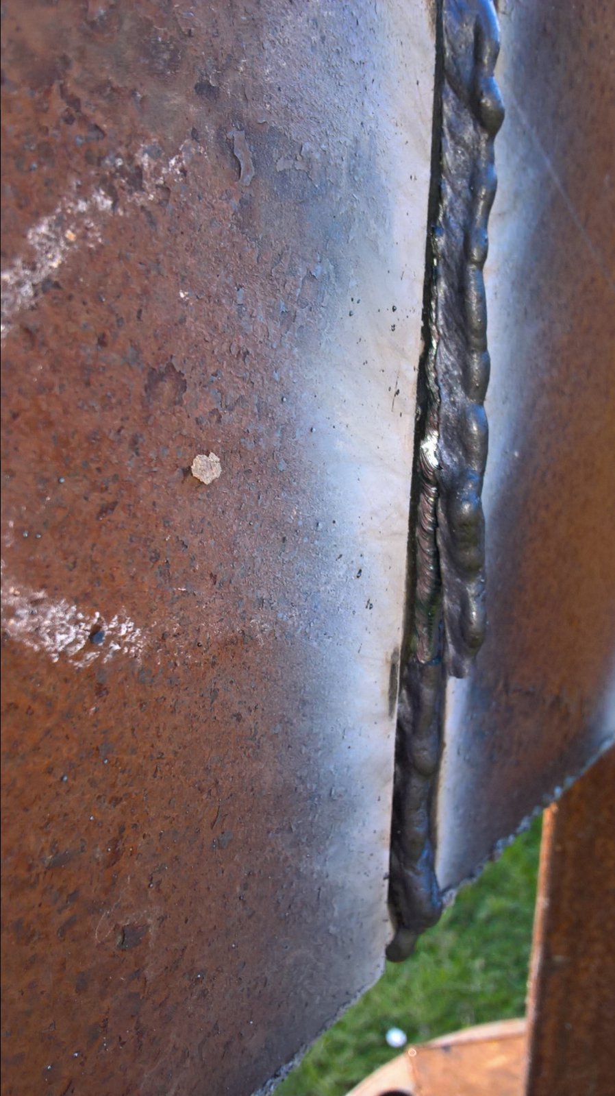

115 ish amps 3.2 murex rods v up tee

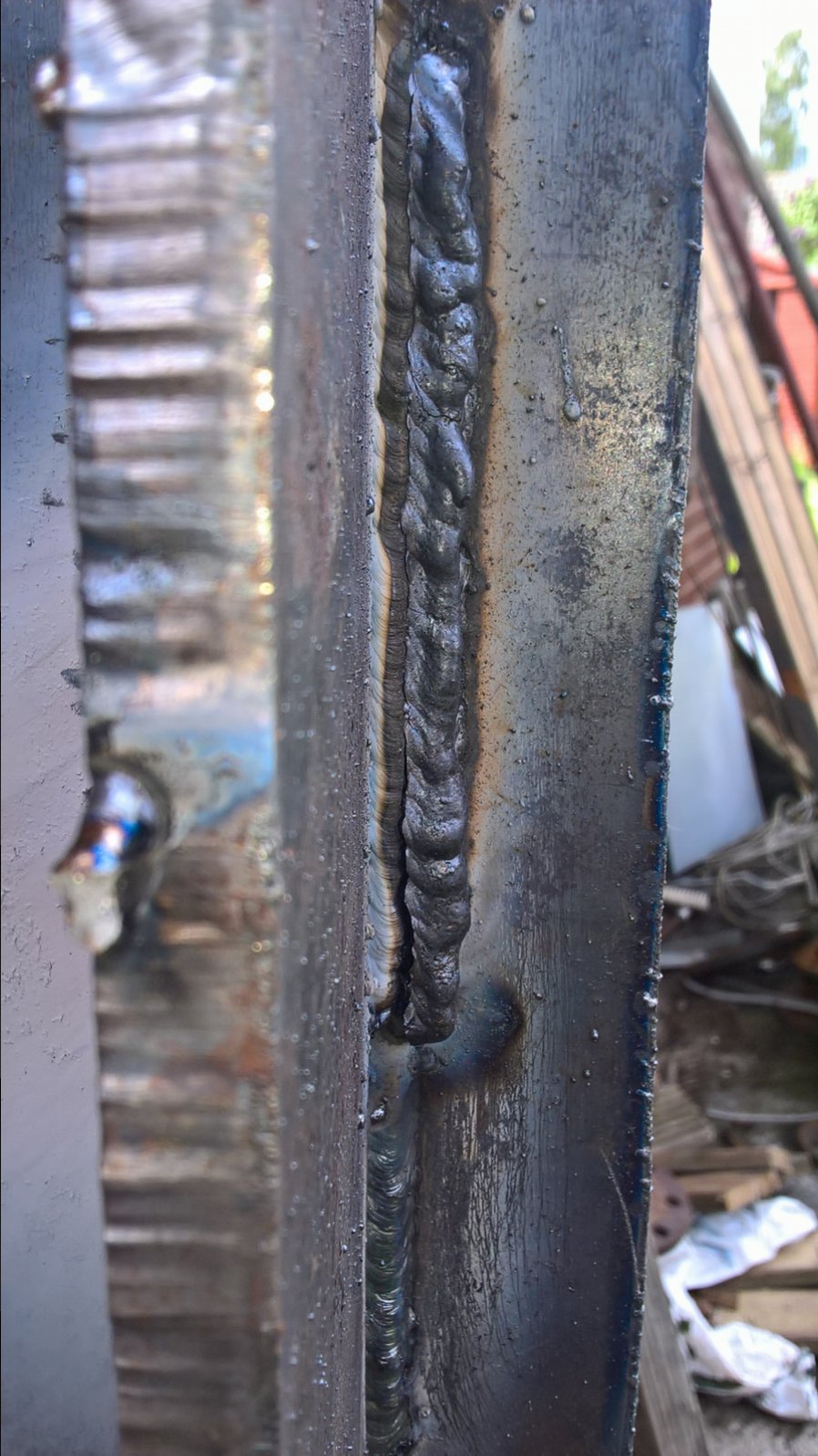

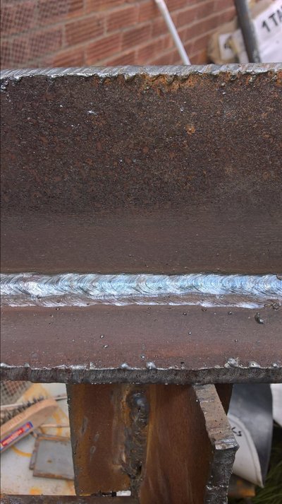

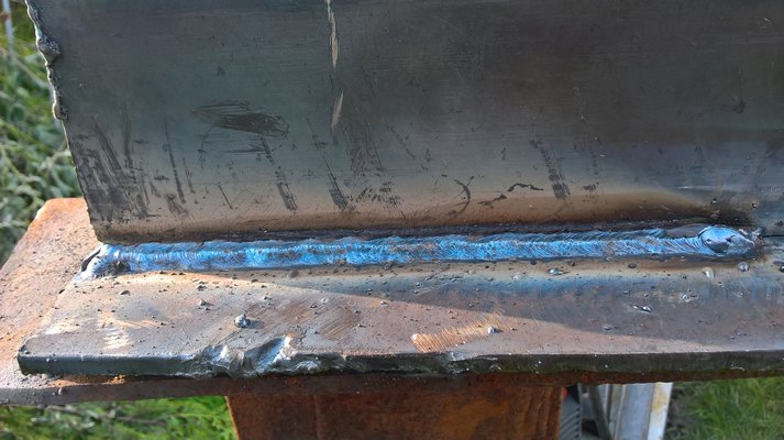

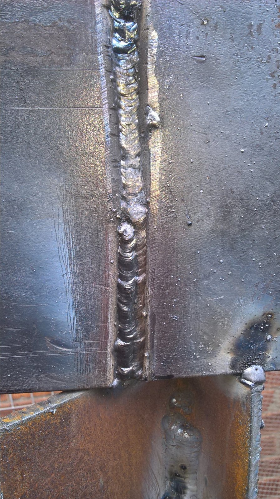

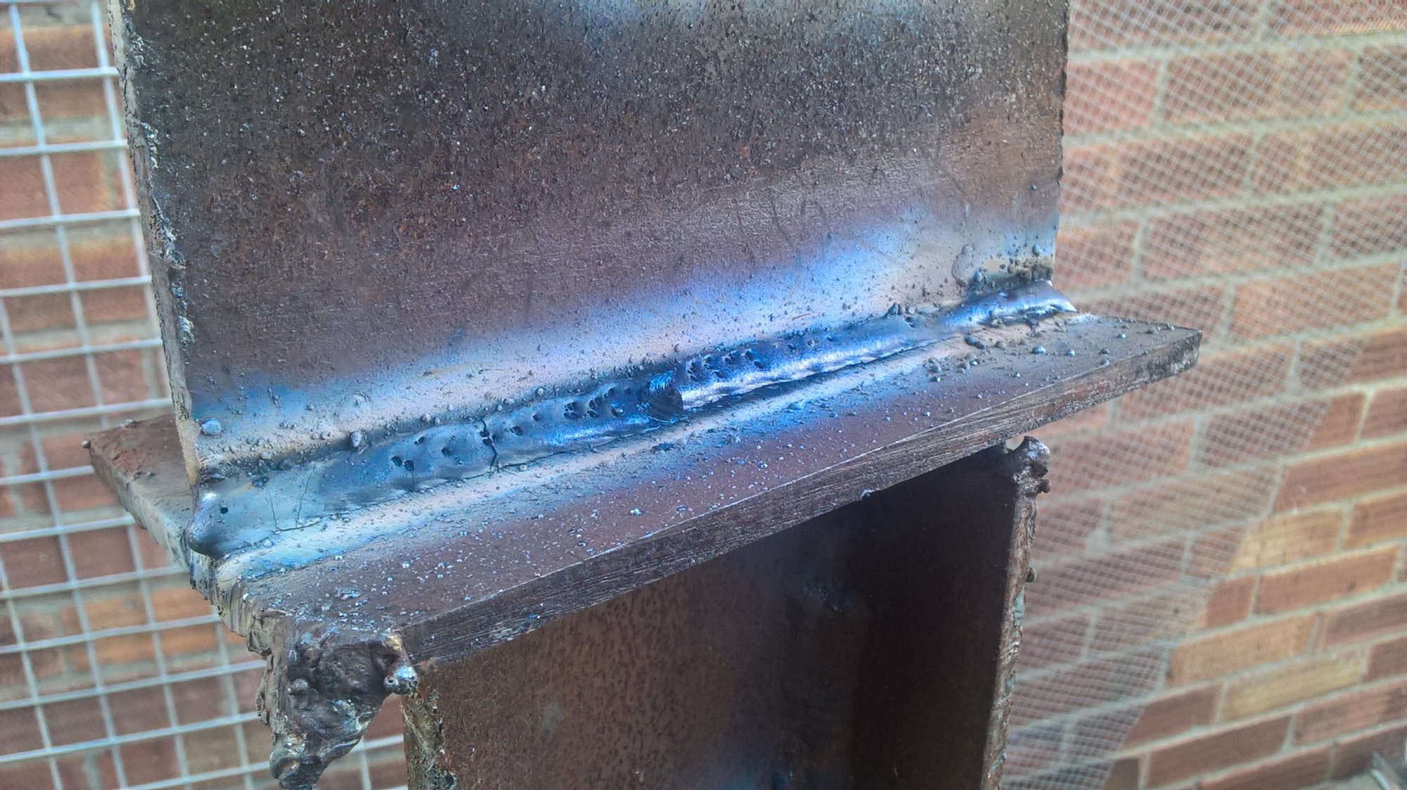

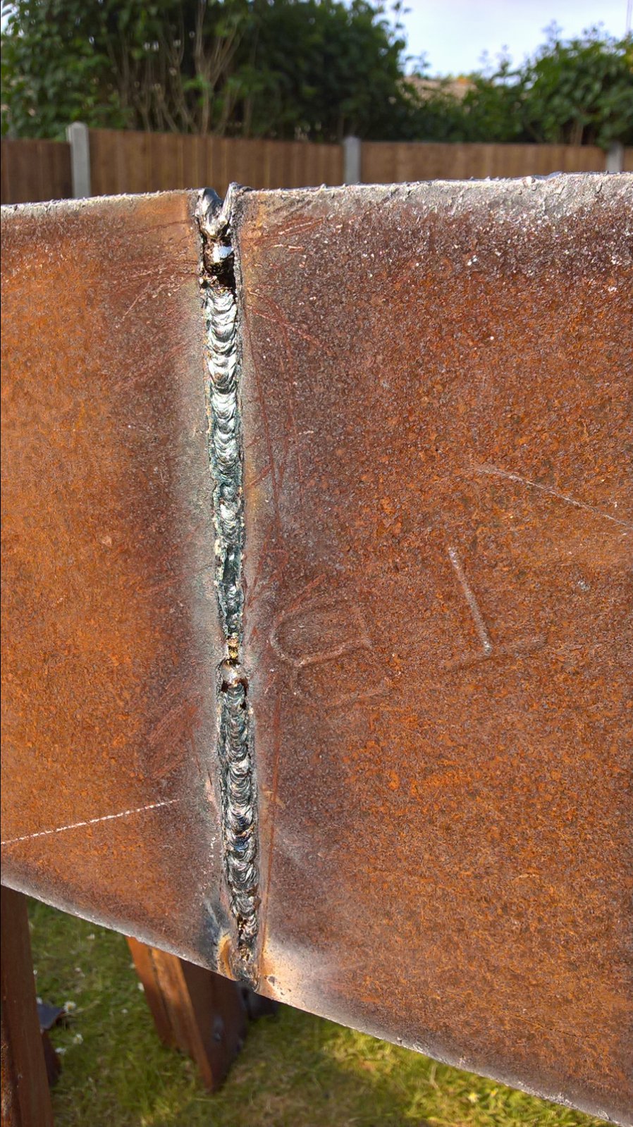

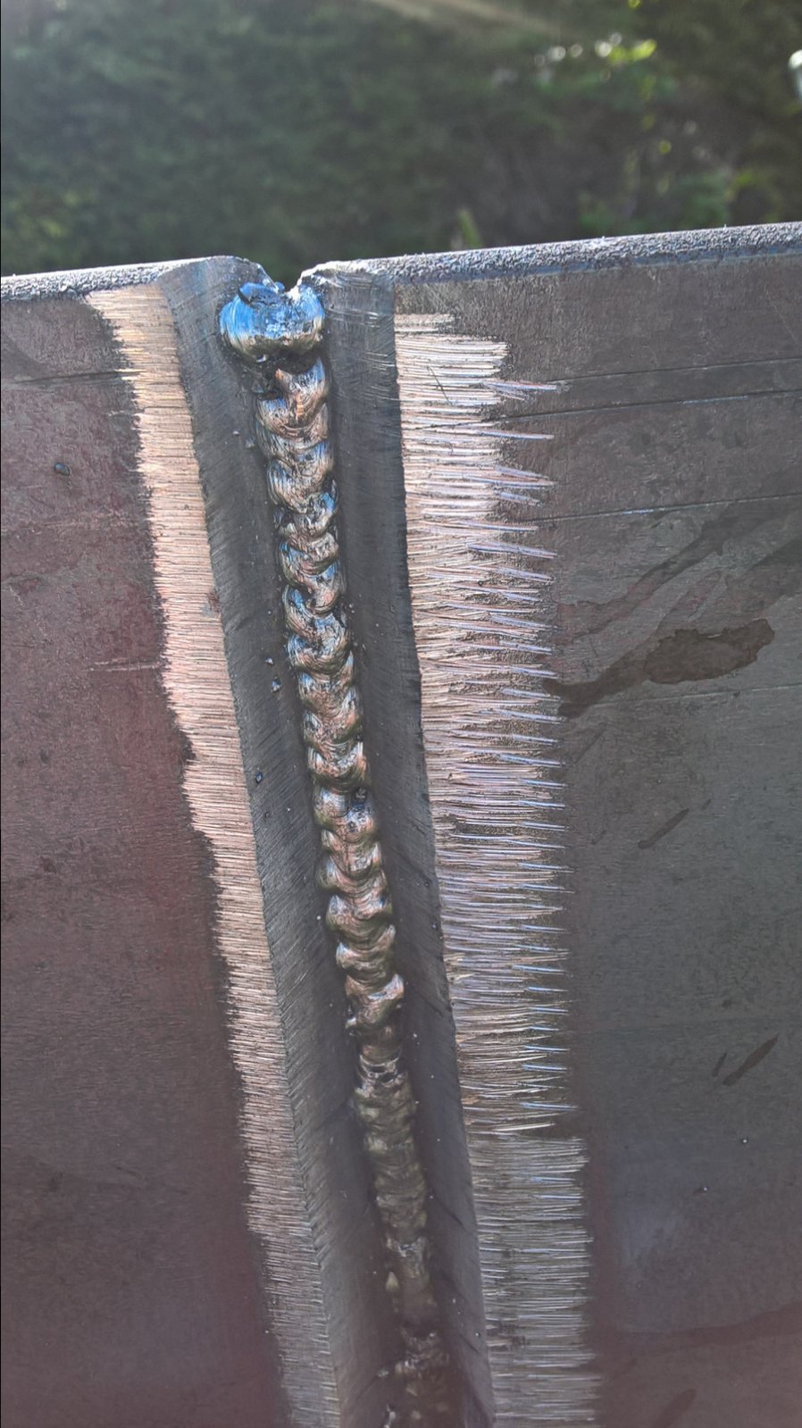

third

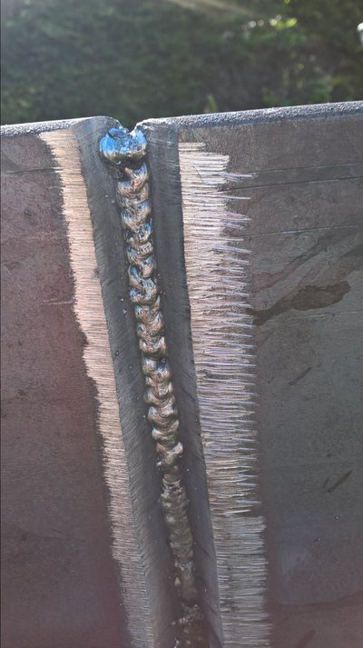

root 2.5 6013 fincord m open v up

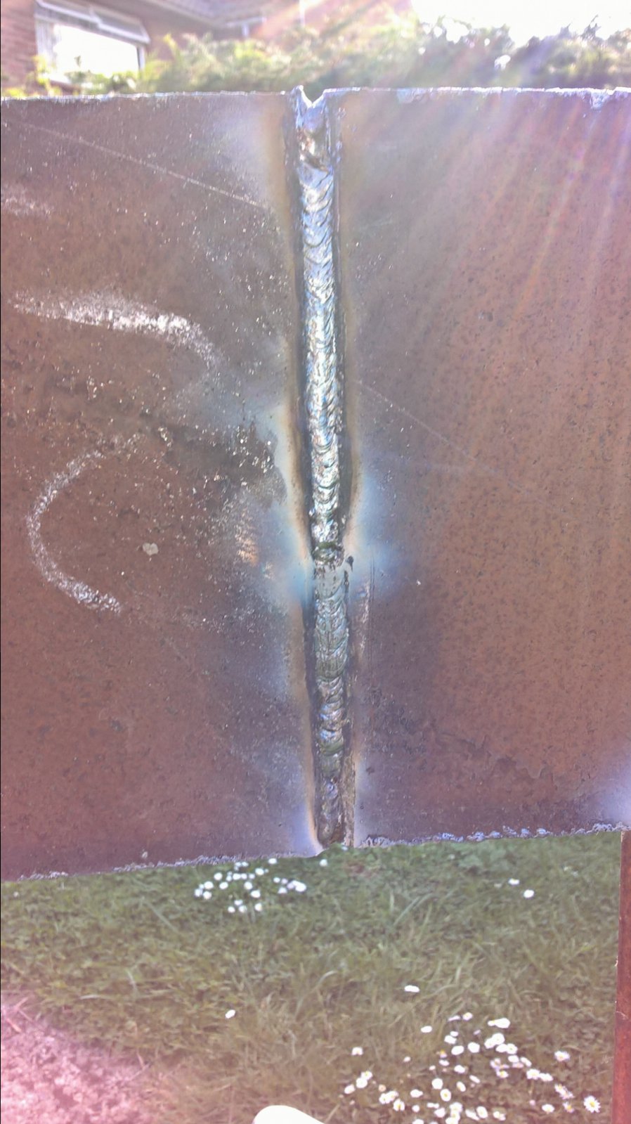

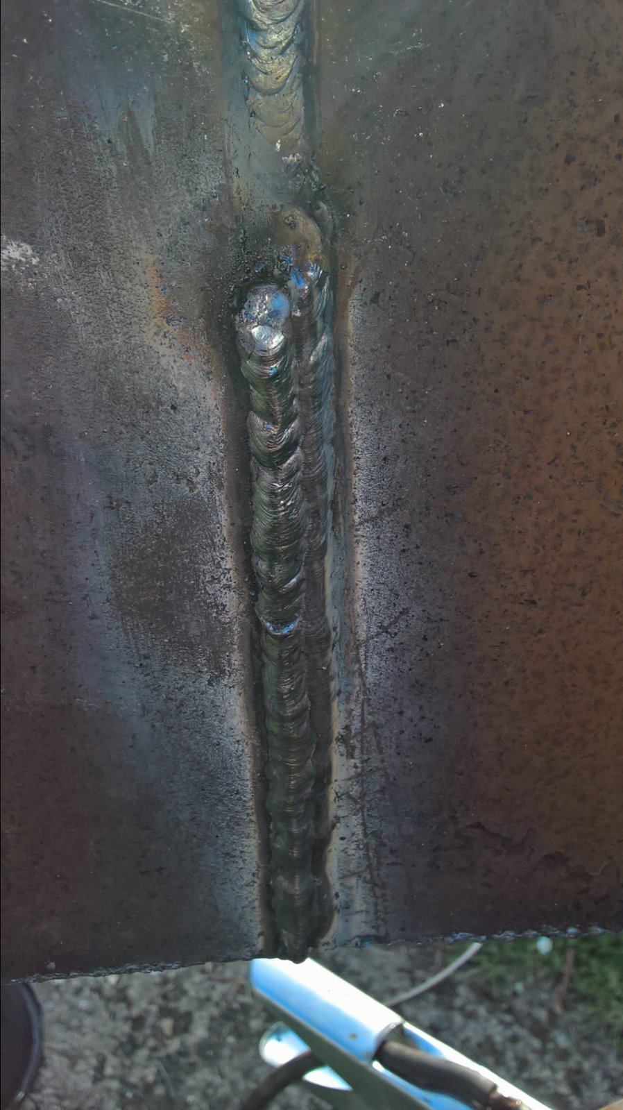

fill 3.2 murex 6013 110 amps
fill 3.2 same
final pass 100 amps

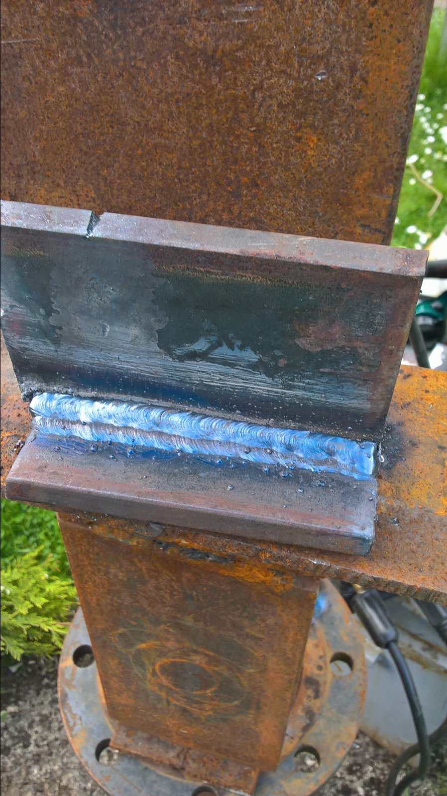

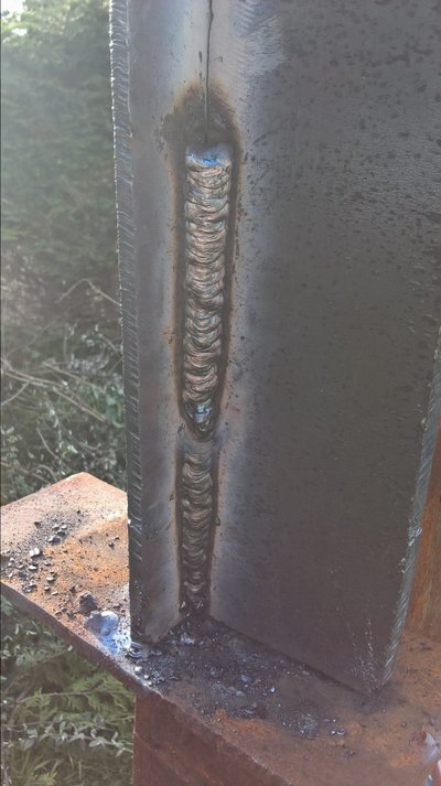

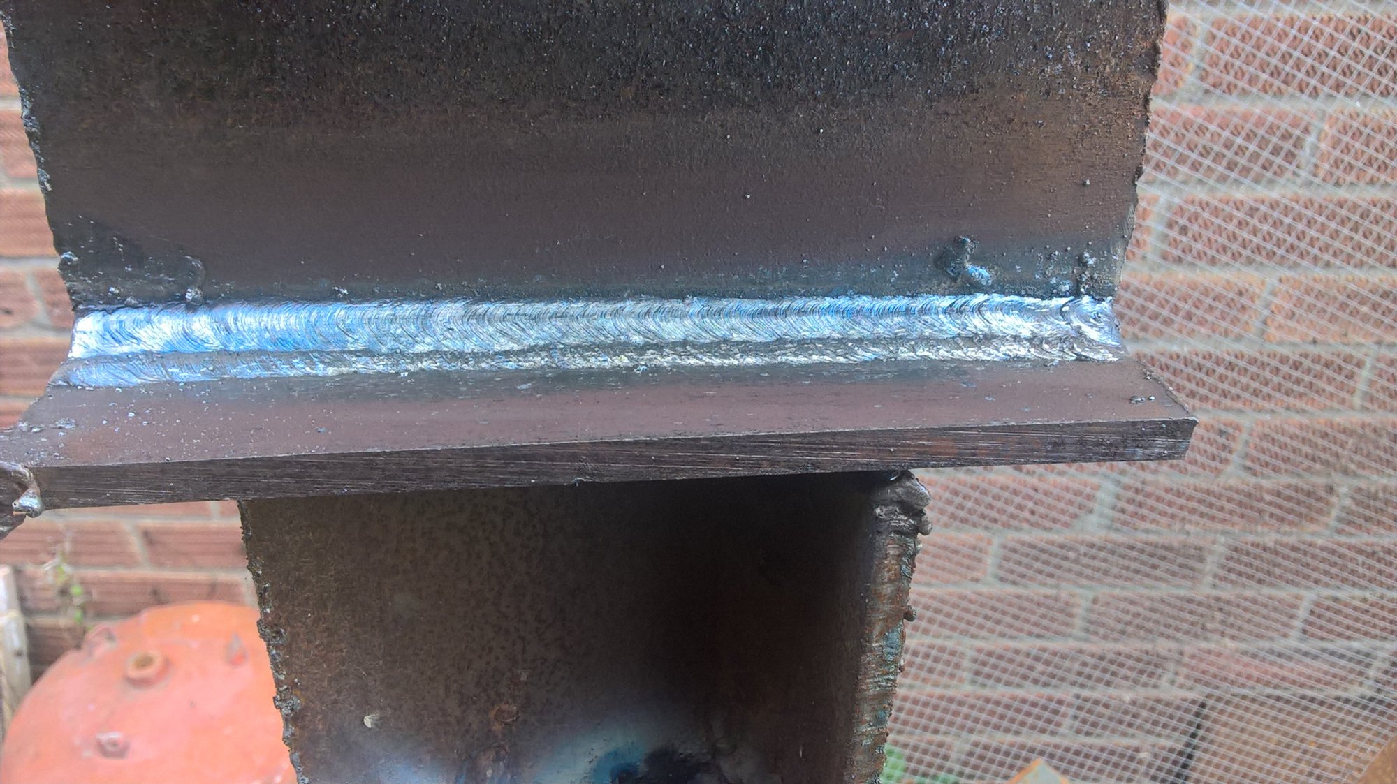

last photo

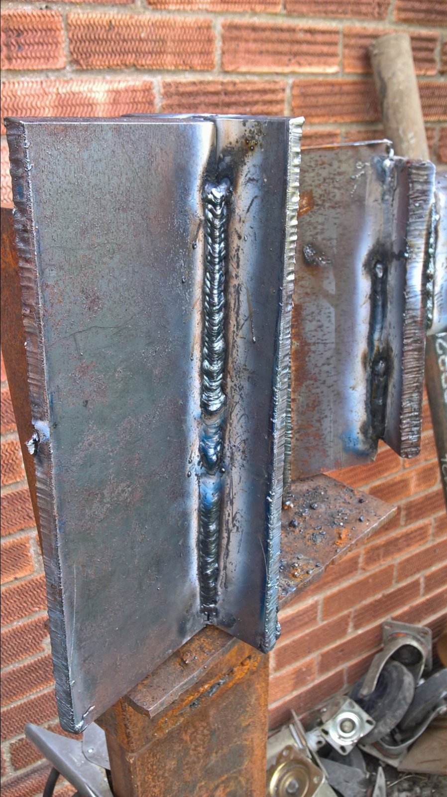

10fw 6013 3.2 120 amps 3 passes
