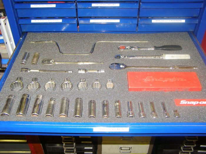

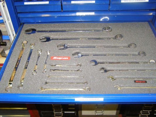

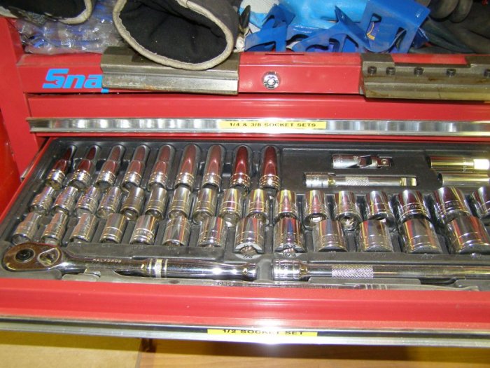

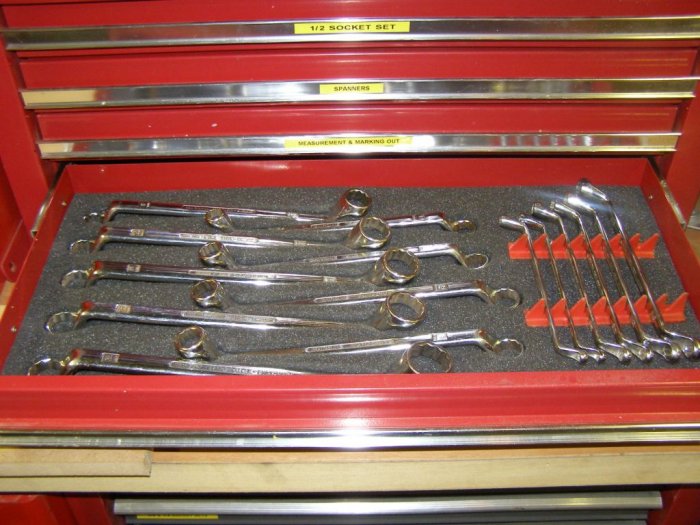

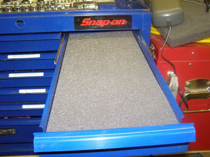

Was looking to buy some Foam Tool Control for my Top Box but it was very expensive even the DIY kit so bought some dense packing foam 25mm thick and some seating foam 6mm thick.

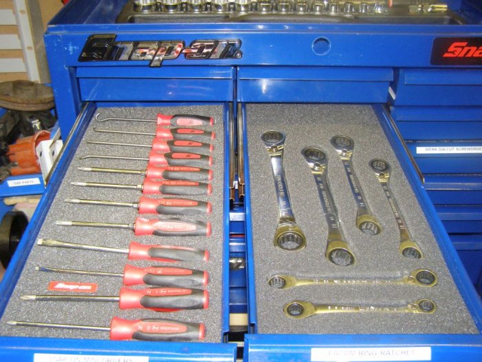

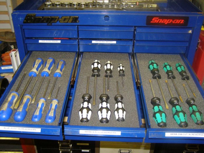

Cut slab to fit drawers, used stick back fablon to cover the foam to allow tool outine to be drawn, cut all the way through 25mm blocks around the tool and sliced the shadow part to the correct depth and replaced the bit in the cut out, when whole drawer was complete stuch the 25mm pad to the 6mm pad with foam glue.

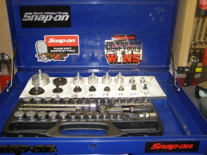

Some pics of the outcome with a blank drawer before cutting

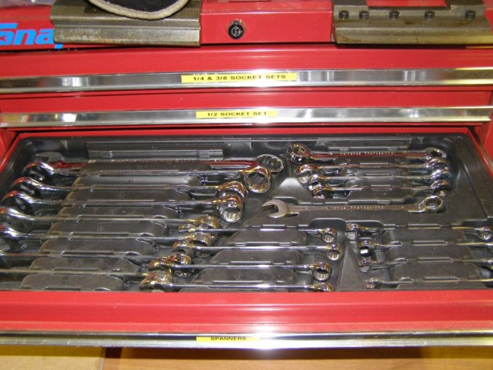

Top shelf the Hole punches and swagers still have the fablon on, socket set is in original holder.
