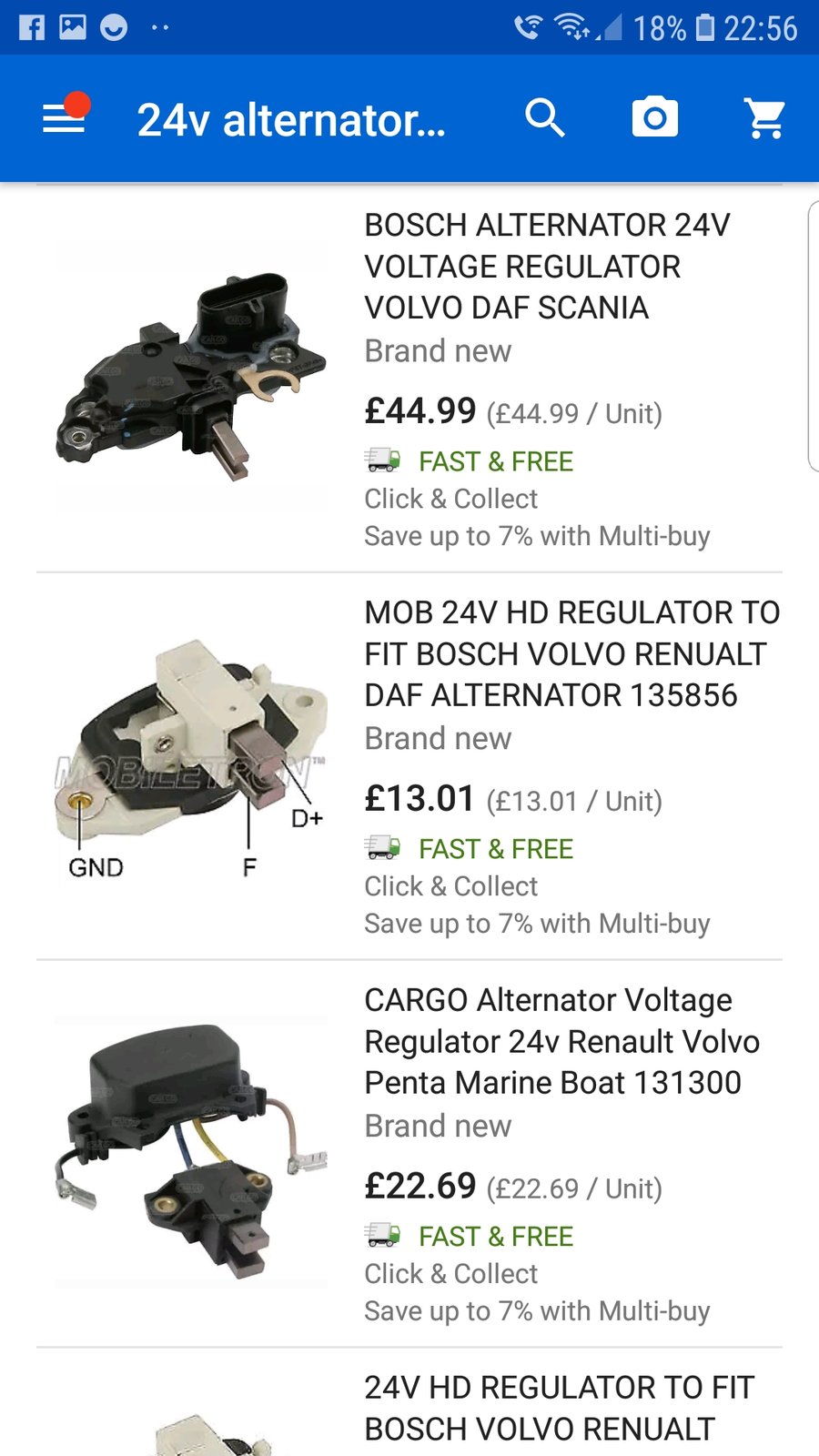

What method of getting 24v (I know 28v is really needed) do people recommend ?
At present I can see my options are
(a) find a 24v alternator (could be difficult)
(b) use 2 x 12v identical alternators in series (would that even work ?)
(c) use a 12v alternator then a 12v to 24v inverter.
Any advice, suggestion, opinions etc appreciated.
