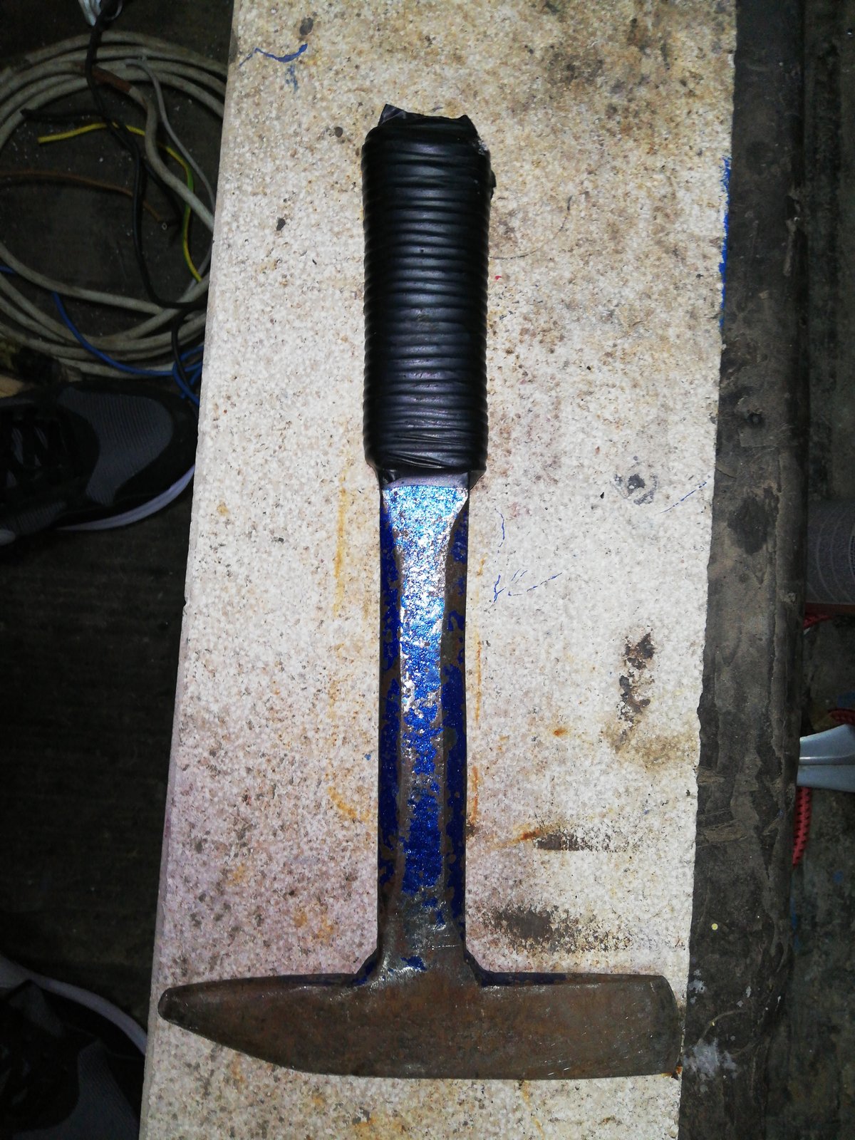

Hi everyone I'm seeking for advice about making a slag chipping hammer for stick Welding
I've already built one out of mild steel but it didn't hardened well .
I have always to sharpen it because it becomes dull very quickly
So happens to have some material here at home and I would like to have advice to choose the best material I could use
Two broken SDS Max chiesel bits that should be a particular tool steel that we call "acciaio per utensili da cementazione"
This material once tempered is very hard and wear resistant
CR-V masonry Chiesel
Broken file
I wouldn't like to use spring steel but I can get some from a friend

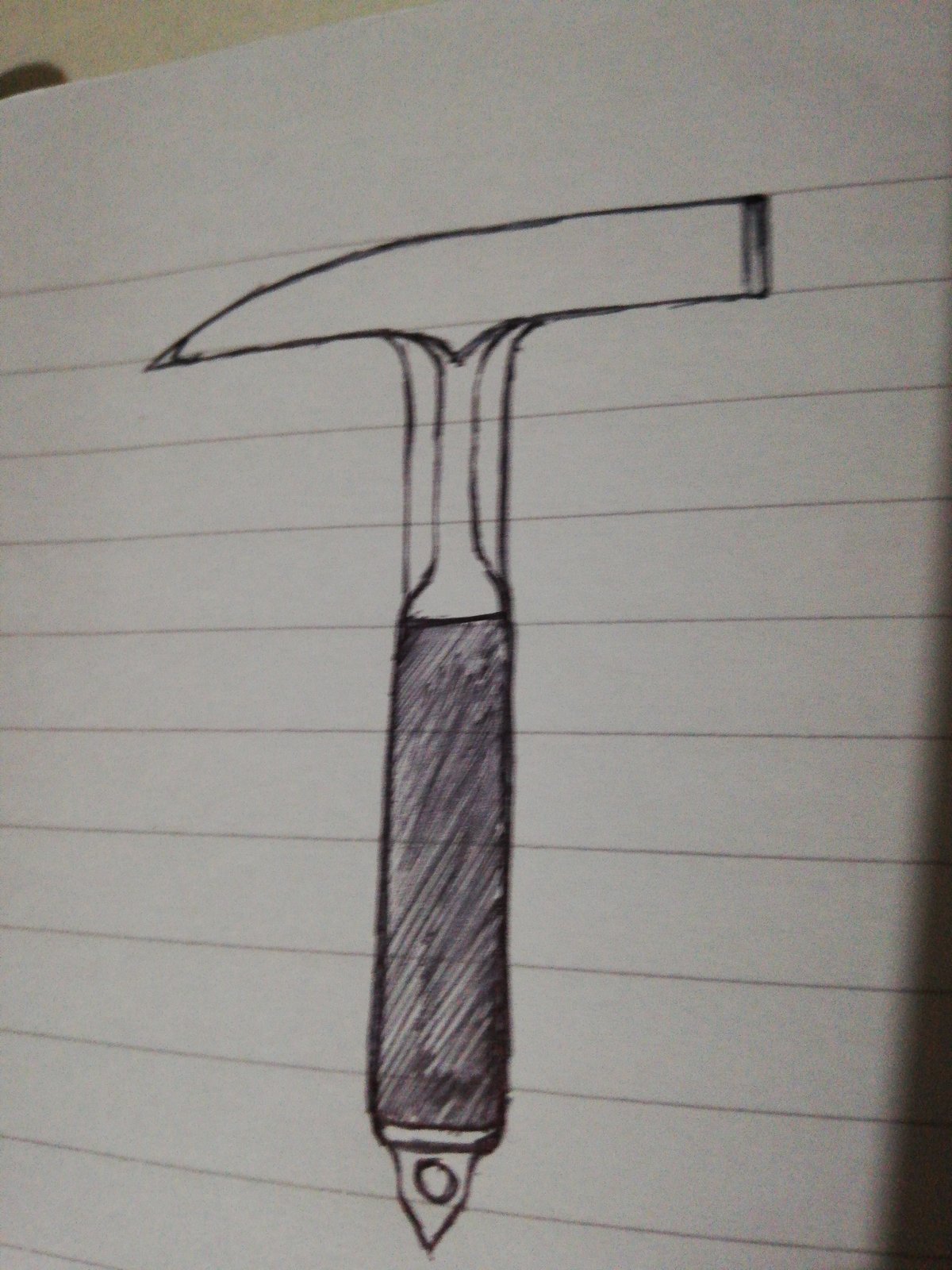

Construction,I am thinking to make a Tee out of mild steel(flat stock) an use one of the up-mentioned materials to make the cutting and pointed edges
Weld them together using 308L ,312L or 7018 also here I would like to receive advice about the electrode choice
I am also thinking about refacing the "head" using stainless steel rods (308 is cheaper) to add weight to it and also because I think that might be cool to see .
The handle I was initially thinking to make it just using a rubber hose glued onto the flat stock then some heat shrink tubing in it to be little bit nicer to see .
Thinking also to make an hole to hang the hammer somewhere or put a piece of cord ,cable or something like that if needed to prevent falls while working (not really working it's an hobby so is better say playing) on ladders, scaffoldings and things on those lines .
I want to make a drawing right now so you can understand better what I have in mind
