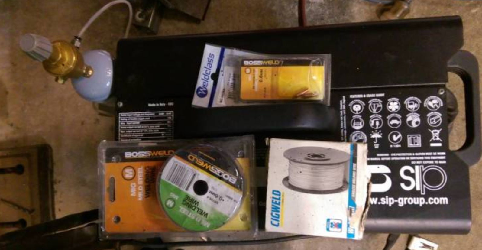

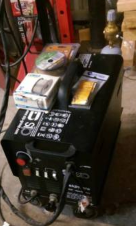

    I've been keeping an eye out for a 2nd hand MIG to get me started at a hobbyist level (mostly sculptura stuff), and thought I had found something today as the price seemed good and it came with a gas cylinder. But after having a look at a few threads around here it seems they are not very well regarded Are they really that bad and is this not such a good deal after all?
    https://www.gumtree.com.au/s-view-details.html?adId=1192028812
    BTW, I'm in Australia and that price is aussie dollars.
    Cheers

    Welcome to the forum.
    I would not say they are bad, they however tended to be not as good as many other makes.
    The wire rollers had a fair bit of flex and some owners complained of a lack of smoothness and consistancy in the weld, often this can be sorted with a bit of effort and there is a thread on the forum of an owner who made some simple modifications and ended up with a decent machine.
    Pricewise is hard to judge, we over here tend not to know what is cheap or what is expensive in the world of machines in Australia.
    I think the answer is if you want to consider the machine go and see it and make sure the owner shows you it working and producing a decent looking weld, if it can do that then it will probably be fine for your use as long as you are not going to be making sculptures of heavy steel.

    What Steve said. I started with a (slightly different model of) SIP Migmate 150 and it was fine for getting some practise in, plus I learned a lot about how welders work by modifying it!
    Some are very easy to do (like the wire roller brace that Steve mentioned) and some need a bit more electrical knowledge (like the dedicated wire speed transformer). But a new liner ($15) and a brace on the wire feed ($0) should help immensely.
    For AU$150 / £85 (and she says "negotiable") and with the gas and wire that it comes with, I think it's a perfectly reasonable way to get started. And there's plenty help available here if you get stuck :D

    Don't factor in the gas cylinder when deciding if it's worth what they are asking, the cylinder is disposable and you only get around 10 minutes solid weld time from one, they are an expensive way to weld

    Looks like a PD, though, rather than a disposable?
    Edit: looking again, I'm not sure - maybe it is a disposable... either way, it could have 6 grammes of air in it for all we know :D

    Due to size of cylinder against welder and the tiny regulator I'd still go for disposable :D

    I thought the bottle wasn't a disposable one and have asked for some detail. That was what originally sparked my interest. What do you make of te regulator - can you tell much from it?

    Yeah...it's useless without a flow gauge, something you really do need for getting things right.

    I've found most of those regs to be pre set, just op n valve and off you go for 10 minutes if you're lucky
