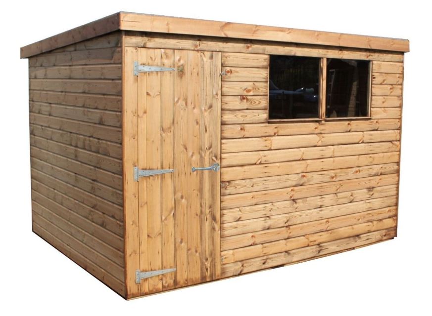

Following on from my thread about shed types I've decided on a 10' x 6' wooden shed so thought it worth starting a new thread which hopefully will be completed in a few months.
Like this, but without the window.

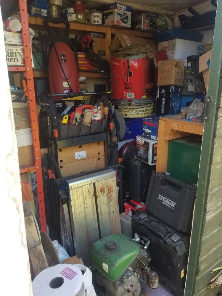

My current shed (8' x 6') is a bit full
I started moving stuff out to store in the garage and found the roof had leaked during the heavy rain we had over last winter
so some stuff has been ruined, other stuff won't go back in the new shed as it will appear in the "for sale" & "freebies" section of the forum.

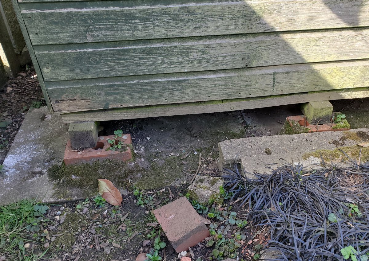

The current shed sits on mixed concrete and flags which is sound but not flat so I leveled the bearer supports with bricks set on varying thicknesses of slate and mortared in.
I want to get rid of the bricks/bearers and have a concrete base 3.2m x 2.2m about 50mm deep poured and leveled so using online calculators worked out I need 0.352m³ of concrete.
