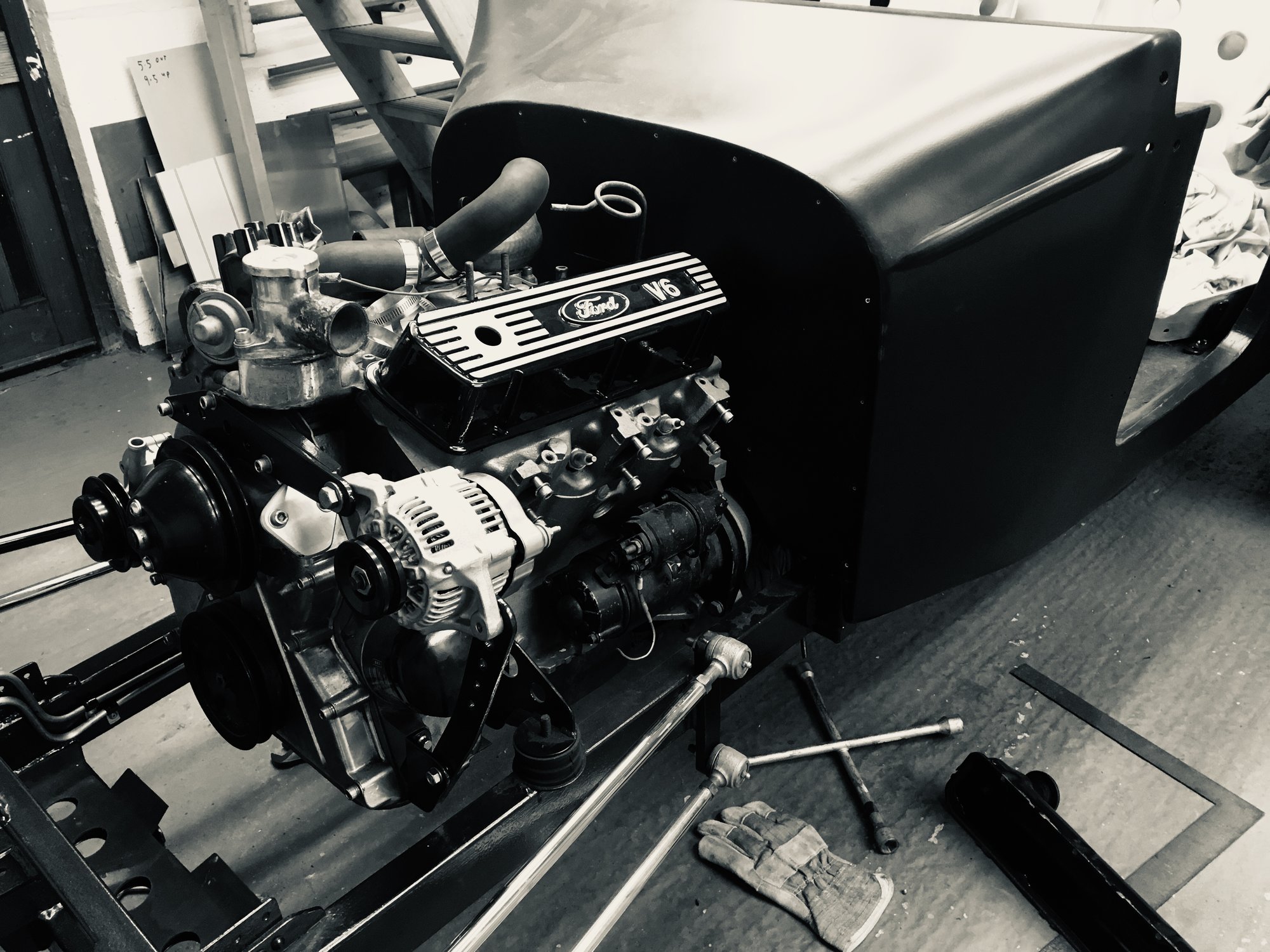

I have a Scimitar in that I bought because the PO had nothing but trouble with it. I bought it off him expecting to turn it around quite quickly after doing one or two little jobs. Not so, it has fought me every step of the way and it is still cluttering up my yard.
Main issue is that of a resonance vibration. You can feel it at idle, but raising the revs really provokes it and the whole car shakes. I have had the engine out twice and stripped / rebuilt it with no fault found, although I did renew the piston rings and core plugs last time. Bearings are all in decent nick and there is no excessive float anywhere. It isn't misfiring, All electrics have been replaced and tested, the carburettor has been substituted with no change to the symptoms.
The car is fitted with a C3 automatic box. It occurs to me that the vibration is just like an unbalanced mass attached to the flywheel. Now I can't see any way that the torque converter could cause it, unless physically damaged. One useful test would have been to uncouple the torque converter from the flex plate, but on the C3, the bellhousing is too small to allow them to fully uncouple. The flex plate has recesses in it for the TC studs, it's that tight in there.
Any opinions before I haul it out for a third time?
