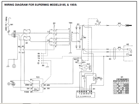

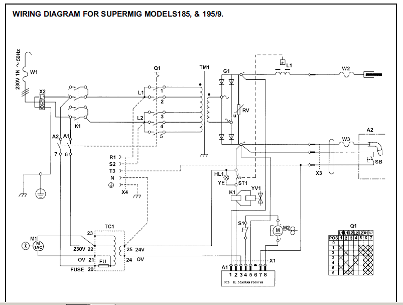

  6. mike 109444
    mike 109444 Member
    Messages:
    4,296
    uk Bristol
    FYI schematic and manual
    a111r likes this.

  10. a111r Member
    Messages:
    888
    Location:
    London
    Thanks Mike, I've been using that diagram all along. As a mech eng, it's not too useful as a diagnostic tool.

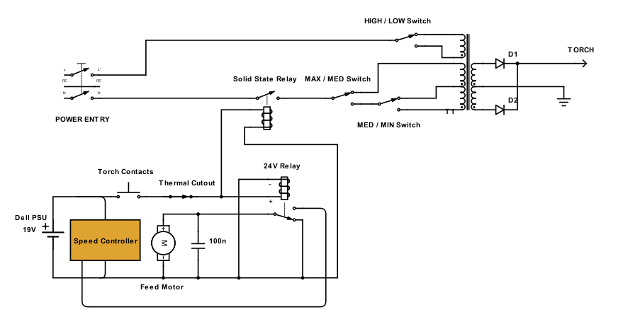

  14. MBB Forum Supporter
    Messages:
    1,127
    Location:
    northumberland
    This is a diagram from charliecambs earlier post he used a power supply from a dell charger it may be of some use. The charger is only 19vbut there are plenty 24v ones around. @charliecambs

  15. a111r Member
    Messages:
    888
    Location:
    London
    Thanks. I recently used a Dell 19.5 volt SMPS to upgrade my old SIP to a separate feed motor power source, a common mod.
    The big aux step down transformer that's failed is prob 100VA, so I'll look for something of a similar size. Sealey want £120 for a replacement...
