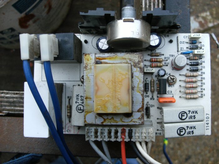

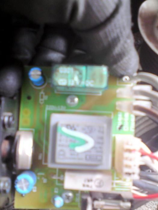

Converting to euro connector which has 2 black wires ? Where to connecy , on original lead 1 red wire connecting wire feed motor to torch any ideas sealey 180 supermig
Regards bob
The simplest way imo is to connect one of the euro wires to the original thin wire and the other to the thick wire thereby replicating the action of the original "switch"...
