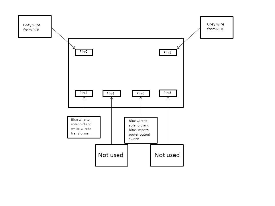

    Well had another good look today and i think its going to be the skip for this as i cant figure it out. Thermo switch is ok. The thing that i cant work out is the contactor is operating but nothing seems to be coming out of it even to operate the gas solinoid. Ive taken it t pieces and cleaned all the contacts and its made no difference powers going in but nothing out. Trouble is the only place i can get a contactor is china so that could take a bit of time and dont know if its worth spending the cash. My other option is a repair shop but that could get expensive. I between that its the contactor or possible transformer as i know these some time go. I tried all posistion switches and still nothing. Is there a way to bypass the contactor or to test it properly. This also no continuity accros the spades of the contactor when i press the contactor by hand. But then again i dont actually know if im testing it right. This is a diagram of the contactor. Presumably that when i press contactor i should get continuity between pins 0 and pins 2, and then pins 1 and pins 6. This is the actual contactor. https://www.ebay.co.uk/itm/HLR6100-...487867?hash=item2f30ff1afb:g:Y7wAAOSwgENeEpz-

    The relay coil, which apparently runs on 24v DC, should get power from the PCB on the two grey wires at Pins 0 and 1, when the torch trigger is pressed. It does click, so that must be OK.
    The relay has two sets of contacts, which close when the coil gets 24v power or is manually operated, and they are 2 to 4 and 6 to 8. The outputs of these contacts are Pins 2 ( to solenoid, and to main transformer ) and 6 ( to solenoid, and to power range switch - probably then on to the transformer ). However, from the eBay listing for the contactor, the inputs to those two sets of contacts are Pins 4 and 8, and yet they are not used ? There should be AC mains going in to 4 and 8. Are there any "spare" wires with push-on tags lying loose in the area near the relay?

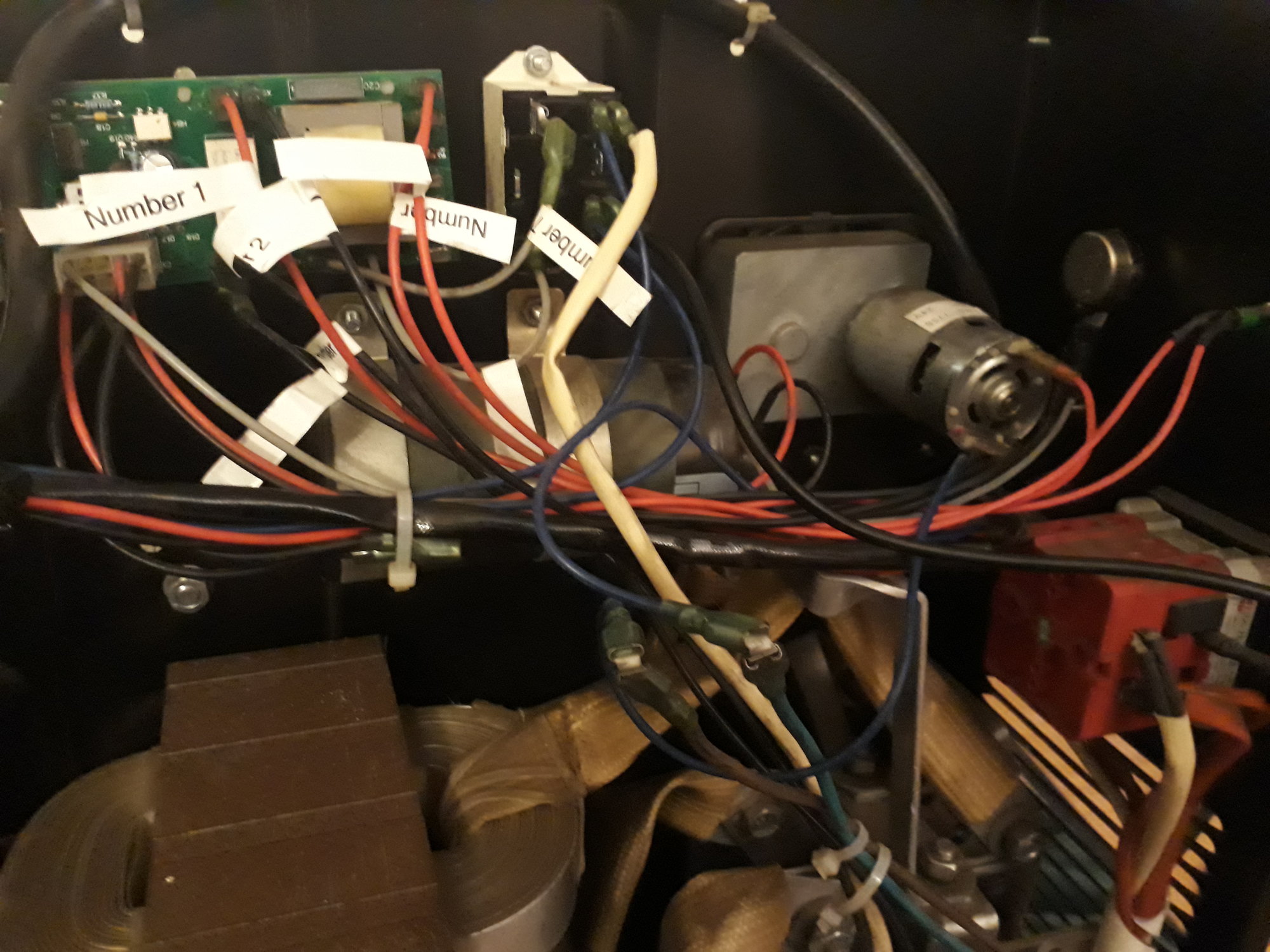

    Thanks eddie49 for the quick reply and you are right and the answer was staring me right in the face and you can see exactually what has caused it. The main power lead coming into the welder has obviously got caught when someone has tried to wheel it away and it had pulled the wore and both connectors out of the contactor and pulled them down so there wasnt enough wire to be abe to reconnect them up. So loosened the grommit pulled them back and plug them and all is now good with the welder. You can see them in the photo half way down the screen, because they were all the way down there i just thought they were joining two wires until i read your message. So a big thankyou from me and the welder lives on.

    From your photo I can see that the push-on tags on the mains lead were siamesed with the wires that run the small transformer on the PCB, which would explain why power was still available to make the relay click.
    I am pleased that the welder is working again now.
