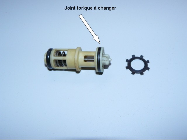

Loads of trouble with my 2000 Saxo lately.... god i hate french cars....(sorry Malc )
It has a lot of air in the fuel system lately (diesel), i had a small hose repaired already but it still has trouble with the cold start...stuttering, smoking and all that...
Any ideas....please!!!! Help!
(it seems that it's a known problem for saxo's, it should be a small sensor on the back of the fuel filter housing with 2 o-rings that could be worn out....)
Anyone ever repaired this successfully? Could i do this?
Here's a pic of the thinghy in question:
The tricky part is how to remove the dented ring...
ps: sorry if i have some of the technical terms wrong...i do my best!
