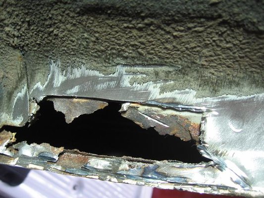

The first on the list is the RHS sill:

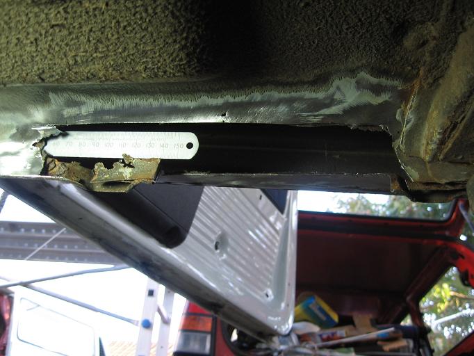

I've been cleaning the sill up and I'm not sure how to approach welding it.
Most of the rot is in the lower part of the floor and inner sill.
There are patches of rot on each side of the jacking point.

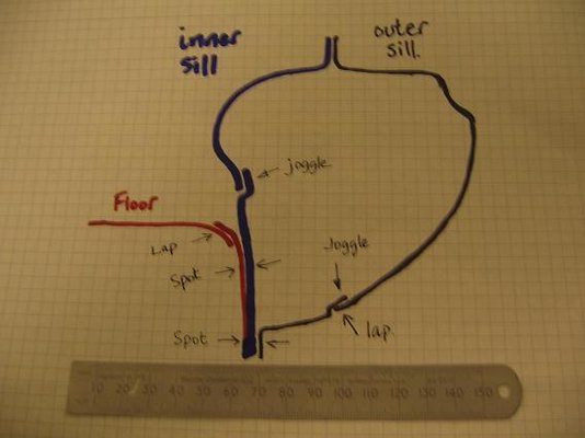

The original floor & inner sill look as though they were spot welded together, then the outer sill welded to them.

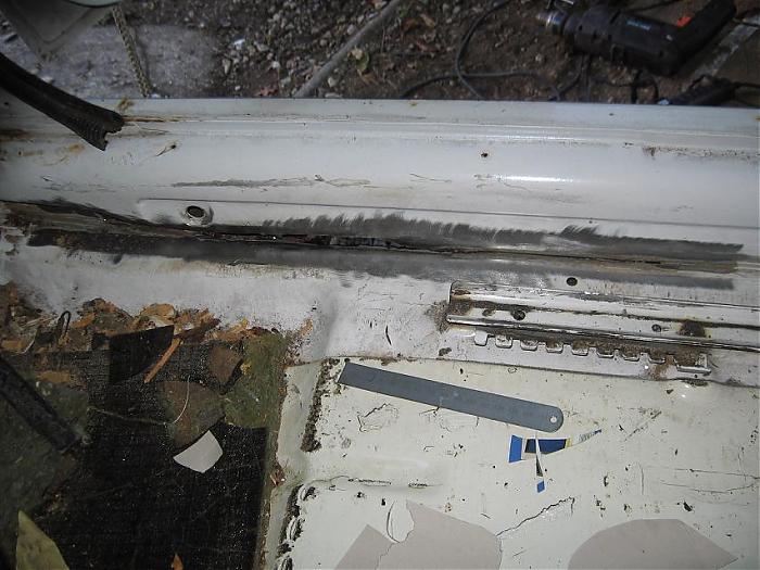

Floor & Inside Sill
Since this is covered by carpet - this doesn't have to be beatiful.
I figure that I need to fabricate the inner sill and floor parts and jiggle them into place. I can get a weld onto both sides of floor lap joint, but can only do one side of the inner sill. I'm worried that this will be a moisture trap.
Where the outer sill needs reaplacing I should be able to get some under seal on it.

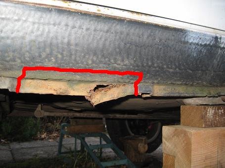

Outside Sill
How do I reproduce the drain holes in the outer sill?
Are they really nescessary?
Should I try and save them and cut & weld them into a new fabricated patch?
It it easier to use a sill skin and cut out the bits I need?
