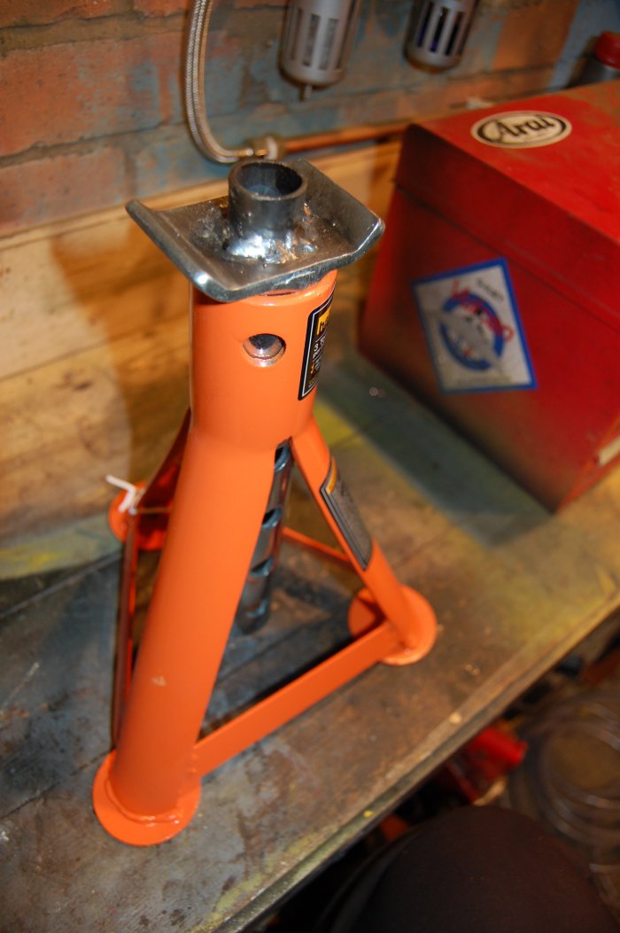

A quick trip to halfords and I was the proud owner of a new set of 3 ton axle stands. A quick stop at B & Q and I was also the proud owner of a metre of 25mm x 1.5mm steel tube.
Half an hour later and a short length of said tubing was welded to the top of an axle stand.....et, voila.....
The 'adapted' stand fits snugly into the hole in the jacking point and, with it in place, and the full weight of the car taken by it, the car is solid and stable - giving me enough confidence to work under it.
