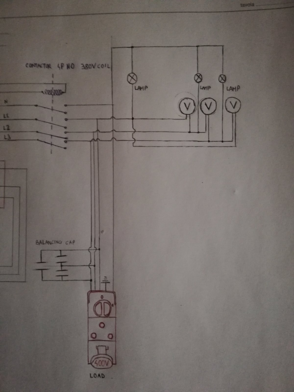

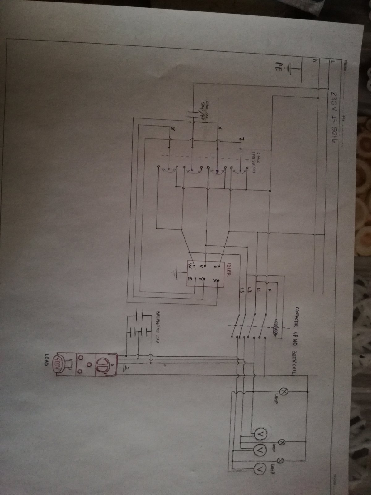

I spent my afternoon today to draw a project
This is wiring diagram of how I see a rotary phase converter and that's the way I will make two of those
One is for me one for a friend
I hope this can help someone here and this is a little part of what I would like to do to say you'll thank you for all the help you gave me in these years on this forum
I would like to see a day a section on this forum dedicated to share plans only
I will make new project and wiring diagrams to share with you all in the future
Ps the switch isn't a 2 position as I wrote in the diagram ,it is a 3 position
1-0-2
