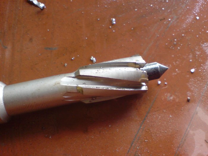

I have a contract starting soon where we will be drilling hundreds of holes 30mm diameter through 45 mm thick S355 plate.
I cannot decide on standard cutters or M42 cutters or TCT cutters.
Any of you guys had experience in these higher grade cutters
Rotabroach bits will work but it will be a slow process, might be cheaper to contract it out........just a thought. Maybe waterjet may work although I have no experience of this.
I,ve used the tct and normal cutters i found the tct cutters are best for thick or hard steel best used with a slow speed machine and plenty of cutting fluid.
I would use tct will do job just fine.
