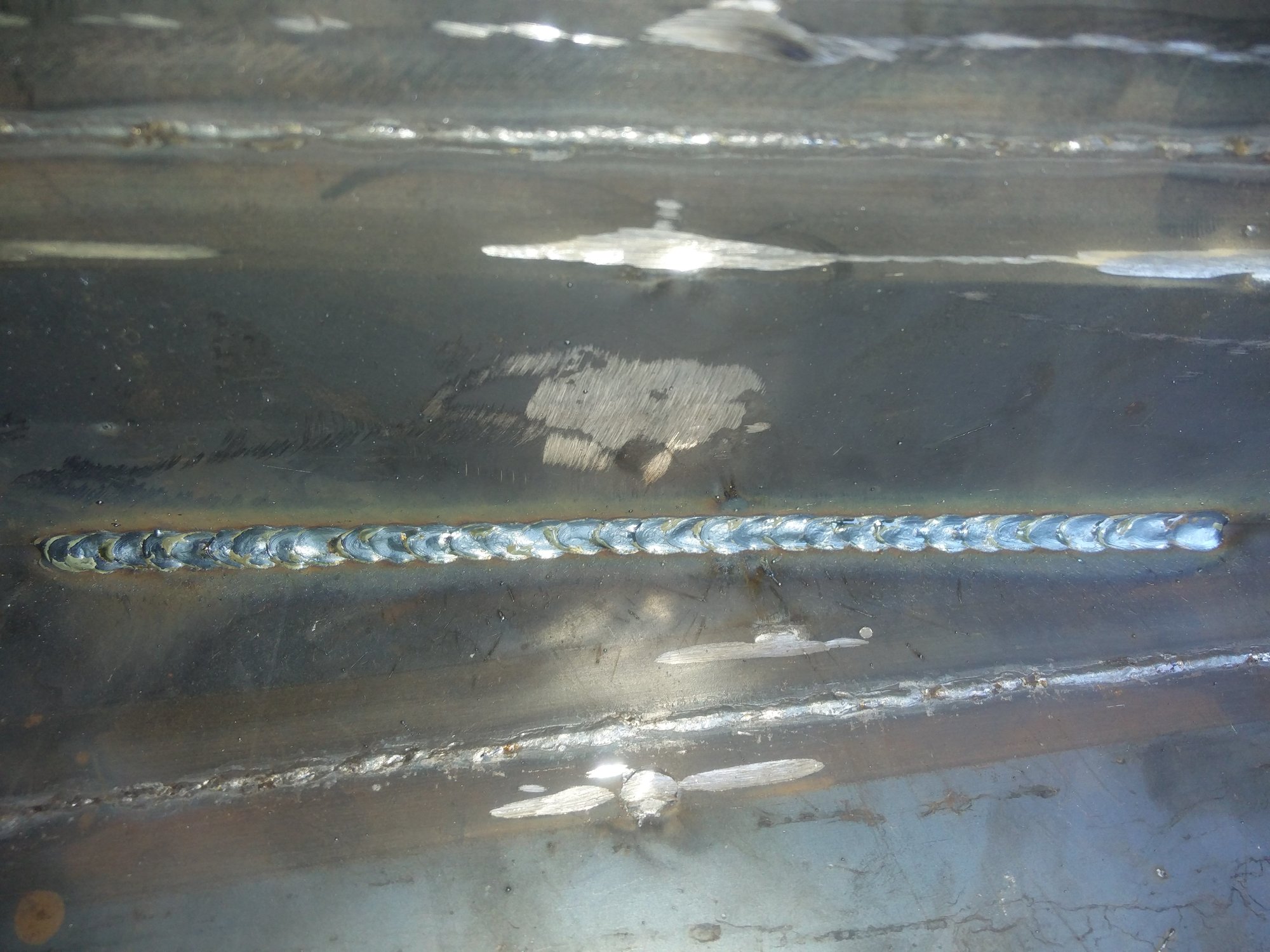

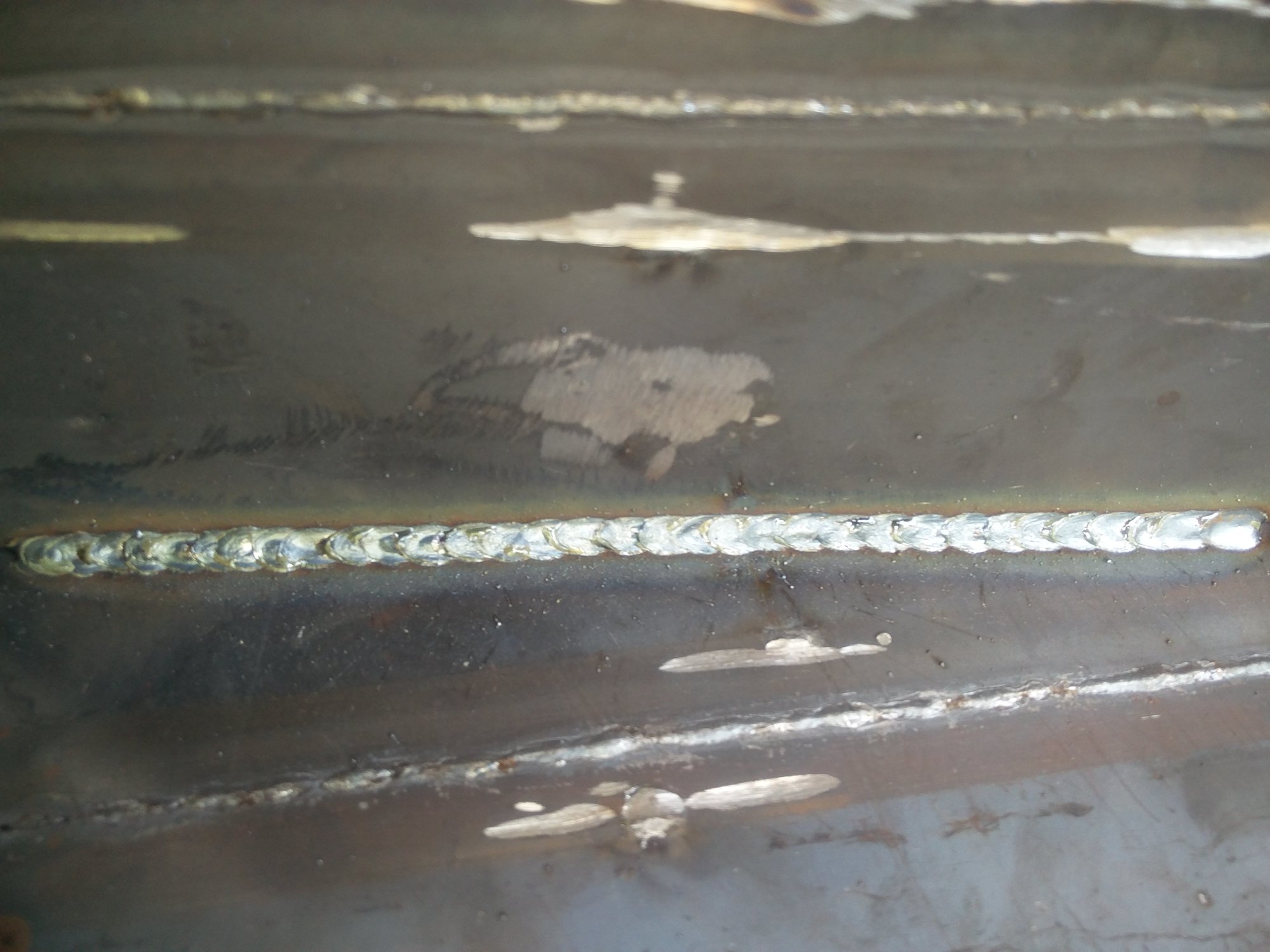

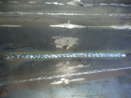

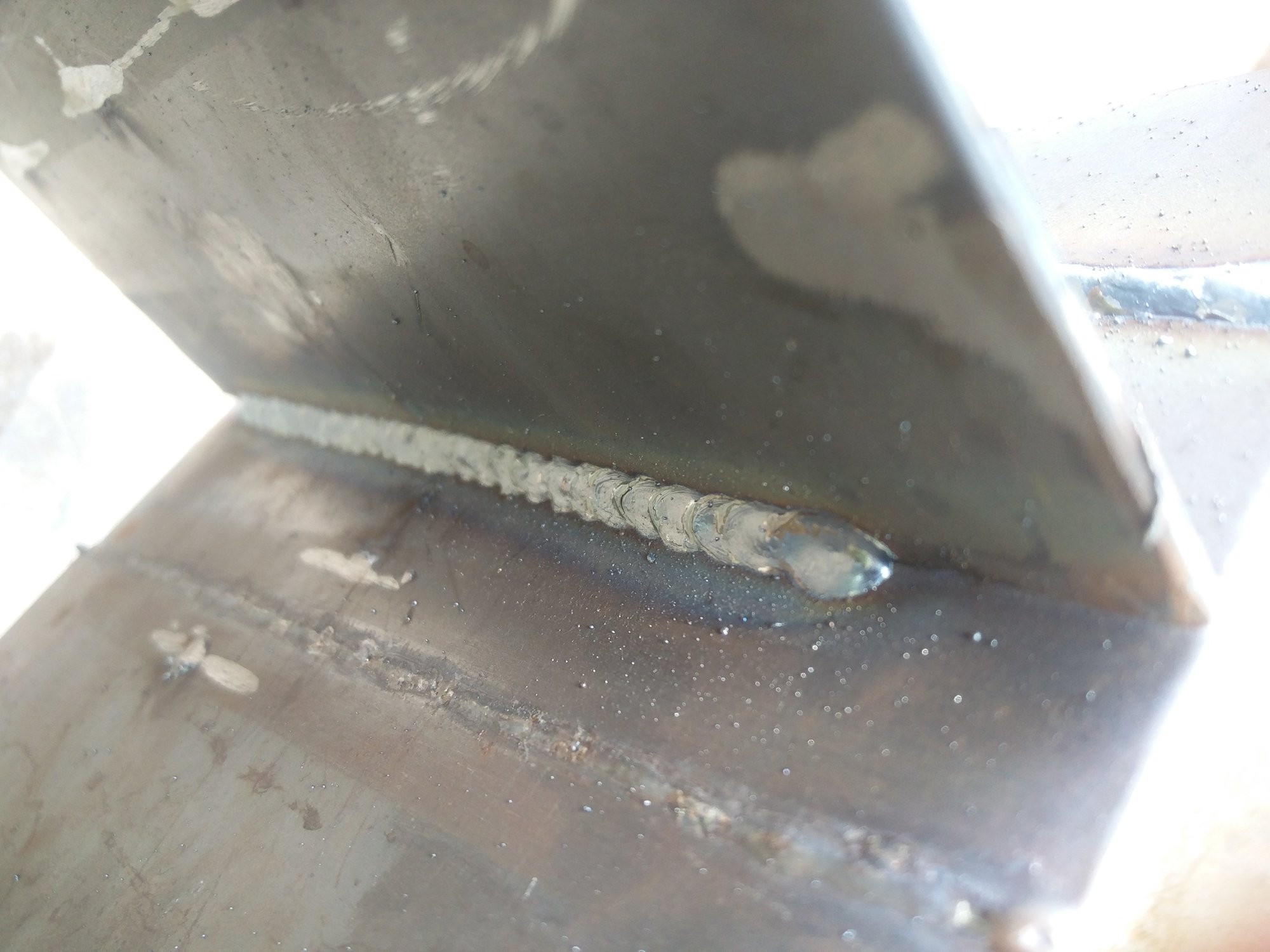

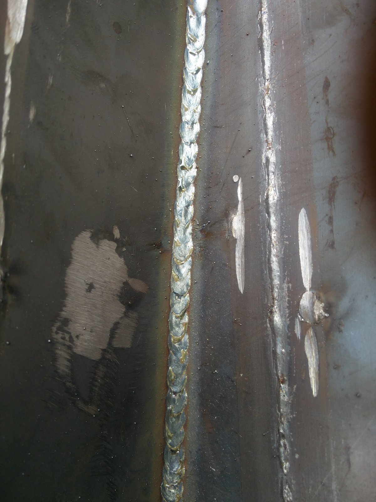

    Dear experts I have been getting continuous ripples formation of MAG welding of Carbon steel grades. I would like to know information regarding any kind of acceptance standards available which deals with the ripples in Welding so I can adjust the torch angle to reduce the effect. Thank you

    Really depends on your description of ripples, a photo of your welds would help identify any problems you are having.
    Also the make, power output, model of your welder and the material you are attempting to weld?

    Respected Sir
    The material is EN S235, thickness 2.5mm, current - 130A and Voltage - 21, model Esab Auto K 400, CO 2

  4. That looks to me as if it has been welded using a backwards and forwards "sawing" motion, if it was a critical weld I would be suspicious as to it's quality

    Waaaaaaaay too cold and way too much wiggling going on. Just hit the button and go from a to b.

    Adjust your torch angle to around 90deg. No back and forth motion, no side to side. Just a smooth forward motion.
    Will be a start, can adjust your parameters from there.
