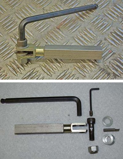

mine just has bright solid bar. but it is the same one that paul is talking about! not got around to finishing it yet
I've never seen a professional ring roller with knurled rolls.
I've never seen a professional ring roller with knurled rolls. With the force involved it would leave an impression on the material. Not sure they need to be hardened either, would make them prone to breakage. Don't think ours are hardened. When i made the one i used to have i used bright solid bar - reasonably regular diameter and a smooth finish. 3 short bits from Metal Supermarket or similar should do?
There's a fella on ebay selling plans for folders and ring rollers. Not sure if he has any on at the moment but i keep coming across him when searching for things!
The places that sell the machines will also sell various dies, usually custom options too. You don't want to know what Ercolina charge for radiused dies but cheaper options would likely be Baileigh for example... http://www.bifabuk.co.uk/benders/rollbender-tools.php or Stakesys... http://www.stakesys.co.uk/product/custom_roll_set_for_sta149/
Usually cheaper to find a tame machinist or you could buy/make a radius turning attachment for the lathe
