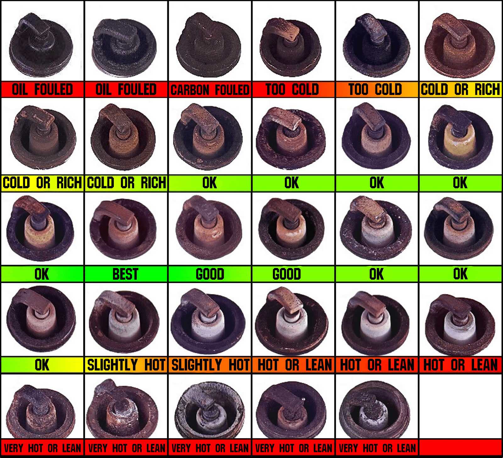

    Weird, I just learned this trick off an old boy last week - yet to try it. His reasons, the ethanol eats my carb parts, and if you want to tune using a chart like the below, the colours aren’t the same with today’s fuel.
    The food colouring isn’t needed, it’s pretty obvious where the water lies.
    Opinion on another forum was that you lose octane points.
    Didn’t know about the BP though, that’s handy.
