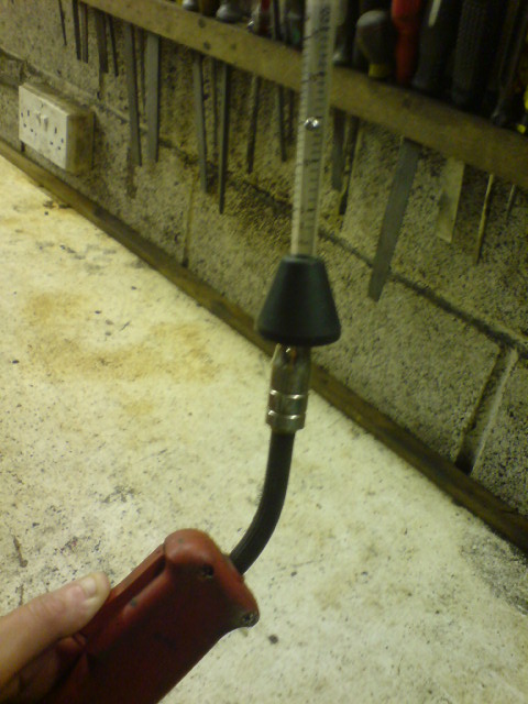

Also ignore the gauge that is supposed to display the flow if it's a dial type - they lie 97.52% of the time and aren't worth having anyway.
I'd use the fixed co2 one you already have and add a real flowmeter.
Indeed posted wrong link.thats for connecting a CO2 regulator to an Argon cylinder
easy enough and is the flow meter just left hanging somewhere or taped to the bottle
