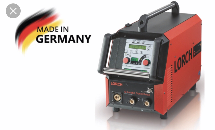

    Yes the Lorch S3 mobile is the perfect spec as a replacement for the sp320.
    It’s the same machine but with heavily revised software and massively improved pulse processes (Speed/Twin pulseXT)
    https://www.mig-welding.co.uk/forum/threads/lorch-speedpulse-xt.62383/

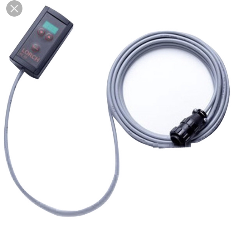

    The RC20 control can offer the full adjustment scope on amperage(WFS), voltage(arc length) job selection and dynamics. Can also be fitted with a top button for starting the arc.
