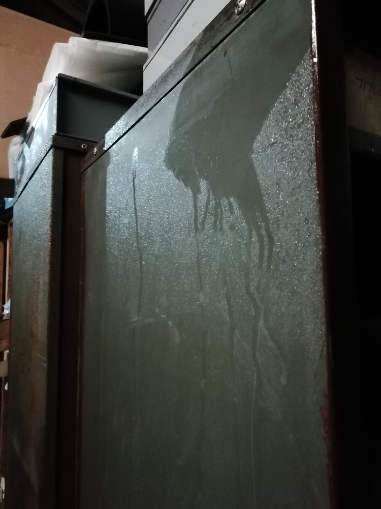

It looks like the rapid temperature increase today has caused condensation in my workshop which has never happened before.
Mine is built from insualted panels so I've never had any problem with rusting even in the worst weather and I've got a lot of bare cast iron stuff in there. I just went out there this afternoon and straight away noticed a rust-coloured sheen on my 8" lathe chuck on the lathe. I wiped it over with my hand and the whole chuck has a damp film of condensation on it. Looked up and the whole ceiling is covered in fine droplets.
I've just spent an hour wiping off cast iron stuff like straight edges and reference squares, and then misting them all over with 4 cans of water displacer. If I hadn't gone out there today I'd be crying in my beer becaus some of this stuff would be easily ruined if it got rusted.
I'd advise anyone to check their own workshop if they have stuff out there they don't want to rust because I've never had the tiniest bit of condensation until today.
