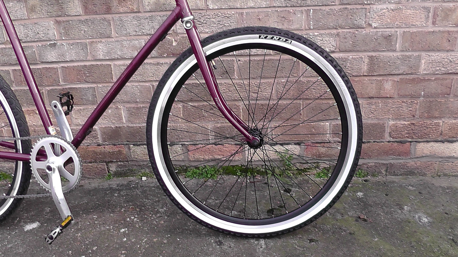

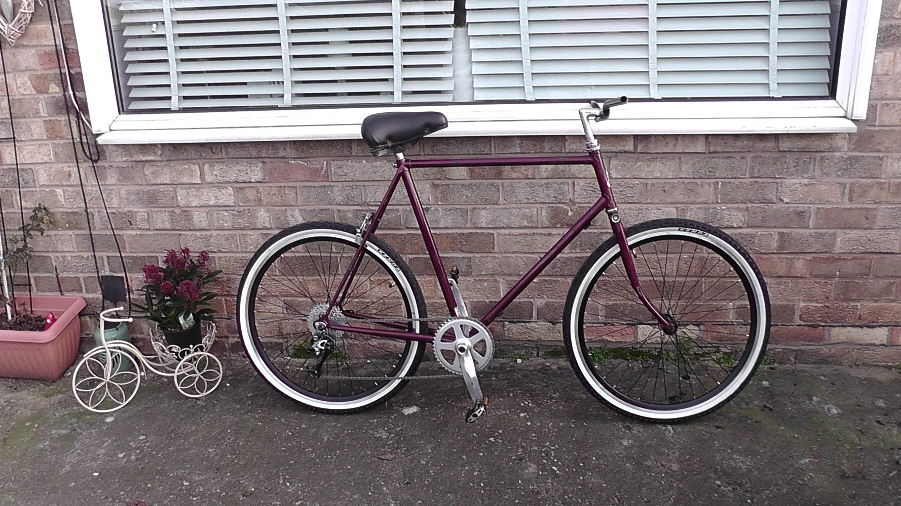

Like all good projects, this is nothing like what was originally planned, the Esquire frame was too far gone with rust and damage, so I'm using the Courier frame instead.
Special thanks to @Tangledfeet for sending me a big box of bits, some of which are on this project.
I was looking to build a sort of general purpose bike, kind of vintage but I'm a fan of modern tyres and gears. I acquired the 2 Raleigh (plus a 3rd girls type) for very cheap, stripped them down and wondered what to do.

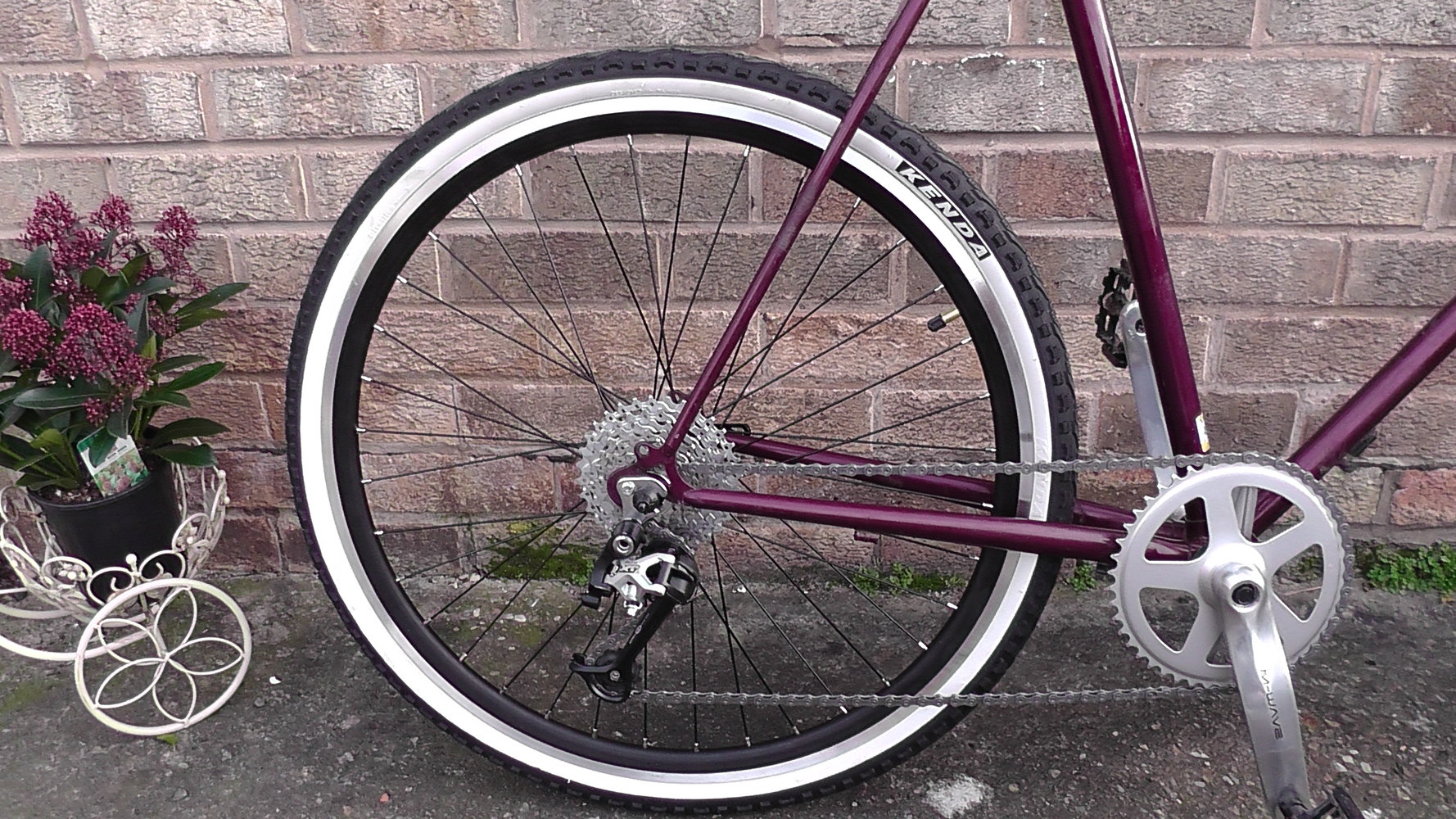

This bike didn't have a derailleur so I had to add a hanger, I could get one with a built in hanger but I wanted to use this 9 speed, I also put a washer behind the screw to stop it hitting the cassette
Quick test fit, the derailleur and cassette have been in the degreaser over night

And the crankset on
Followed by the chain and a modern but vintage looking pedal that I think will suit the bike
That is it for now, I may swap the bottom bracket for a narrower one if I need to improve the chain line
