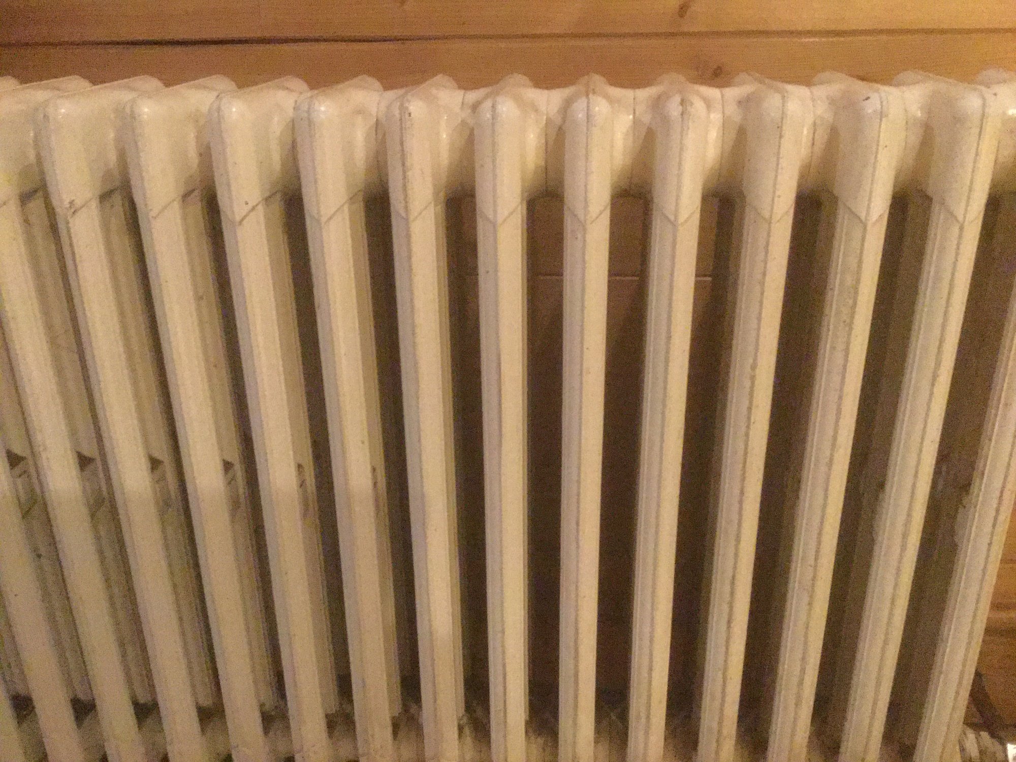

I used s/h cast iron rads from a school, the plumber piped them all up to test them and they were then sent off for blasting and painting. They just had the one thin coat of high temp metal paint sprayed on them, the difference in output after they had the paint stripped off was very noticeable.
Still good thirty years later and banging out the heat, I reckon the less paint on them the better . Not bad for rads that are over fifty years old
