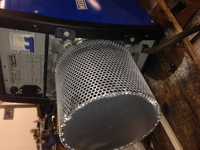

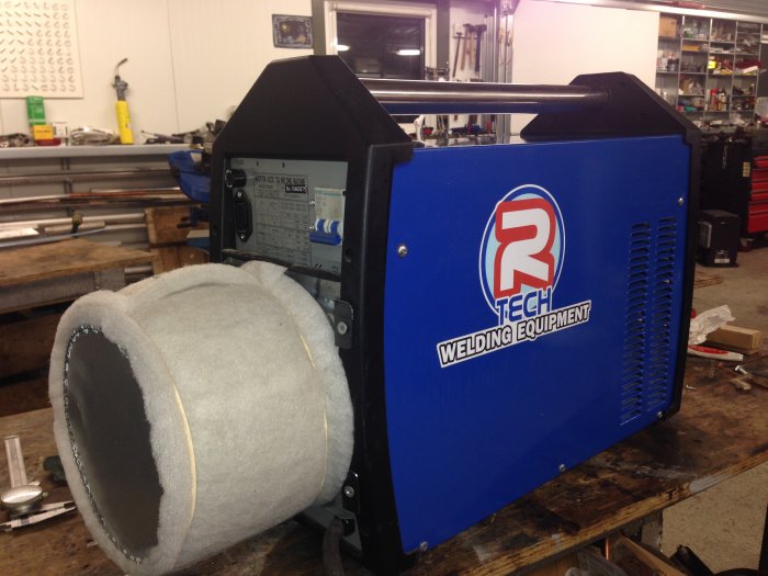

I have a 250i AC/DC welder, its a good machine.
one of its draw back is the noise, any more than a 1/2hr running and I am fit to throw something at it.

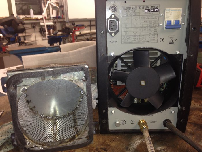

while I was stripping the end panels off to see about fitting an air filter to it i noticed the impeller's tip was blanked off by about 30%.
So I sniped off the obstruction and proceeded to make a large filter.
I suppose I made big to try and help with sound attenuation, I might make it smaller.
I think its not as noisy, what do you think?
