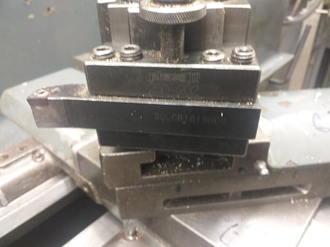

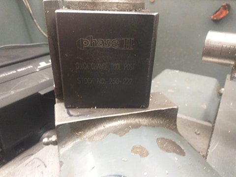

    The tool post was given to me with a few tool holders
    I have a few Banggood holders that are fine
    Also made a few my self
    I have cut dove tails in big lathe tools and mount these directly to the post
    I have a smaller tool post "kit " coming from Banggood to do a review on for my Super 7 lathe
    This is the wedge type as well
    NickMc and fizzy like this.
