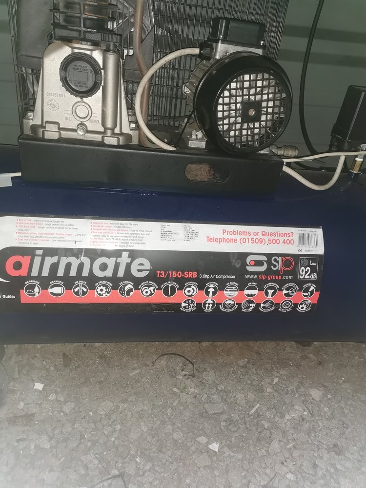

500e Always buy fire insurance a flood is a hard start Messages 9,220 Location South West Feb 22, 2023 #1 Which way should it rotate viewed from drive end of motor/comressor
Barking Mat Cuddler of hedgehogs. Messages 13,454 Location France, Brittany. Feb 22, 2023 #2 Well 50/50, I'll go for clockwise, but seeing as it's viewed from the wrong end of a motor, I'll hedge my bets and go anti clockwise too. Try it and see.
500e Always buy fire insurance a flood is a hard start Messages 9,220 Location South West Feb 22, 2023 #3 Hate running things wrong way, I think AClock as well Some one here will have one
Seadog Save the planet. It's the only one with rum! Messages 12,846 Location NE London - UK Feb 22, 2023 #4 The compressor will work in either direction. It's a two-stroke. It's all about the cooling fan.

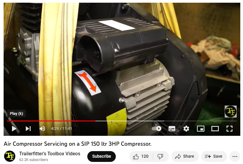

T689 Member Messages 161 Location Devon, UK Feb 23, 2023 #12 Found this youtube video for the same compressor, I spotted the sticker for direction of motor which may help you!

K knighty Member Messages 3,479 Location Sunderland Feb 23, 2023 #13 looking at the fan blade it needs to go clockwise from where we're sitting so the top of the belt needs to move towards the motor, around the motor pully and back along the bottom

500e Always buy fire insurance a flood is a hard start Messages 9,220 Location South West Feb 23, 2023 #14 Thanks @T689 and @knighty It was going wrong way thought so, did not think of you tube
T Turbo Member Messages 7,356 Location Fermanagh, Northern Ireland Feb 23, 2023 #15 Checked my similar SIP & IR compressors & both spin clockwise looking from the pump body side.
